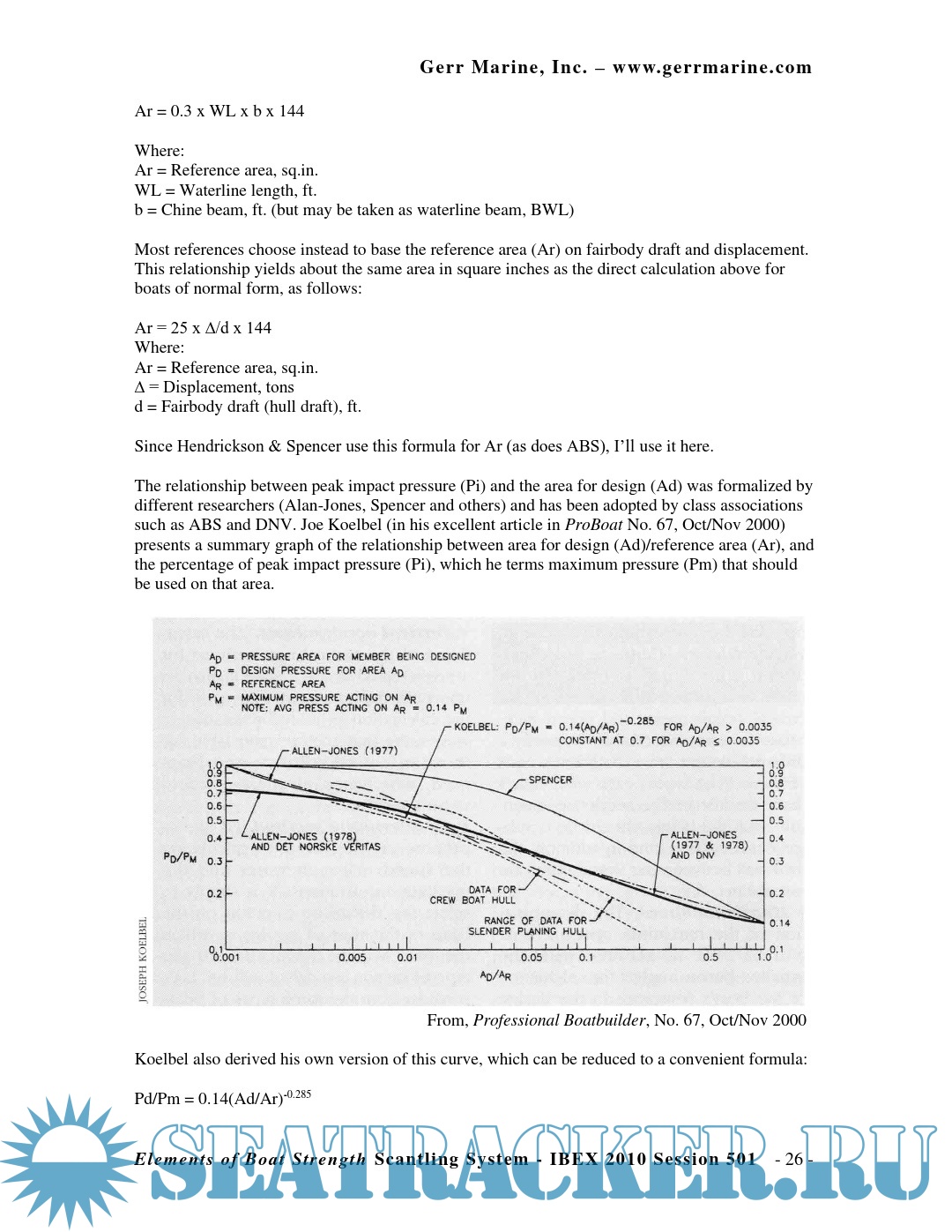

Description: It has been over 10 years since The Elements of Boat Strength was published in 2000. In all that time and all the many, many boats built to this rule, I have yet to learn of a single structural failure.
That’s a pretty good record. As The Elements of Boat Strength scantling system now has a ten-year history of successful use and is quite simple to apply, it seems a good time to review what the rule is, how it came to be, how it should be applied and how it relates to a few other scantlings. We’ll also look at some of the things I’d adjust in The Elements of Boat Strength scantling system.
Since almost everything in this system references the “scantling number” (Sn), I’ll refer to it as the “Sn scantling system,” “Sn system or rule,” or the “Sn process.” Also—as I’ll explain—I have used aspects of this basic system for years before the book’s publication.
