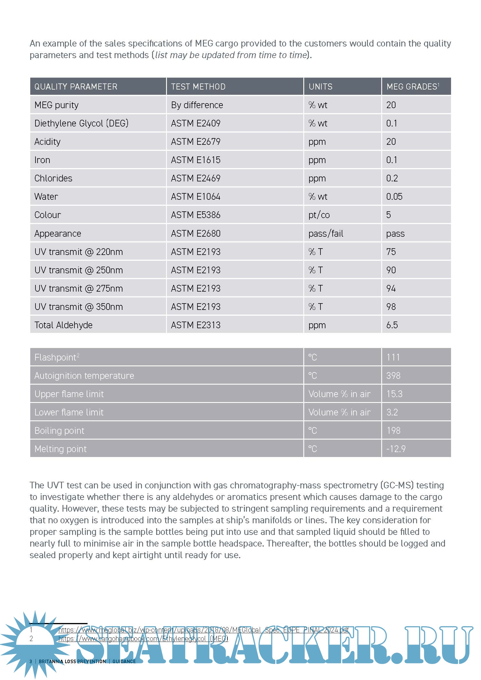

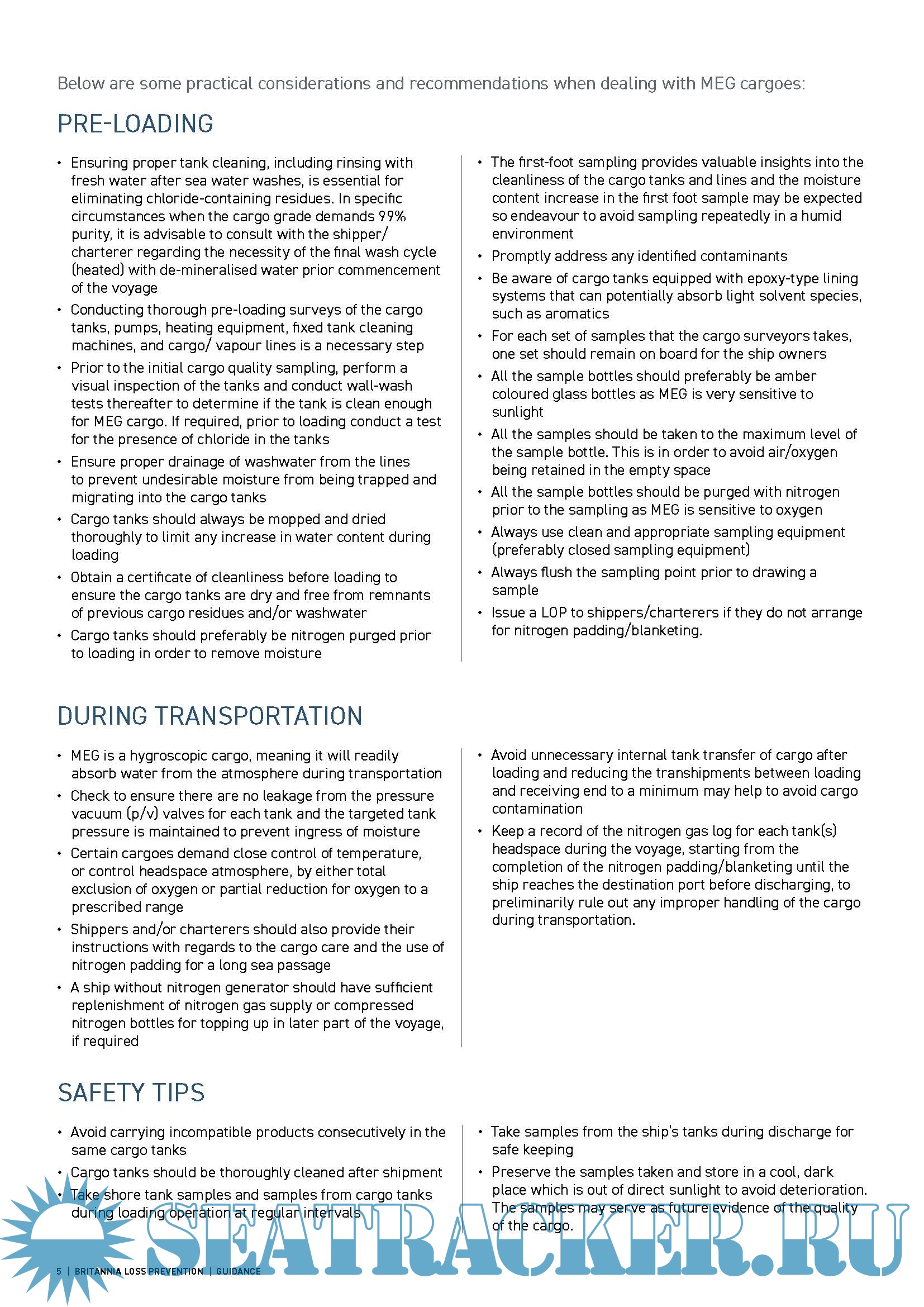

Safe Handling of Mono Ethylene Glycol (MEG)
Year: 2024
Author: Britannia P&I Club
Edition: October 2024
Pages count: 6
Description: Britannia Loss Prevention Guidance - Safe Handling of Mono Ethylene Glycol (MEG).
It is widely used as an ingredient for production of polyethylene terephthalate (PET) resins, fibres, films or antifreeze and coolants. This article aims to highlight the importance of understanding the intricacies of MEG and some of the safety considerations for its transportation.
It’s important to note that this guidance offers high-level, generic information and shouldnot be considered exhaustive.
