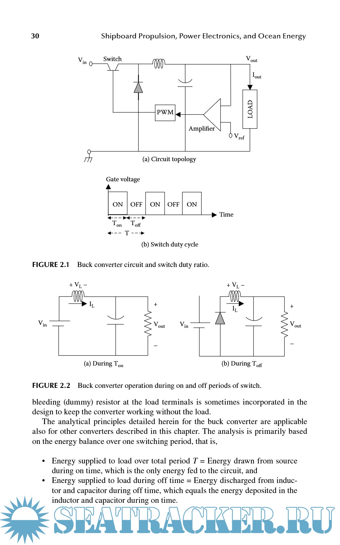

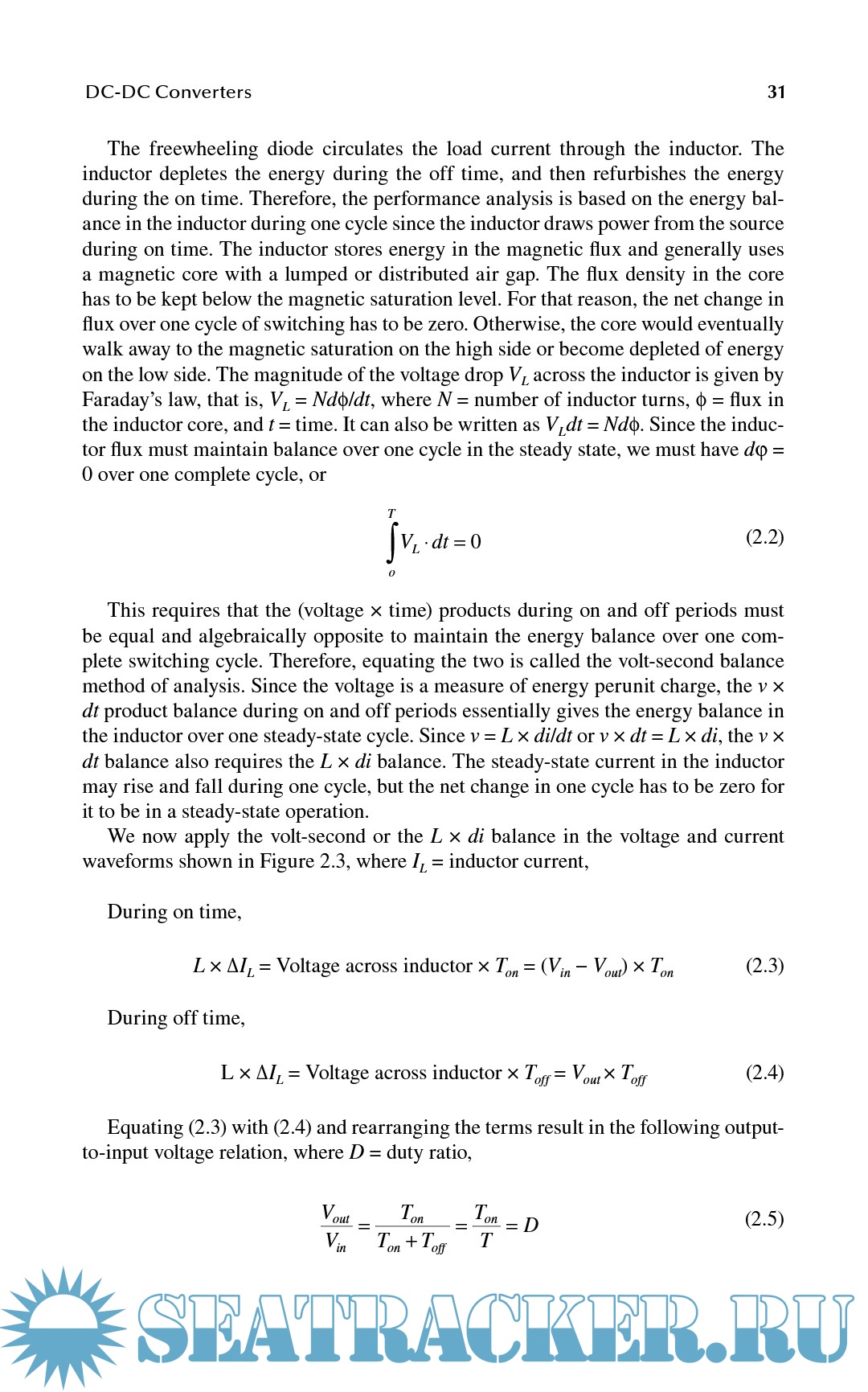

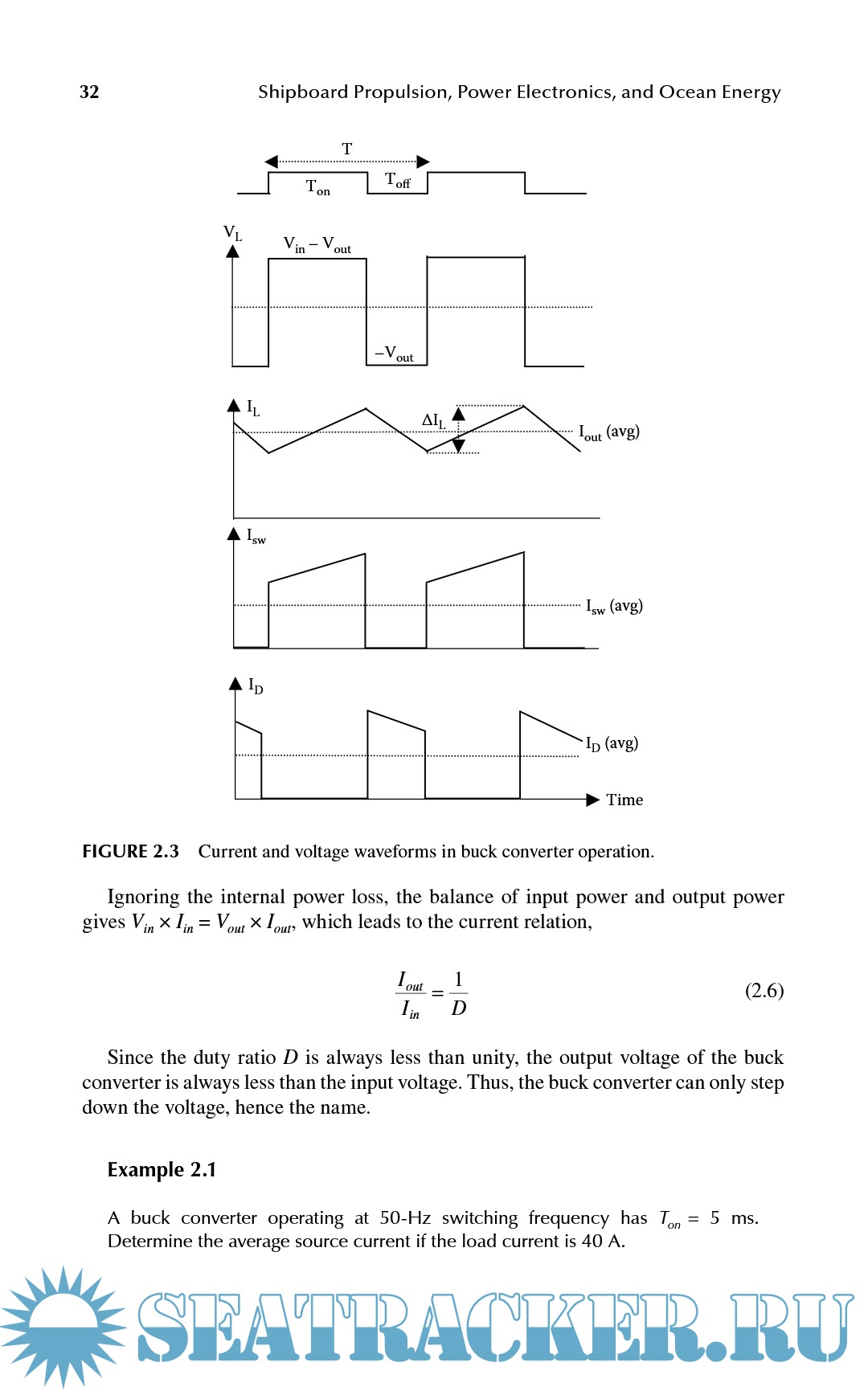

Chapter 2 DC-DC Converters ................................. 29
2.1 Buck Converter ........................................ 29

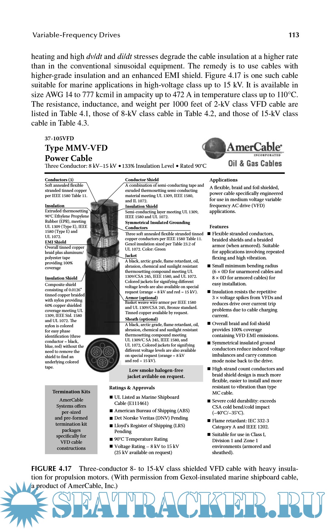

4.10 Special VFD Cables ................................... 111

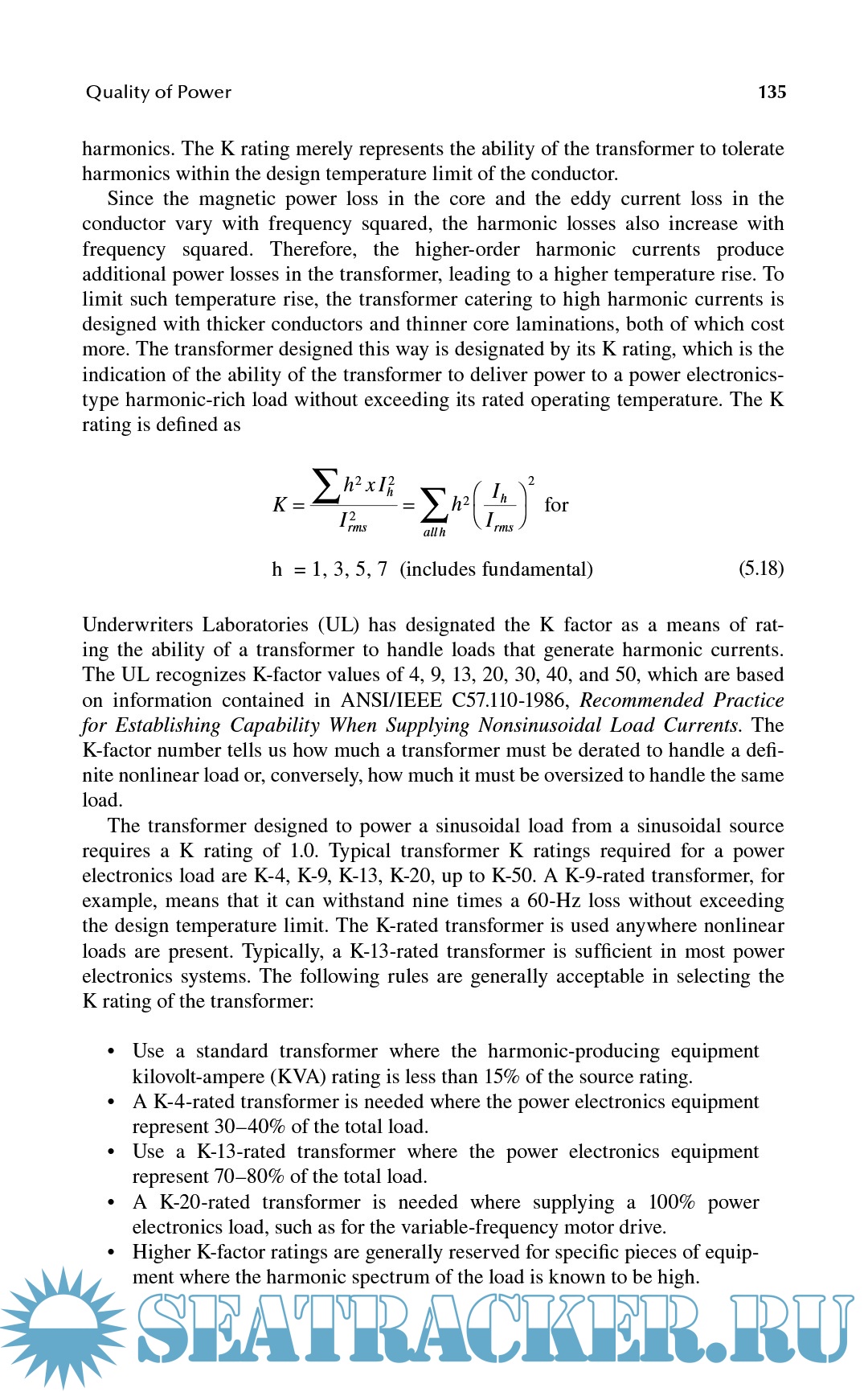

Chapter 5 Quality of Power ................................. 123
5.1 Power Quality Terminology ............................. 123
5.2 Electrical Bus Model .................................. 125
5.3 Harmonics ............................................. 128
5.4 Power Quality Studies ................................. 140
5.5 Harmonic Reduction .................................... 141
5.6 IEEE Standard 519 ..................................... 151
