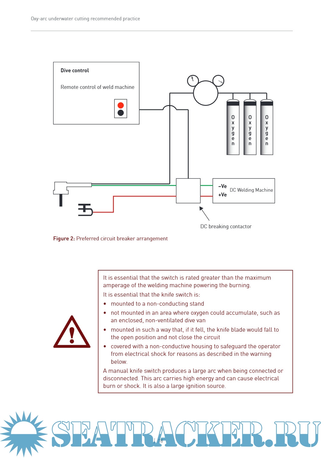

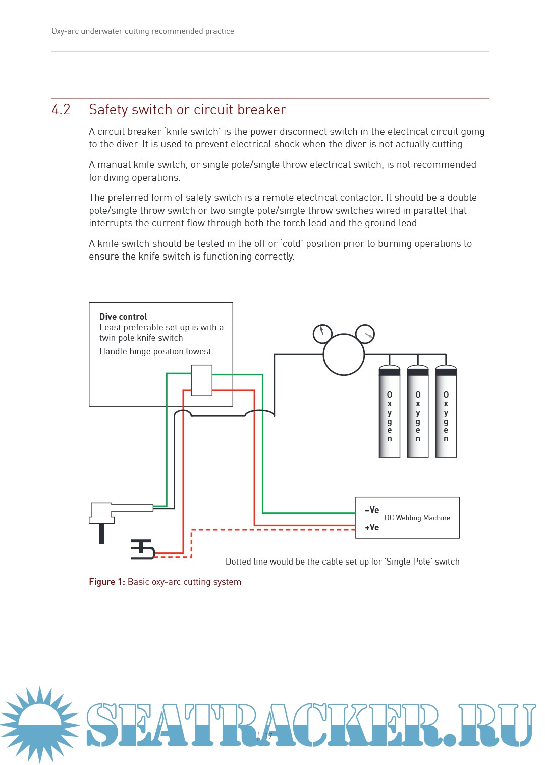

4.2 Safety switch or circuit breaker 17

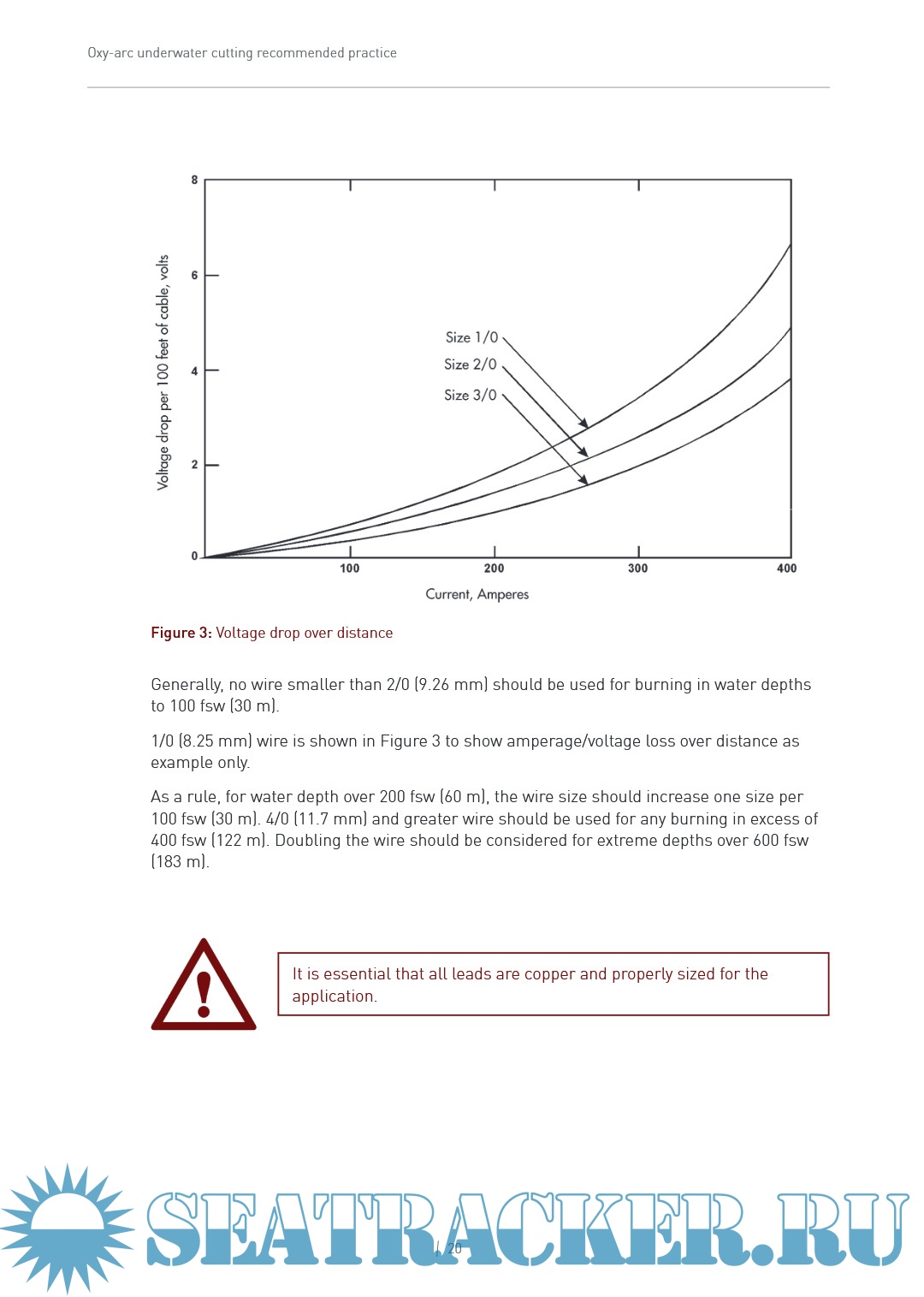

4.3 Burning leads or burning umbilical 19
