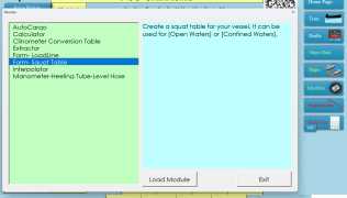

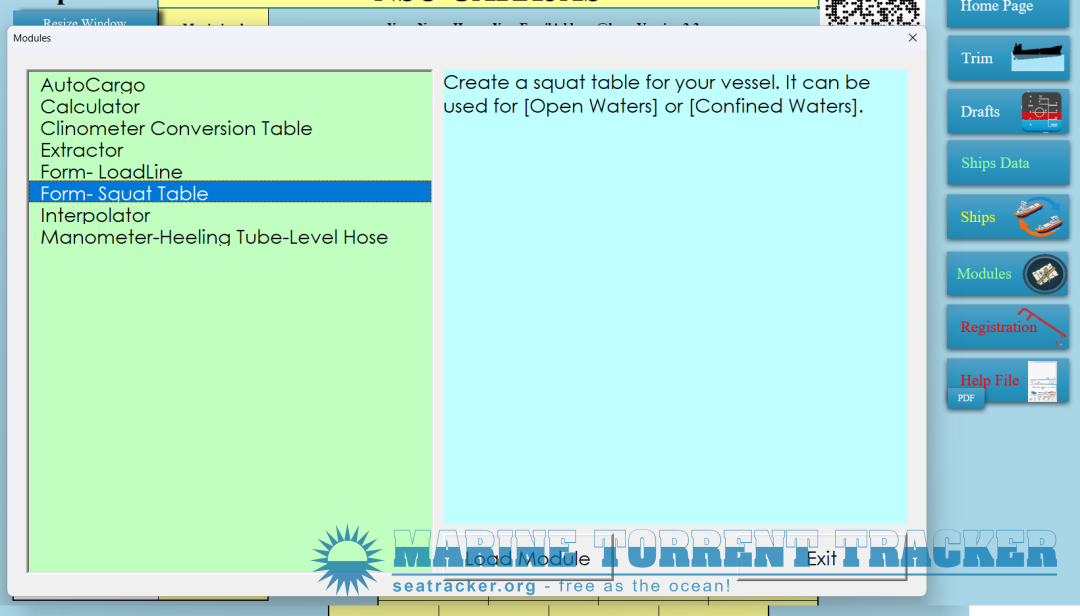

JayE_LOwe ®   Today 07:22
Click on [Modules] Button to access the features such as squat table etc.
