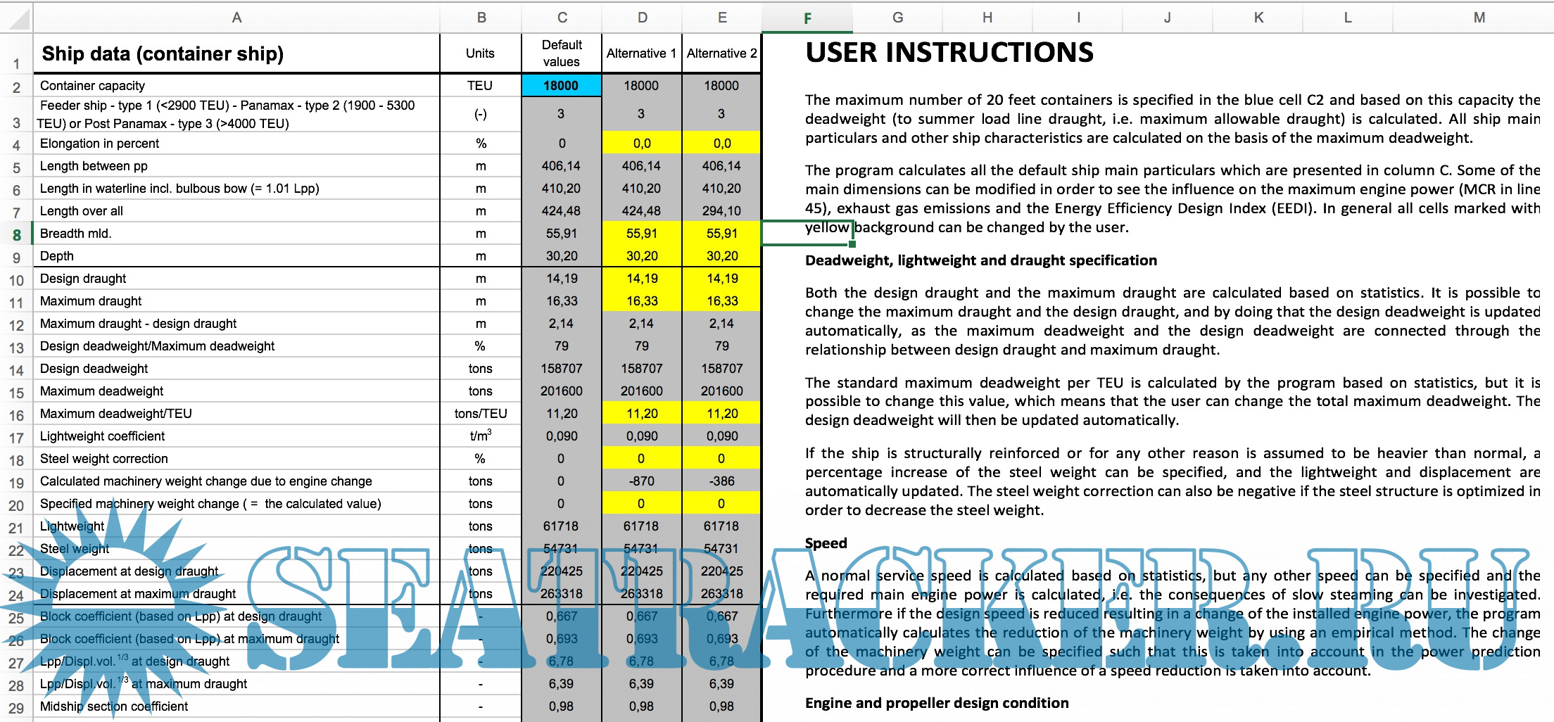

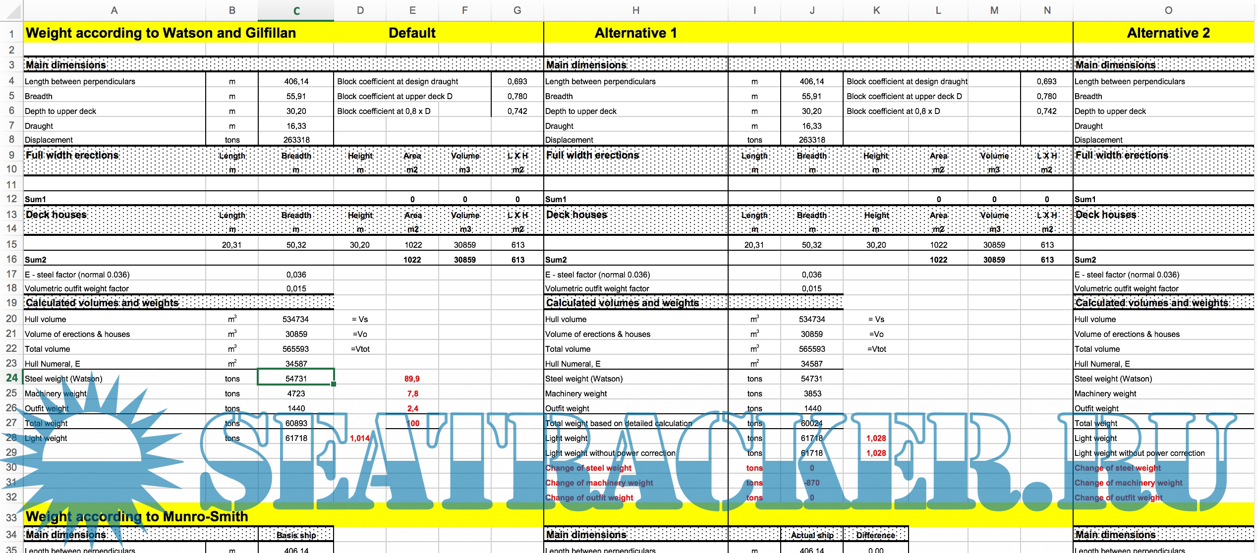

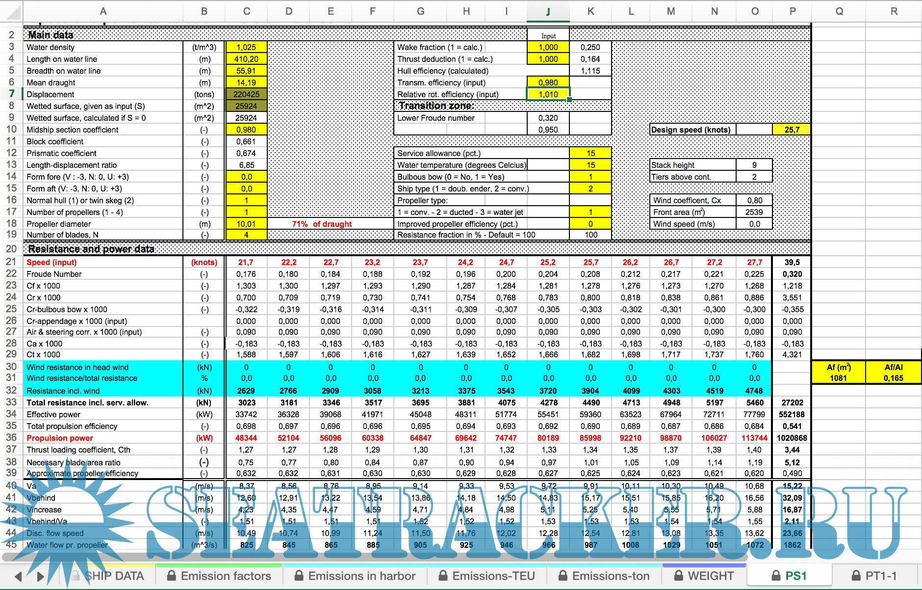

EXCEL Calculation tool for assessment of ships' energy consumption and fuel gas emissions, including CO2 (EEDI)
Year: 2016
Developer: University of Southern Denmark
Platform: Windows / MacOS / Linux
System Requirements: Microsoft Office 2003 and higher
Localization: english
Description: The tool, which can be used for existing ships as well as newbuilds, is made in three versions: for container ships, for bulk carriers and for tankers.
The tool is intended for shipowners, naval architects and others in the industry and may be used for analysing CO2- and other emissions from ships, e.g. with a view to adhering to the IMO’s limit values for energy efficiency (EEDI), which took effect on January 1 2013.

Simply by inserting a ship’s payload capacity, rate of utilisation and speed, the model of calculation will return an approximate figure for CO2-emission, energy consumption as well as determine other emission products. The calculation can be made even more precise by inserting a number of parametres such as engine- and fuel types and employment of various technical measures for reduction of fuel gas emissions, primarily NOx (nitrogen oxides) and SOx (sulphur oxides).
