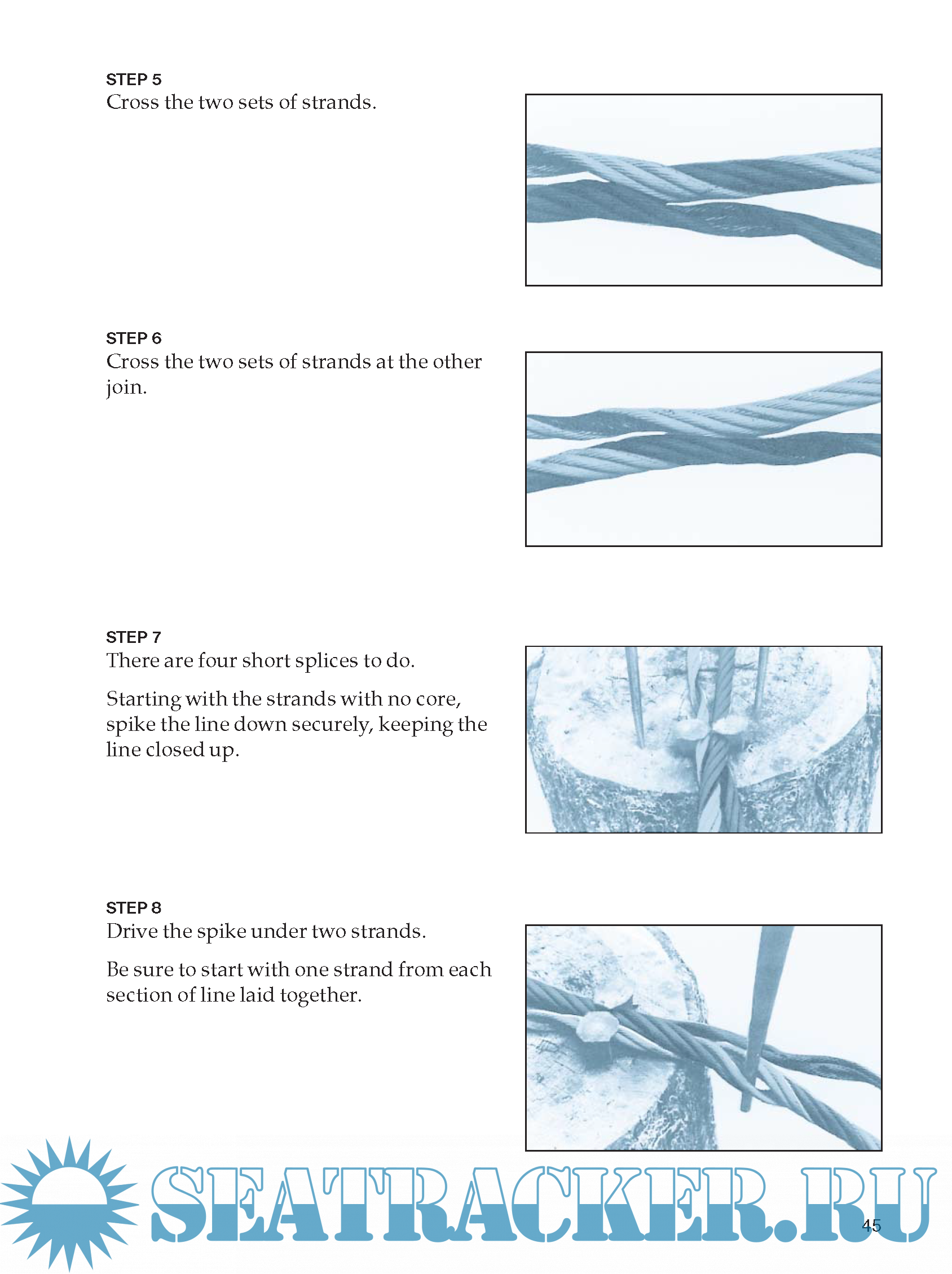

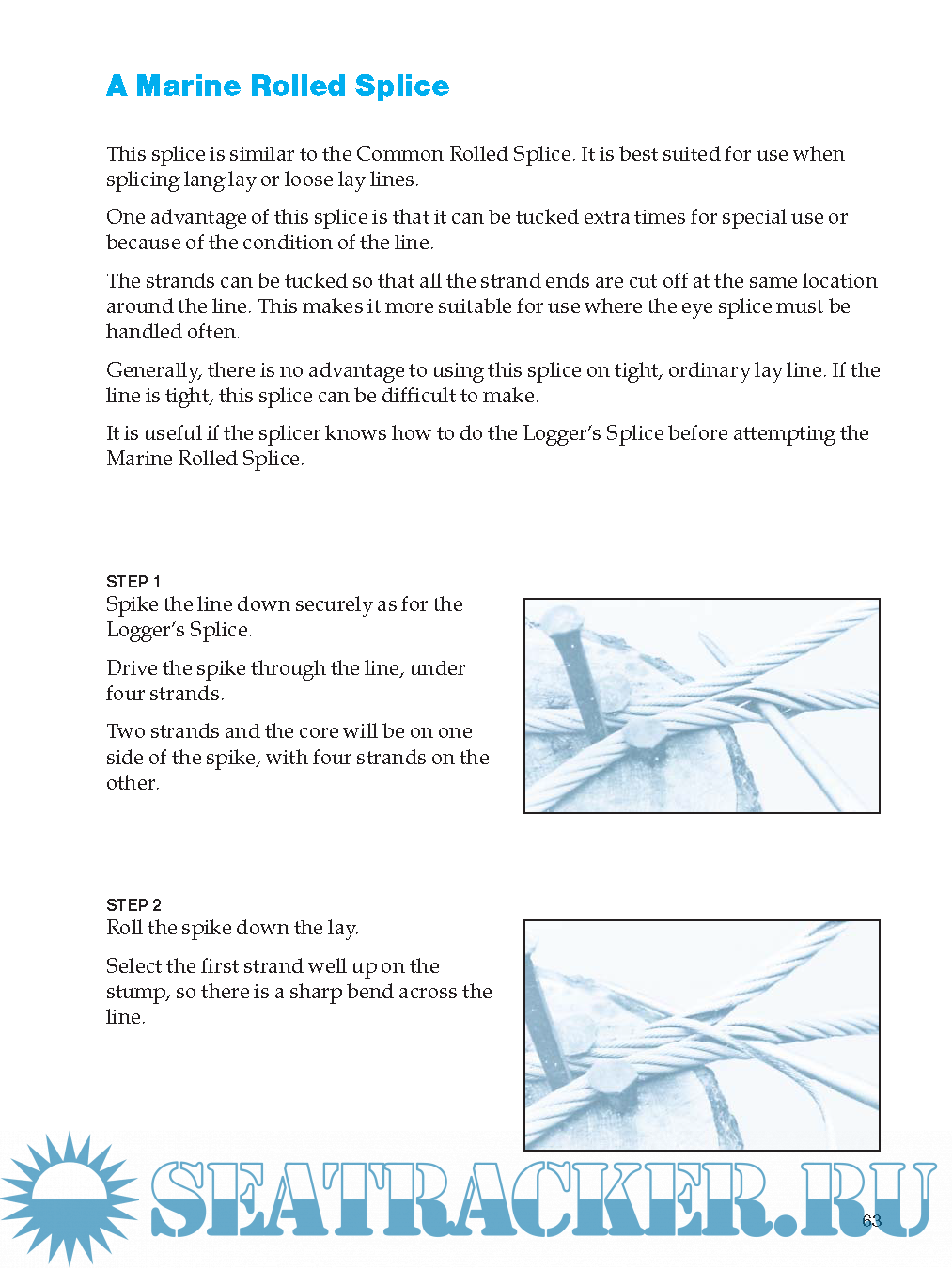

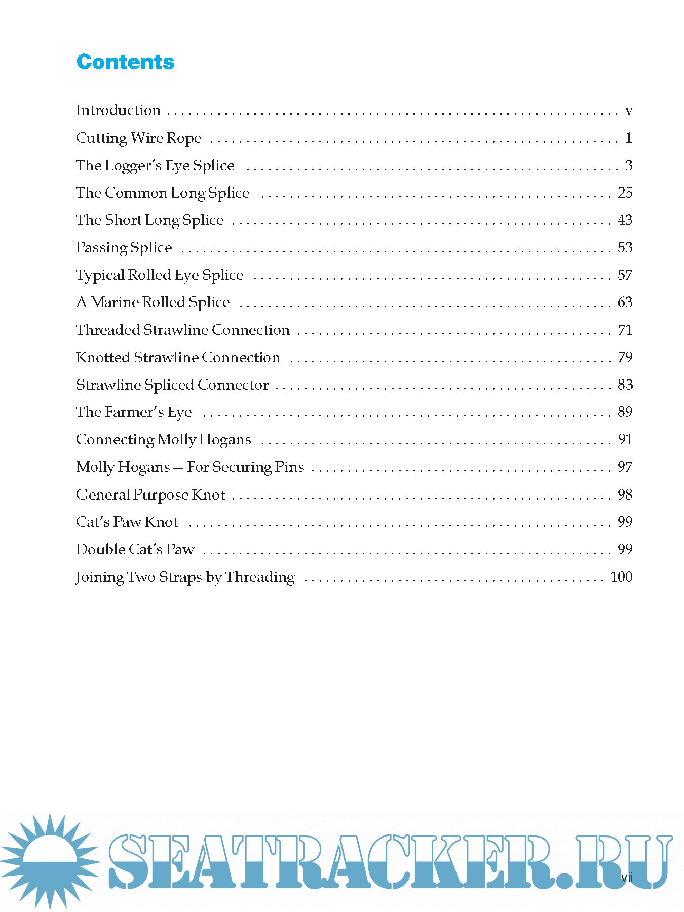

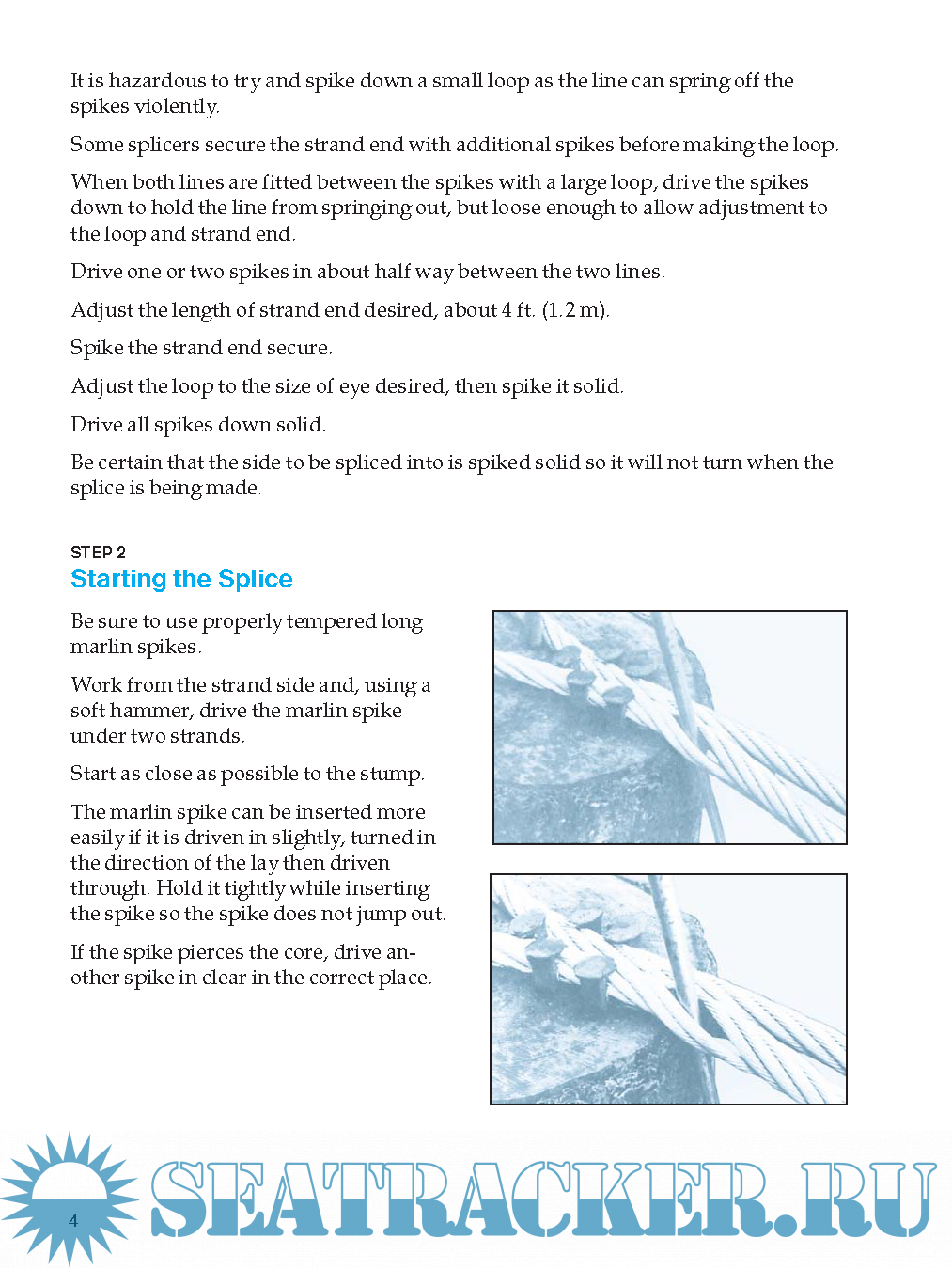

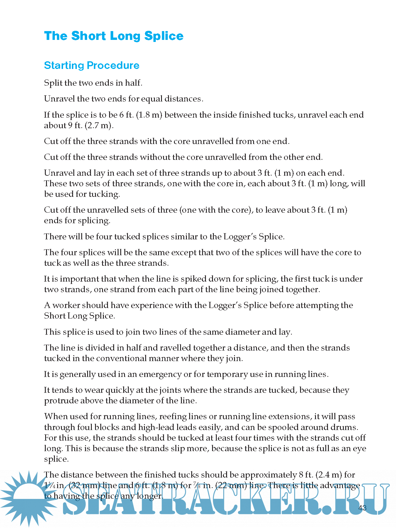

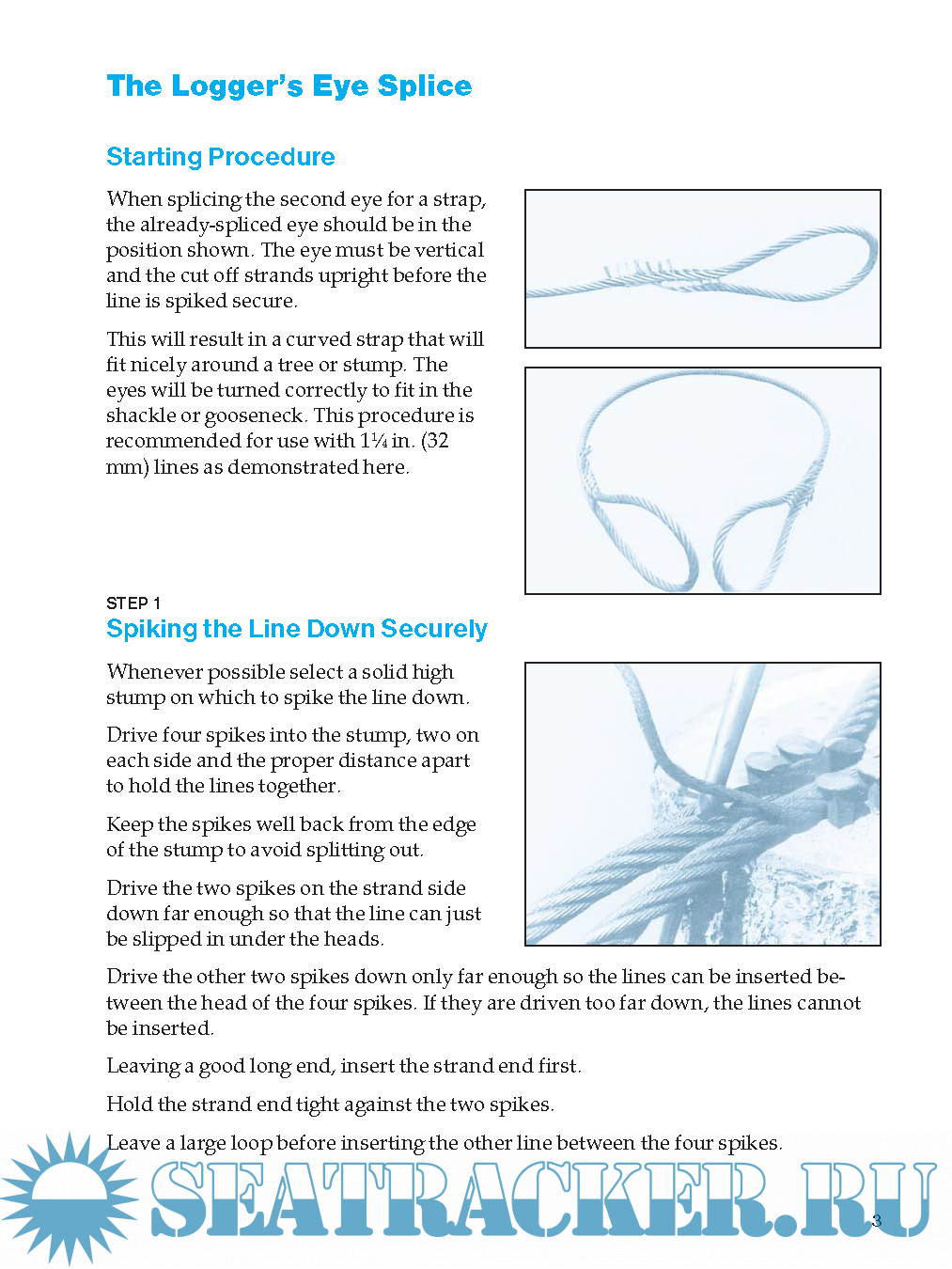

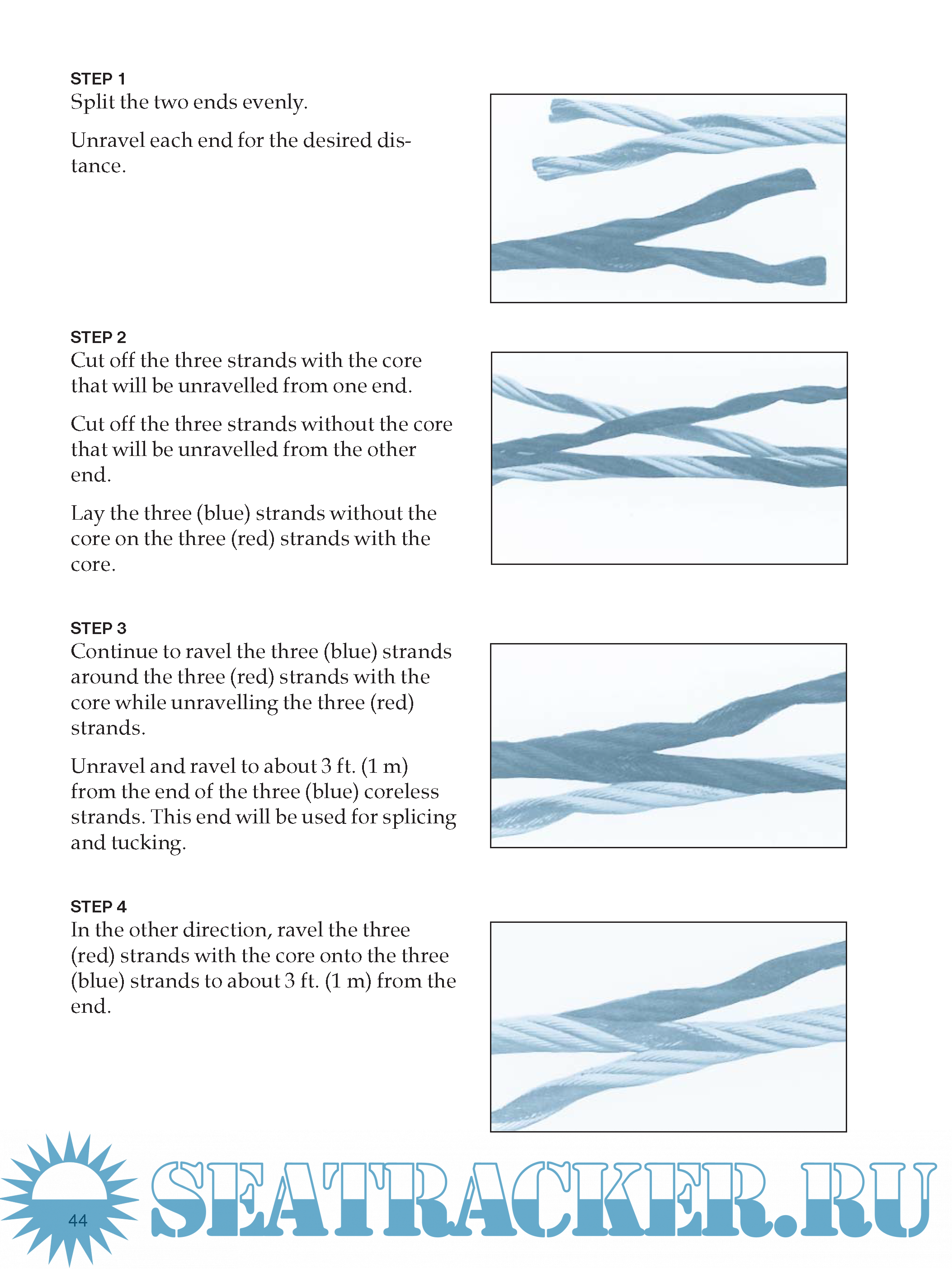

Description: This manual contains simple how-to instructions for splicing on cable yarding systems. It also features information on creating the various splicing connections you need, along with special connections, such as Molly Hogans. Other subjects covered include special knots, general purpose knots, and threading procedures.
Use this manual as a training tool for the new worker and as a reference guideline for the experienced splicer. Proper splicing techniques are critical for the safety of all workers who work around cable yarding systems. Improper splicing techniques will cause line failure that may result in potentially tragic results for workers.
