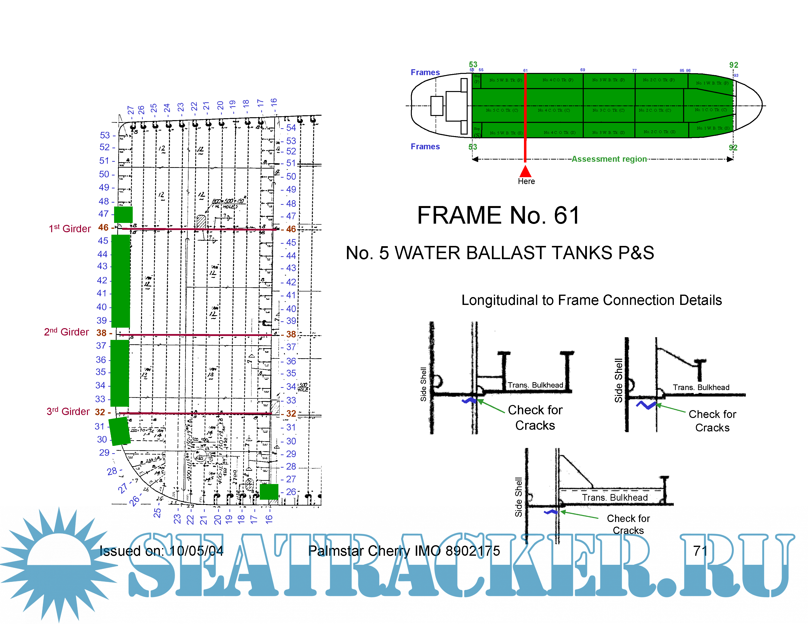

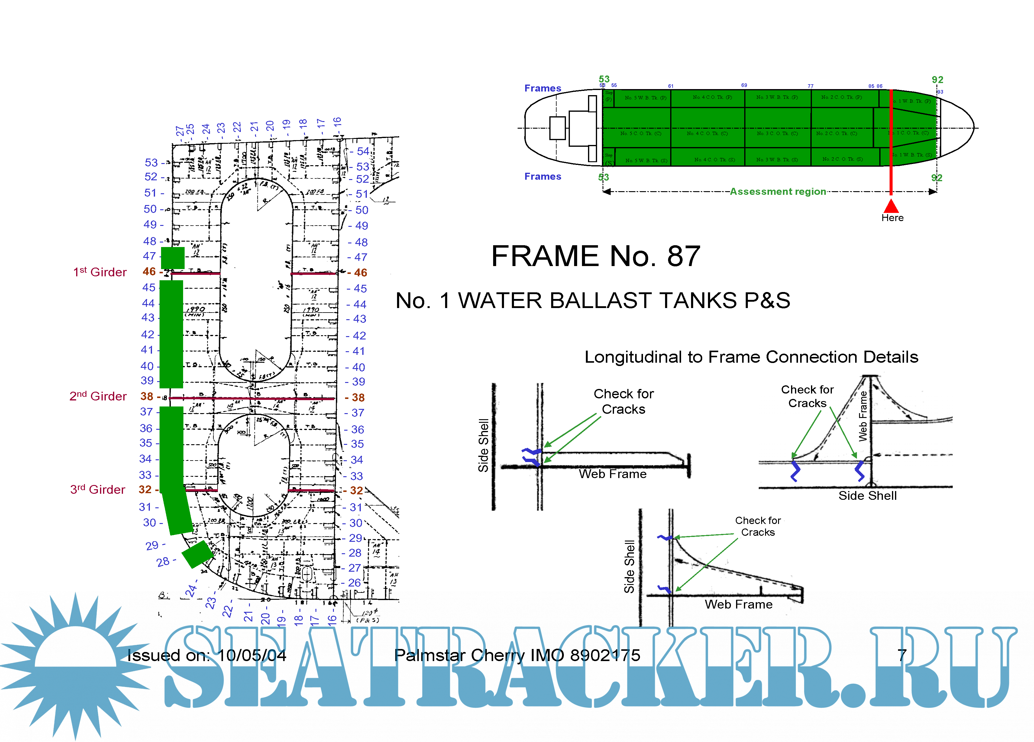

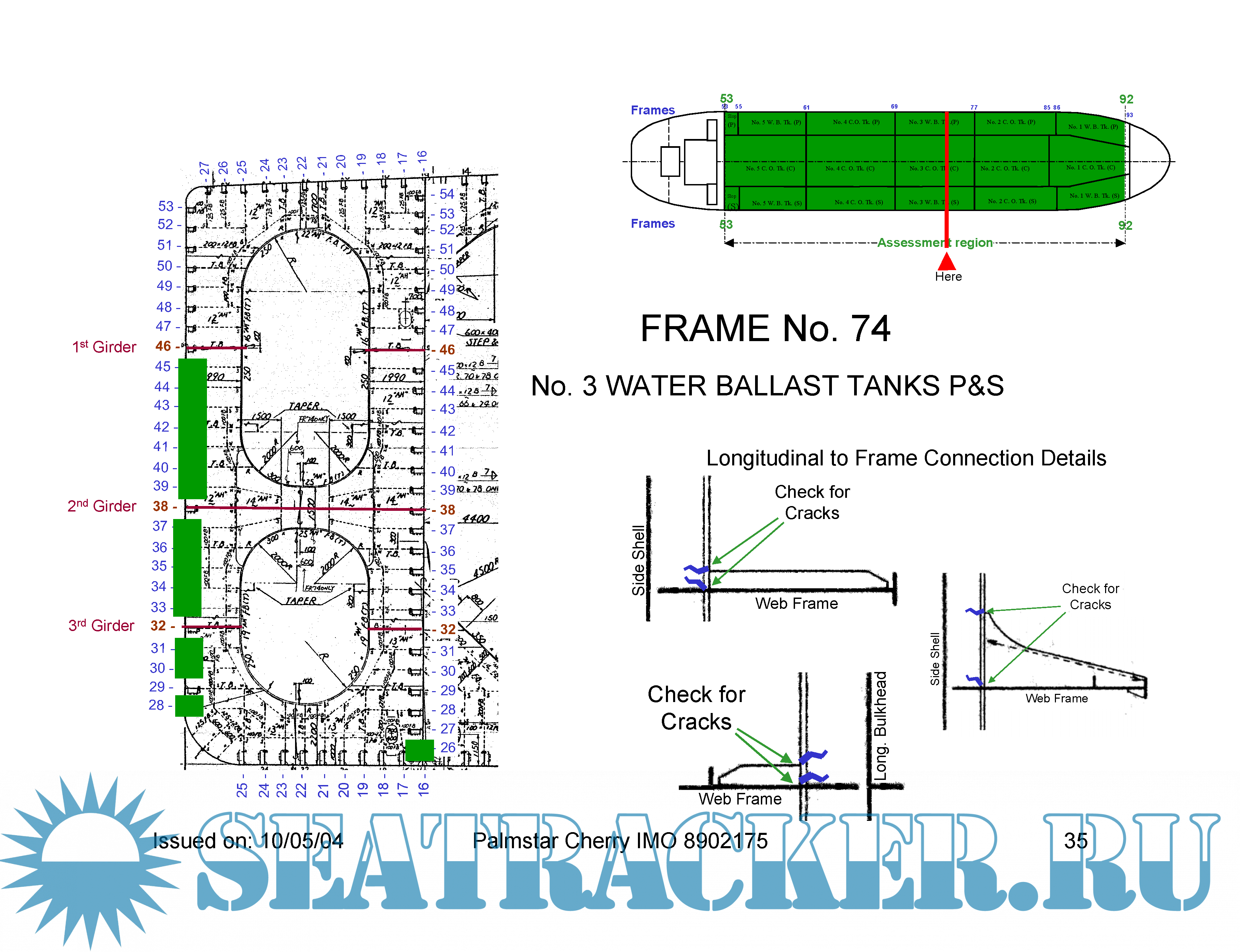

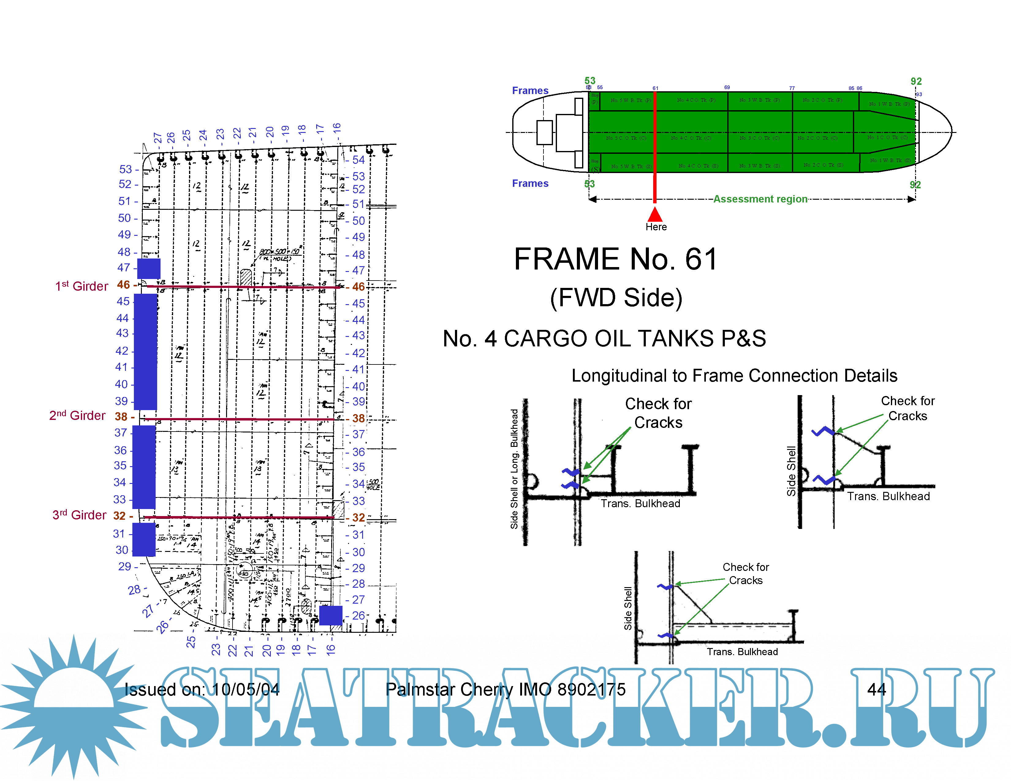

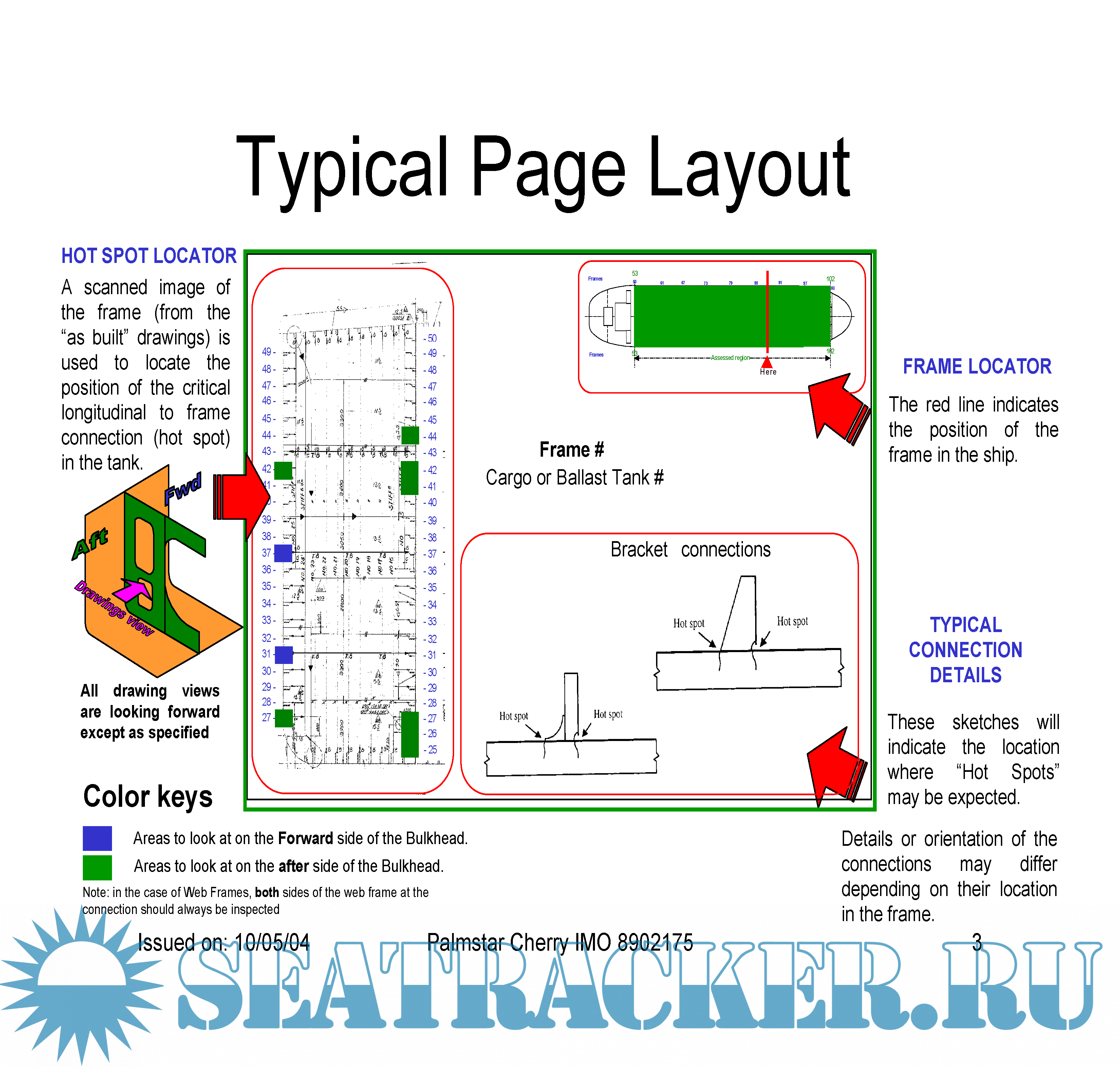

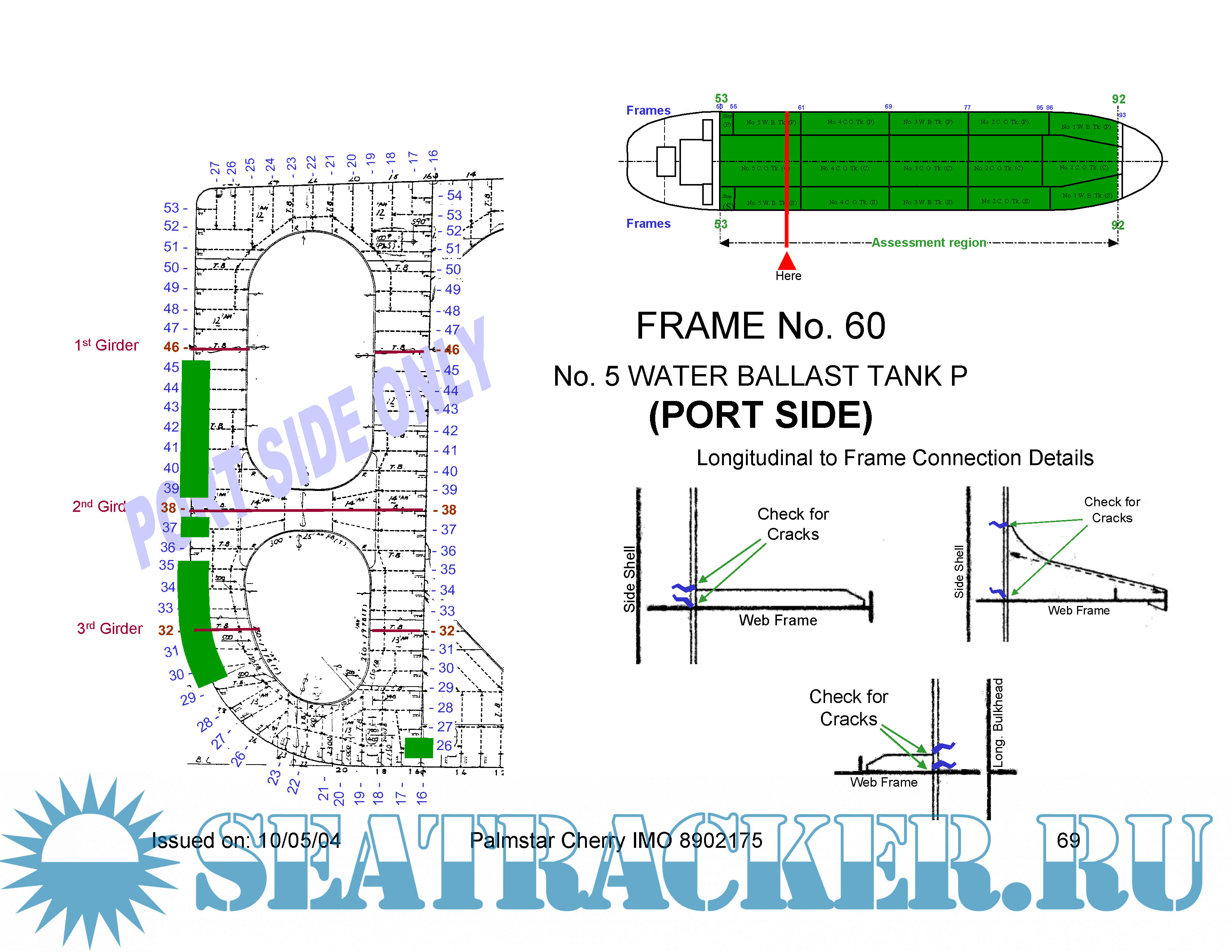

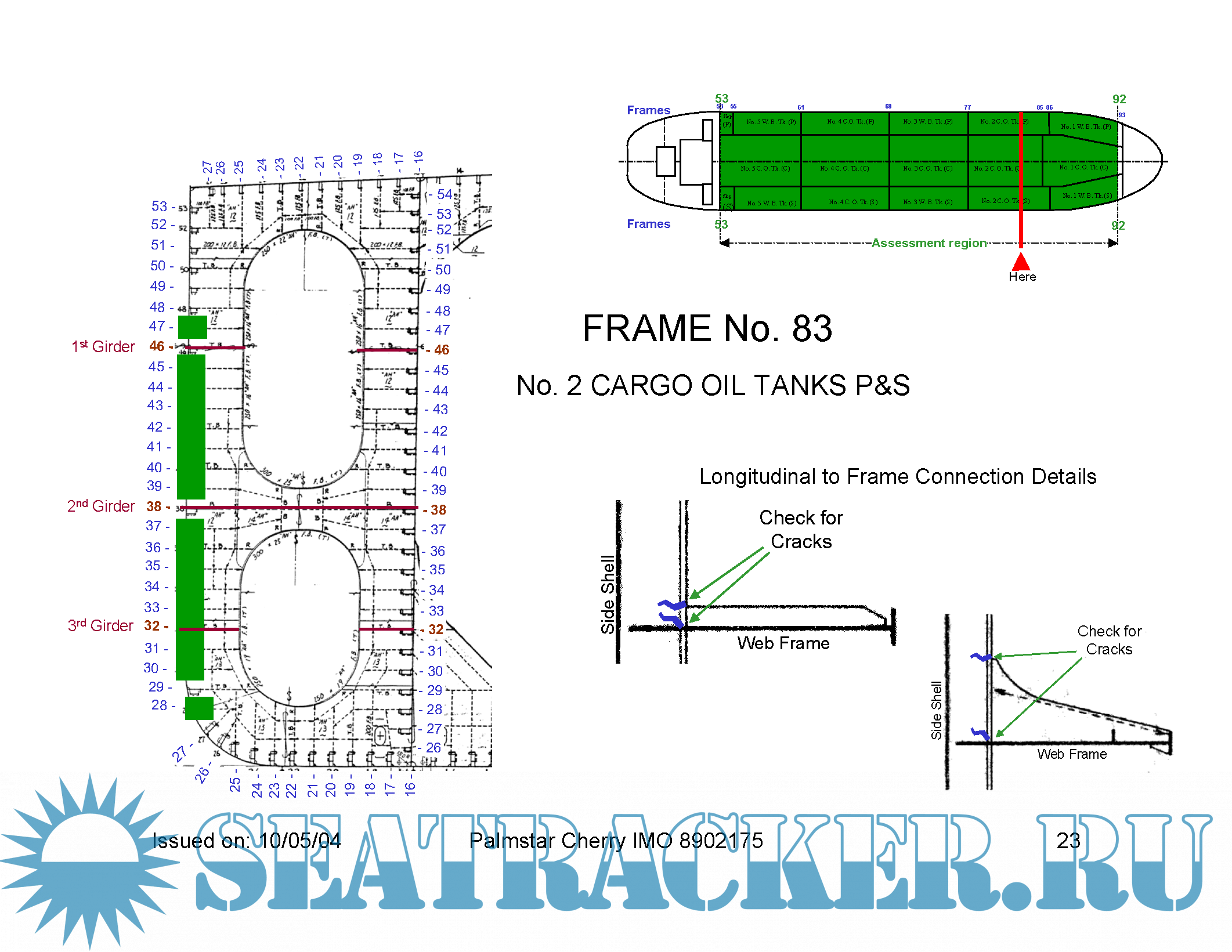

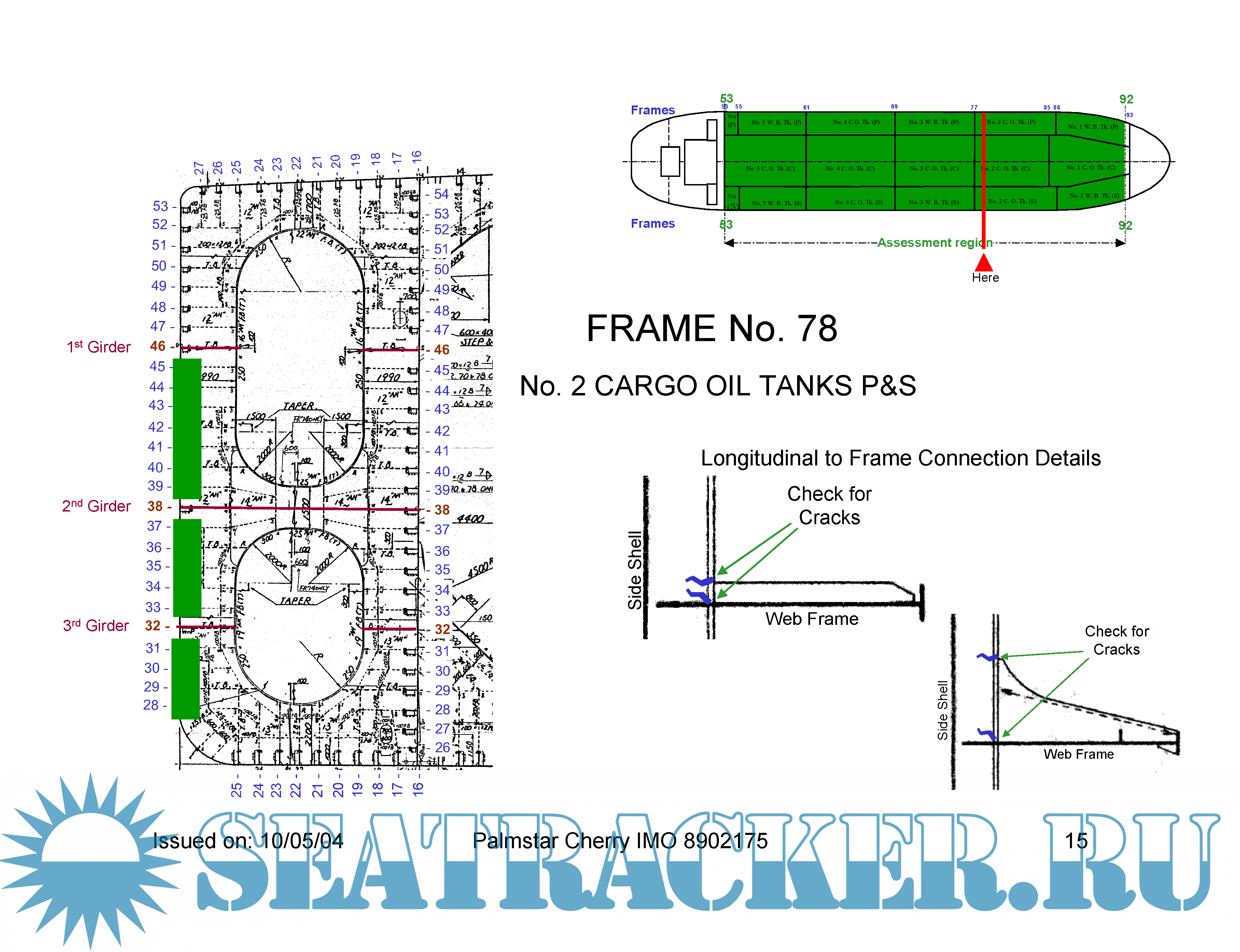

Tekay M.T. “Palmstar Cherry”: Drawings showing areas to be specially examined during tank inspections
Year: 2004
Author: Iain Braidwood [Structural Integrity Manager of TEEKAY SHIPPING (CANADA) LTD on behalf of TEEKAY SHIPPING LIMITED]
Genre: Documentation
Publisher: TEEKAY SHIPPING (CANADA) LTD
Pages count: 71
Description: Tekay M.T. “Palmstar Cherry”: Drawings showing areas to be specially examined during tank inspections as part of Structural Integrity Program (Tank Inspections).
This drawings are prepared to help the work in the tanks showing the areas that will need to be examined carefully. These identify the connections between longitudinals, be they deck, bottom or side and transverse structure such as bulkheads or web frames.
Drawings of tanks showing the areas of M.T "Palmstar Cherry" that will need to be examined carefully.
