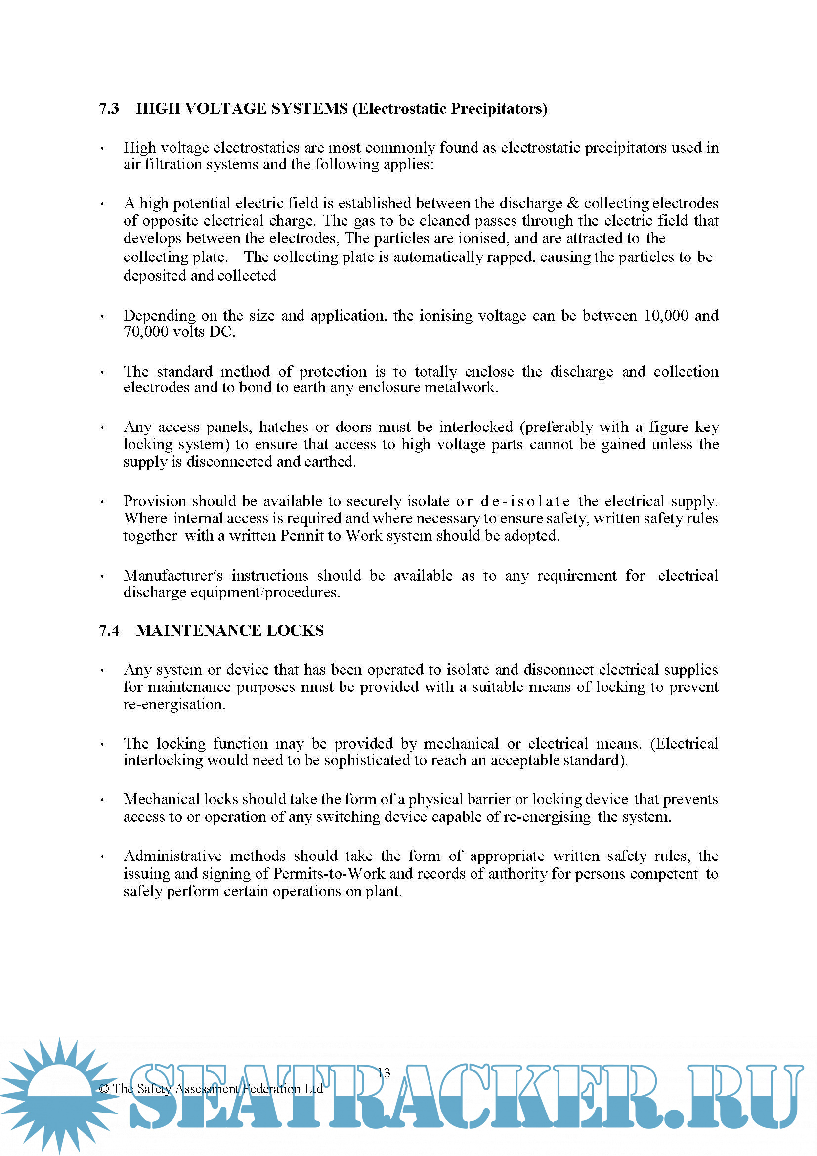

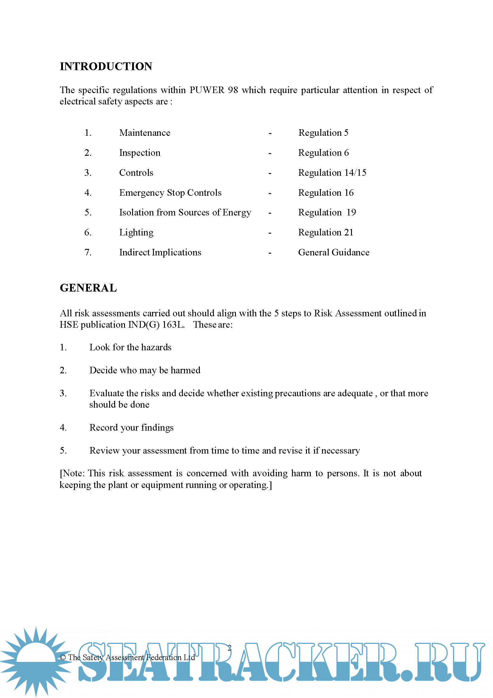

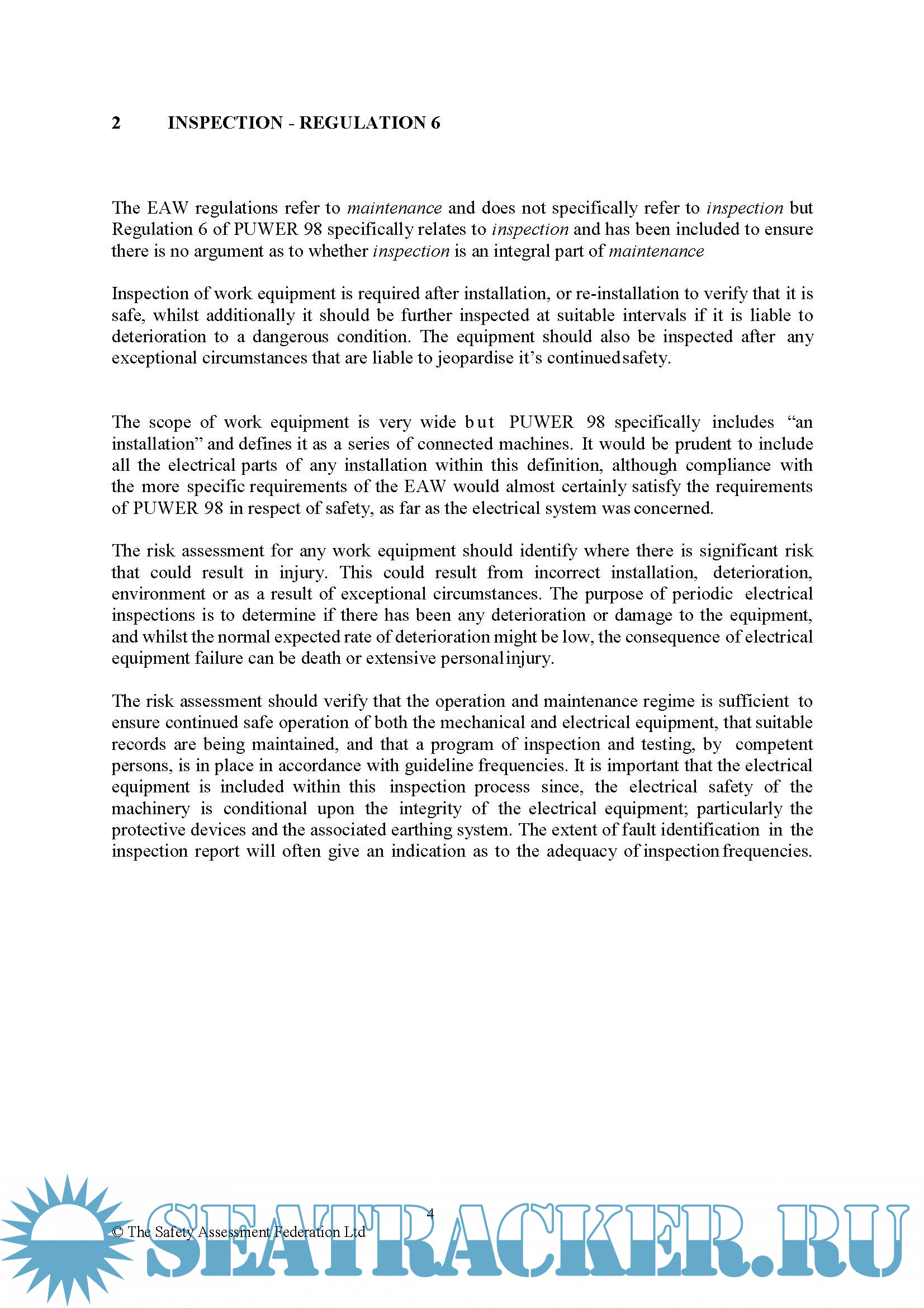

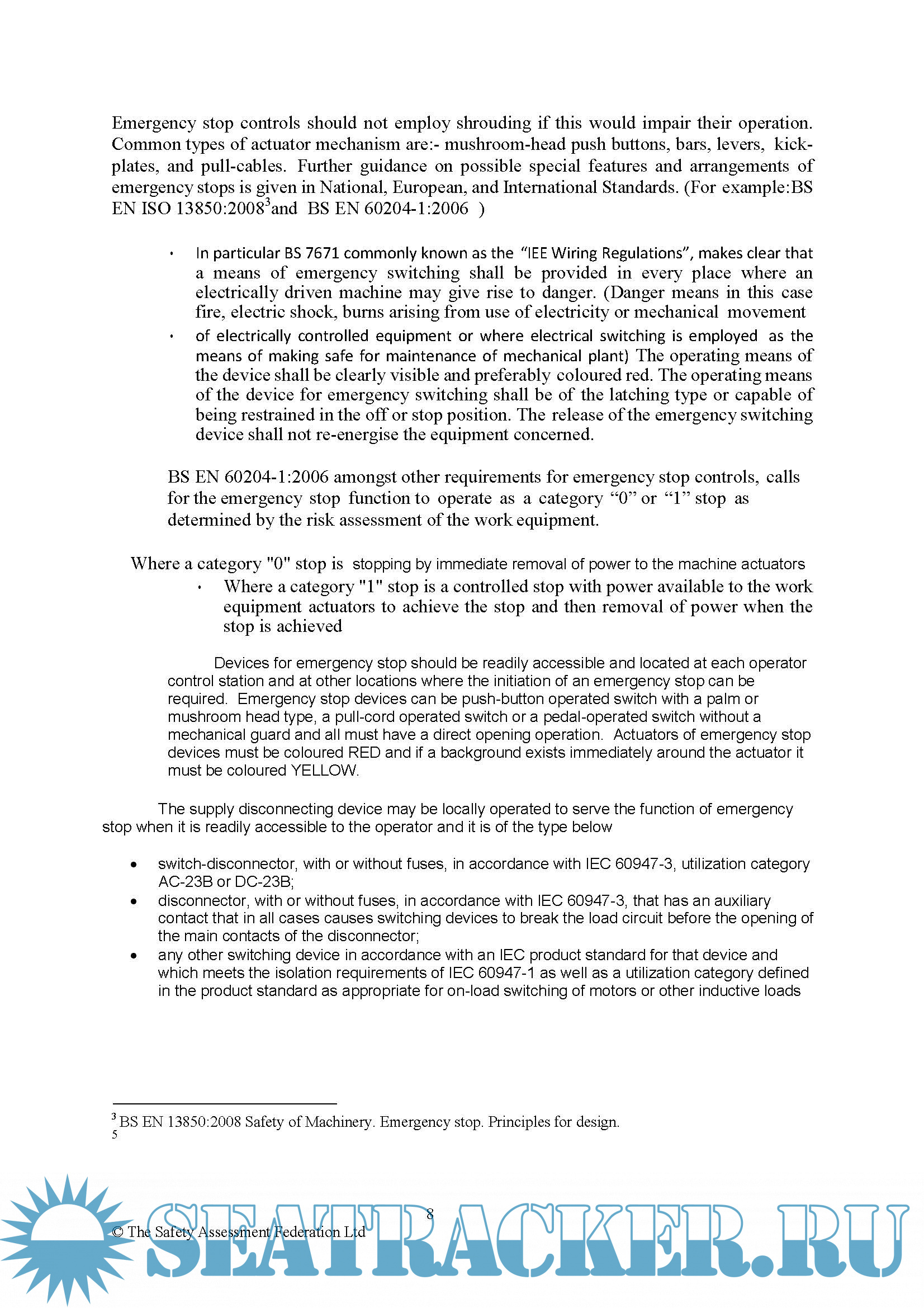

Electrical Guidelines, Risk Assessment of Work Equipment
Year: 2015
Author: The Safety Assessment Federation Ltd
Pages count: 14
Description: These Guidelines have been produced to assist in the assessment of the risks to health and safety of work equipment. They set out specific guidance on electrical issues and related matters that should be included in the assessment as to whether or not work equipment meets with the requirements of PUWER 98. Further general guidance is also given.
Because failures of electrical equipment may be sudden and have catastrophic results, the need for the use of a competent person and appropriate guidance for risk assessment is paramount.
