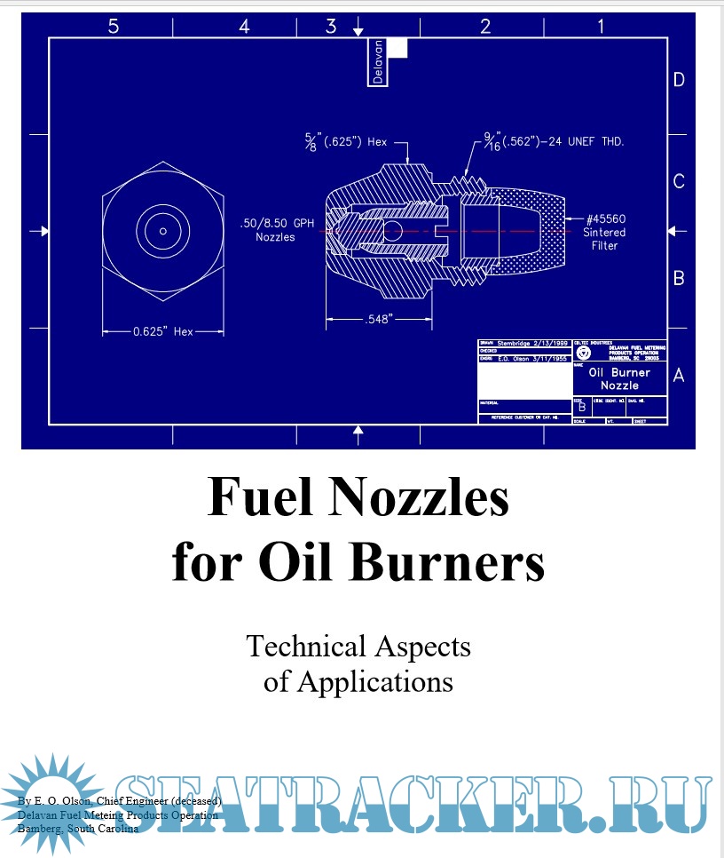

Fuel Nozzles for Oil Burner
Year: 1999
Author: O. Olson, Chief Engineer
Genre: Textbook
Publisher: O. Olson
Pages count: 11
Description: Technical Aspects of Applications
For Oil Burners
