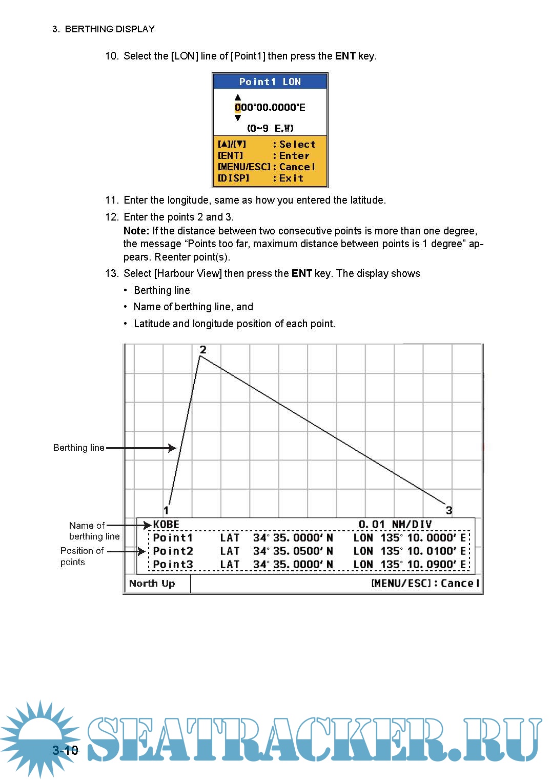

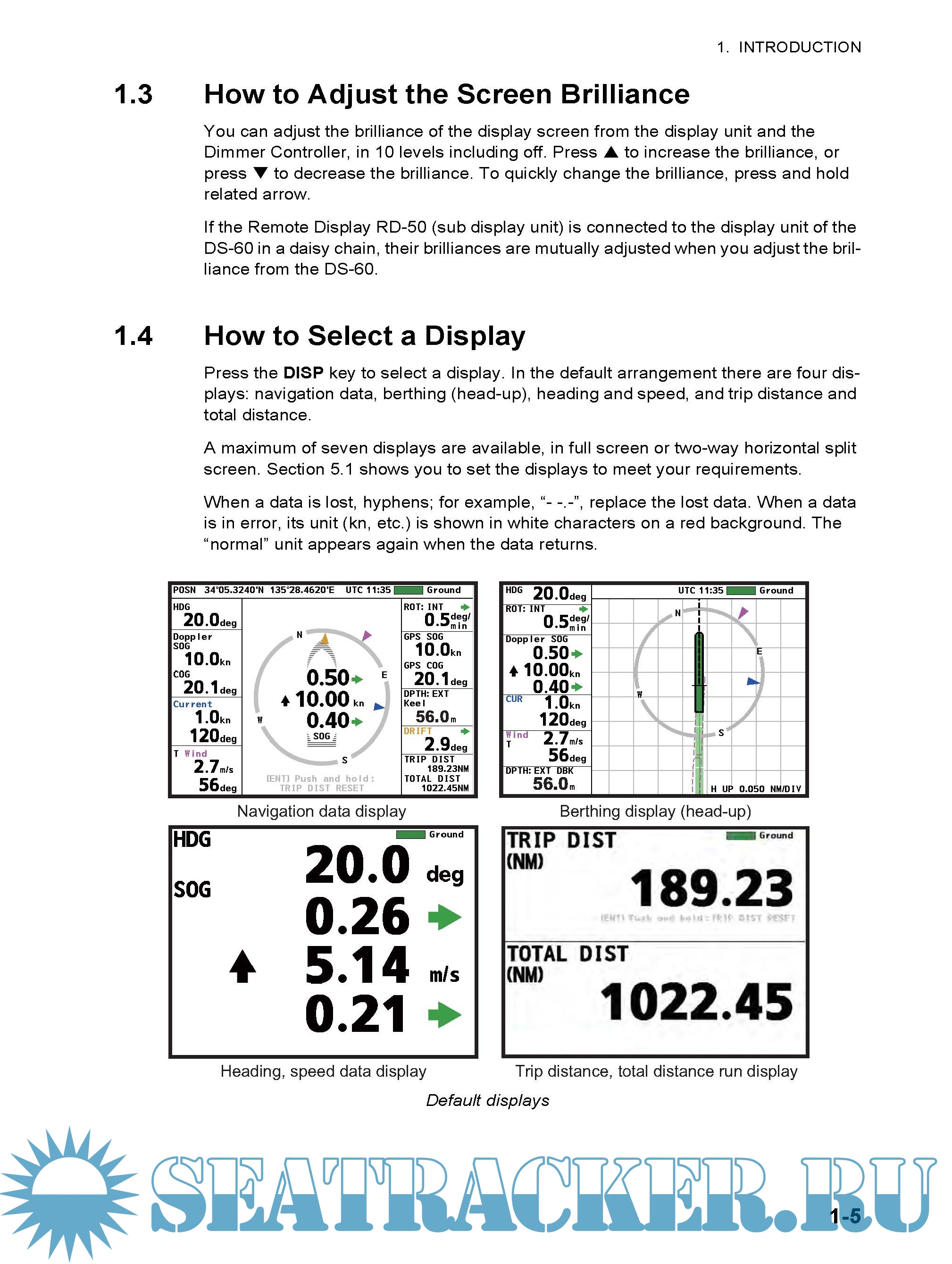

Description: The DS-60 is a high precision Doppler Sonar designed for use on VLCC, LNG, LPG, container ships, cargo ships, etc. The DS-60 measures speeds relative to ground and water in the fore, stern and transverse directions. This arrangement provides for precision docking of tankers and the like
to loading and unloading facilities, as well as safe navigation in narrow channels and straits.
• Meets the requirements of IEC 61023 Ed 3.0, IEC 60945 Ed 4th.
• Measurement accuracy of ±0.01 m/s.
• Ground tracking from 1-200 m for accurate ground speed in coastal waters.
• Sub display units (max. 5) for display on the wing, etc.
