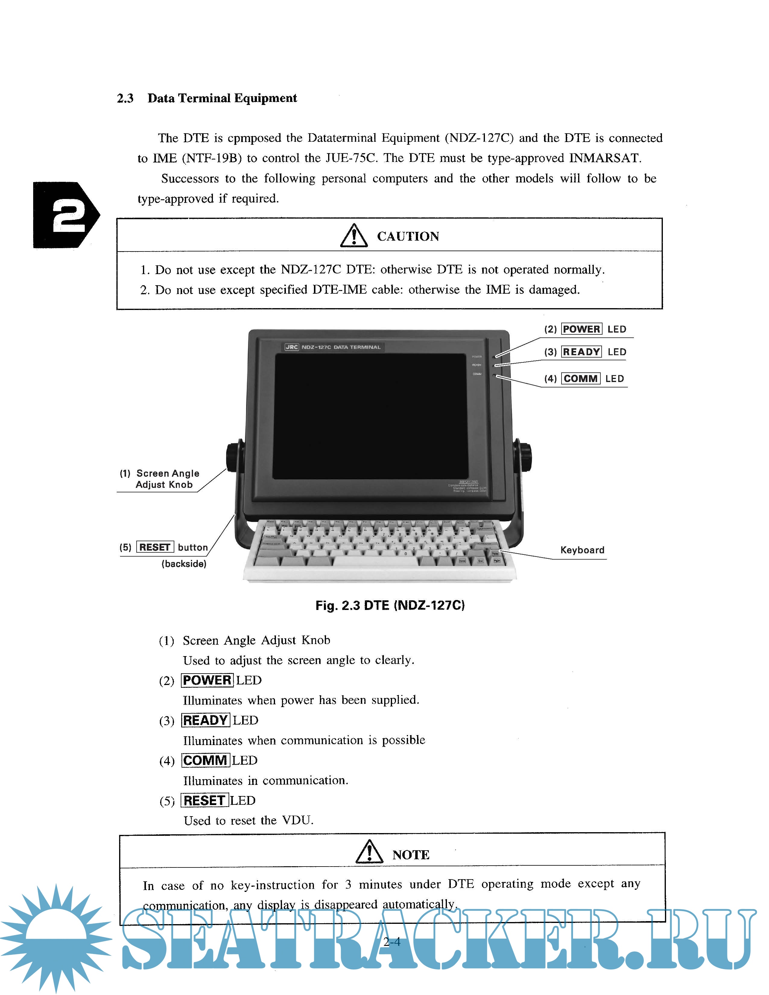

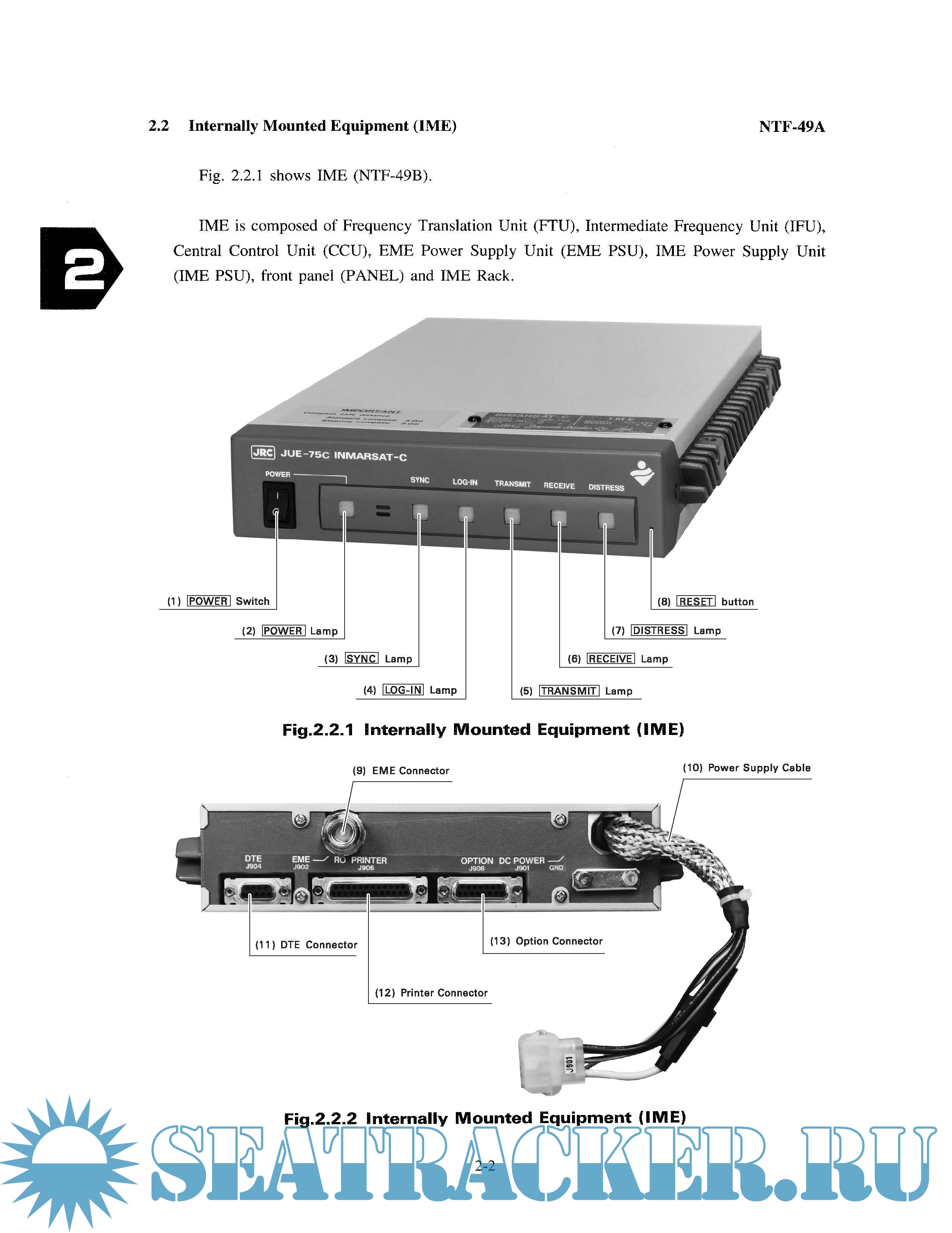

Description: This manual covers the installation, operation and maintenance of the Mobile Earth Station (MES) JUE-75C for Inmarsat-C satellite communications.
The Inmarsat-C satellite communications provides text and data transmission to and from Inmarsat-C MES and terrestrial subscribers via a variety of public networks. It also carries the Enhanced Group Call (EGC) message.
• Function of JUE-75C
JUE-75C provides the following functions;
a) Store and Forward message transfer
b) Distress Alert
c) EGC message reception when not engaged in Inmarsat-C traffic (Inmarsat-C Class 2)
d) Position and/or file transfer by a polling command from shore using store and forward message transfer
e) Scheduled position and/or file transfer using store and forward message transfer
f) Position and/or data reporting using data reporting protocol specified by Inmarsat (depends on LES facility)
