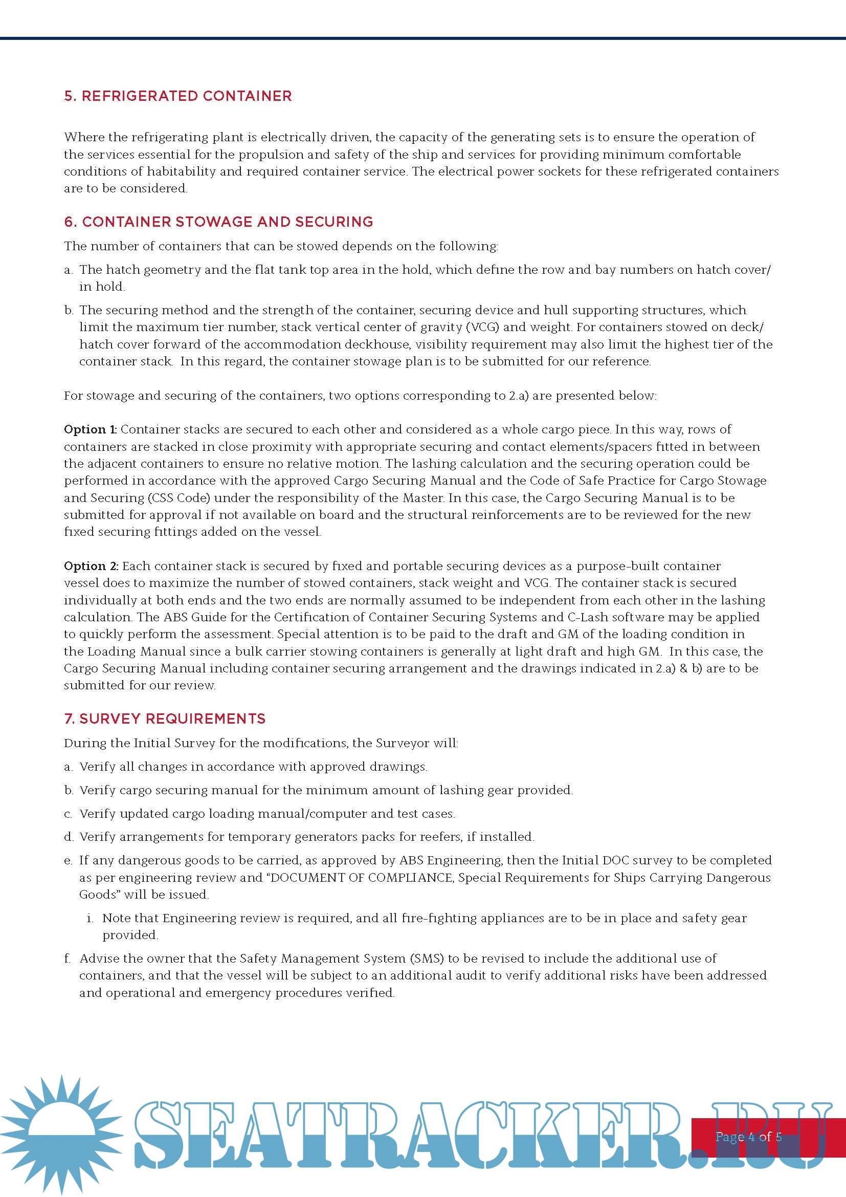

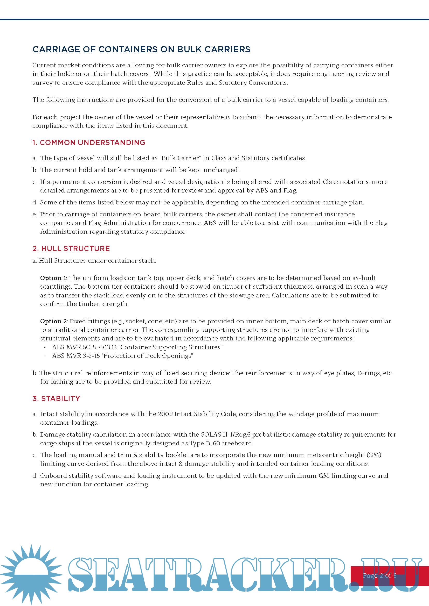

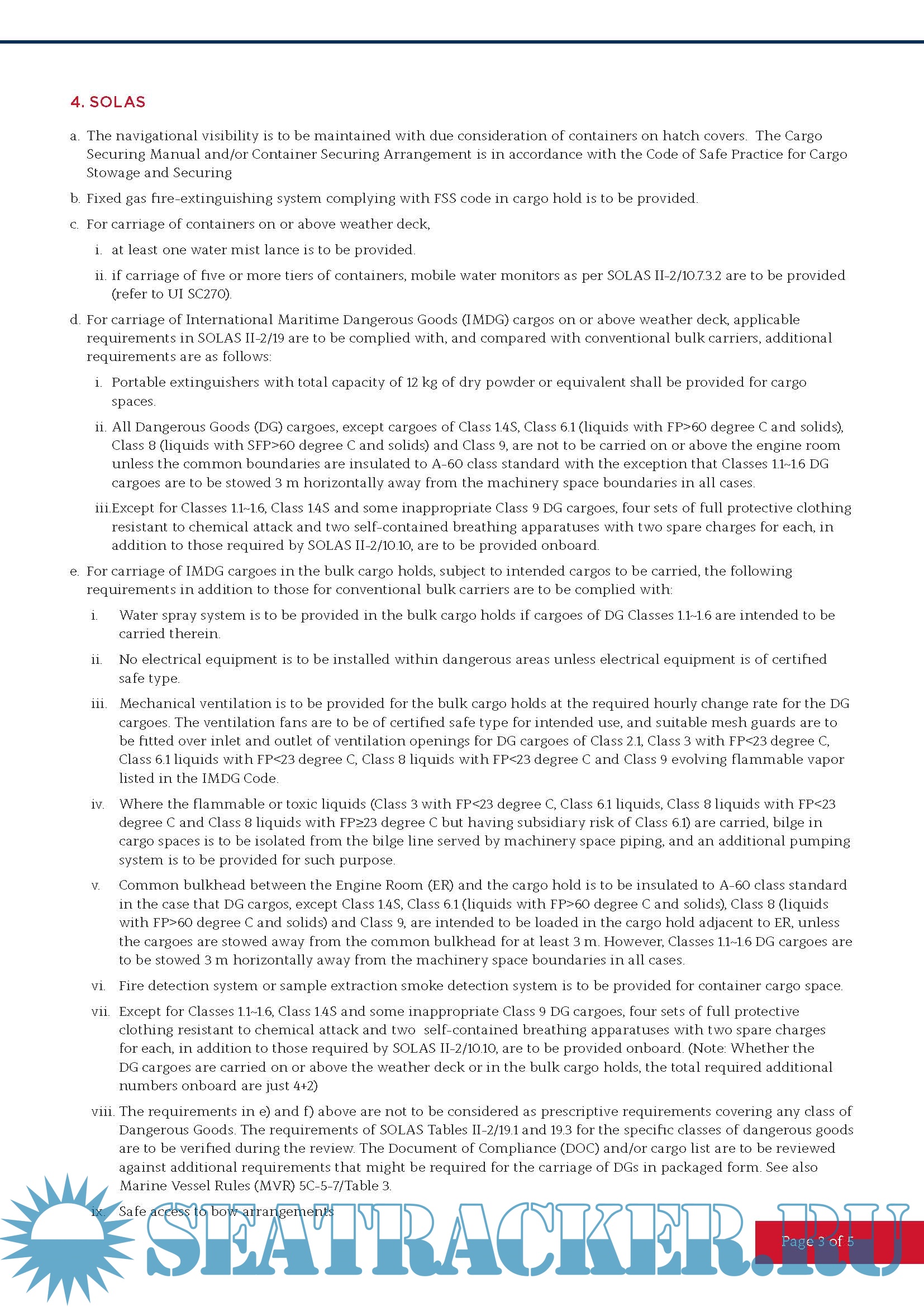

Description: The following instructions are provided for the conversion of a bulk carrier to a vessel
capable of loading containers.
Current market conditions are allowing for bulk carrier owners to explore the possibility of carrying containers
either in their holds or on their hatch covers. While this practice can be acceptable, it does require engineering
review and survey to ensure compliance with the appropriate Rules and Statutory Conventions.
For each project the owner of the vessel or their representative is to submit the necessary information to
demonstrate compliance with the items listed in this document.
