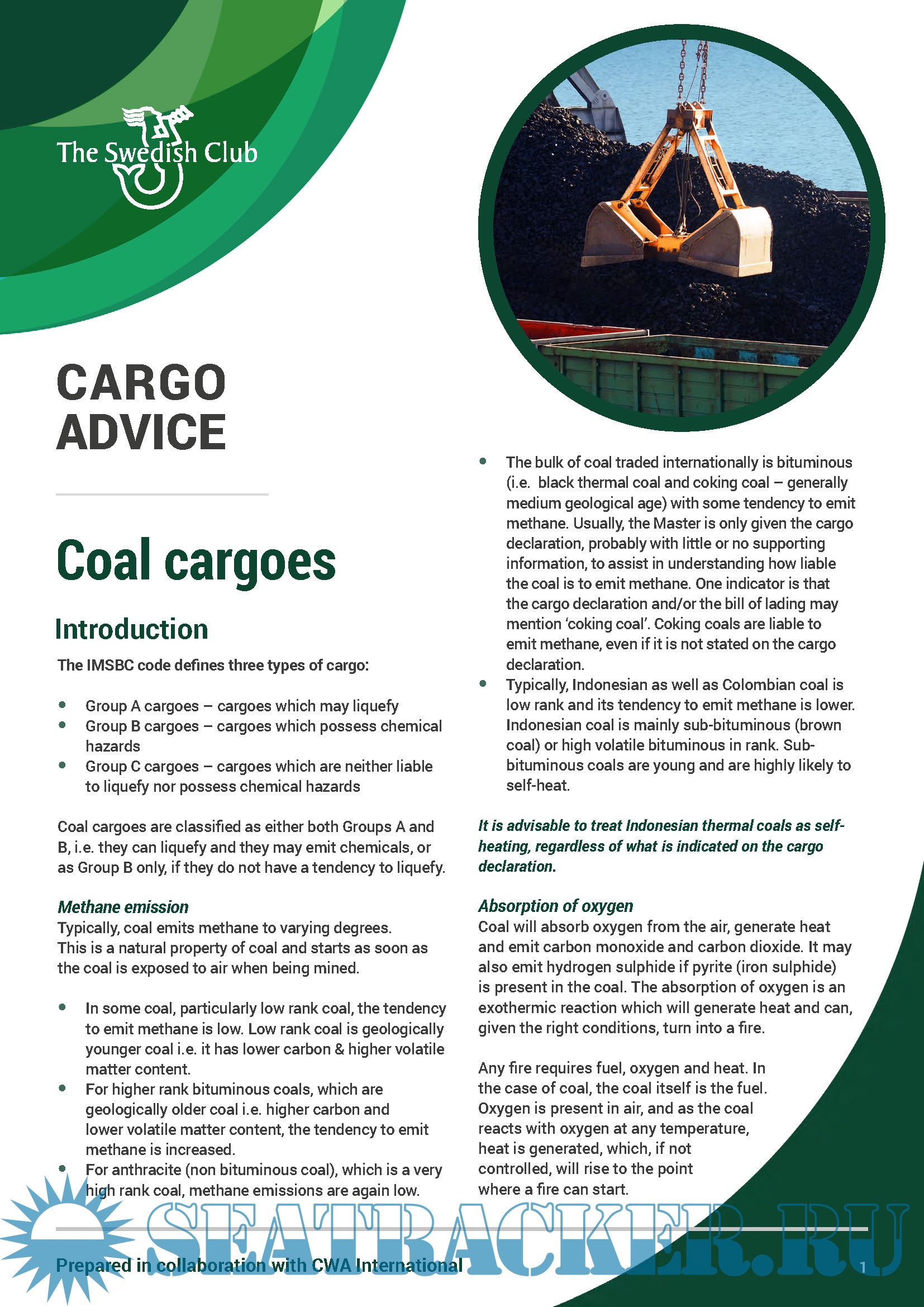

Description: The Swedish Club recently launched a cargo advice Guide, focusing on Coal cargoes shipments.
The IMSBC code defines three types of cargo: group A cargoes – cargoes which may liquefy, group B cargoes – cargoes which possess chemical hazards and group C cargoes – cargoes that are neither liable to liquefy nor possess chemical hazards. Coal cargoes are classified as either both Groups A and B, i.e. they can liquefy and they may emit chemicals, or as Group B only, if they do not have a tendency to liquefy.

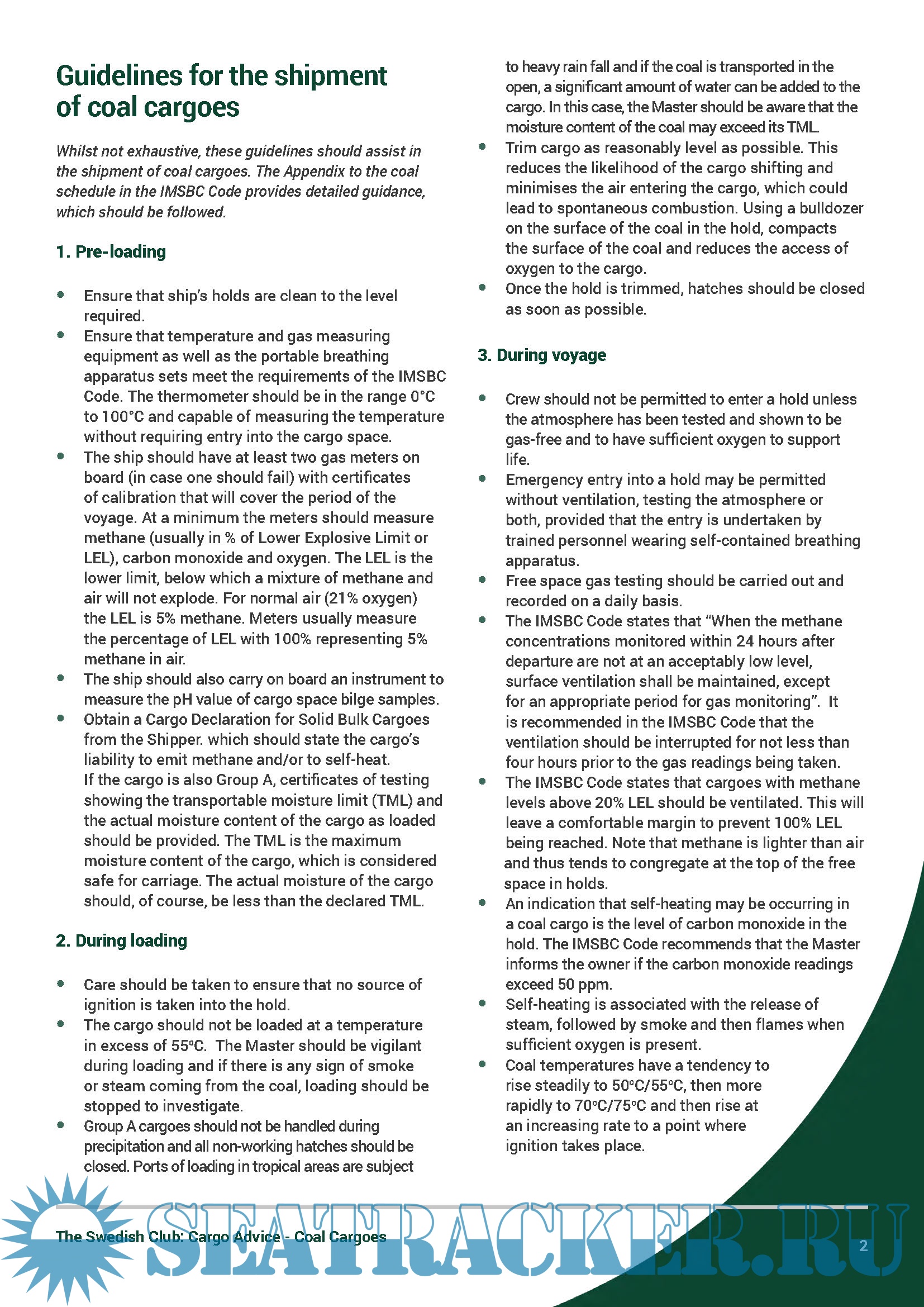

Guidelines for the shipment of Coal cargoes by The Swedish P&I Club
1. Pre-loading
2. During loading
3. During voyage

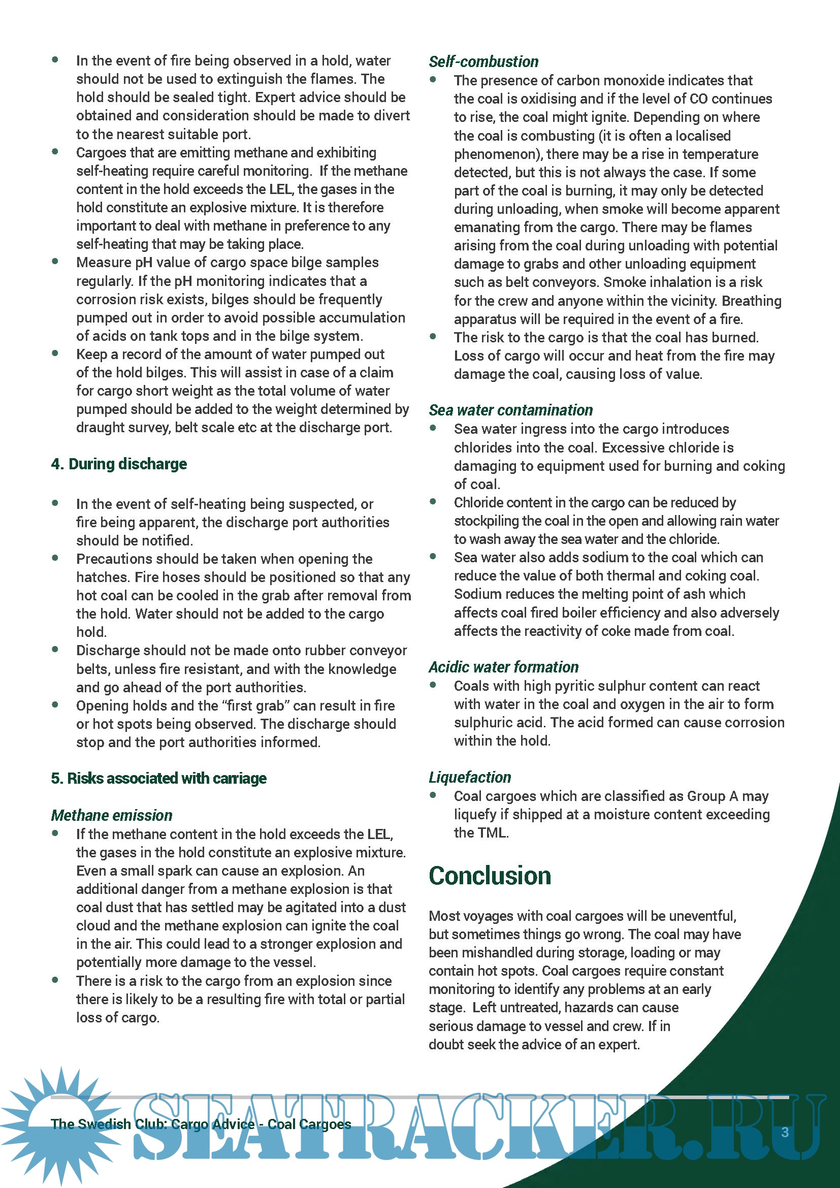

4. During discharge
5. Risks associated with carriage
Conclusion
