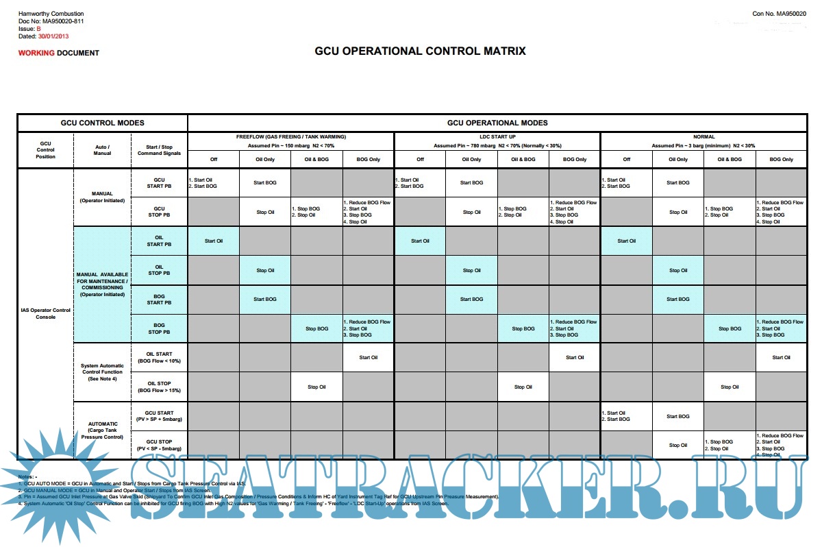

4.4 MA950020-811 GCU OPERATIONAL CONTROL MATRIX

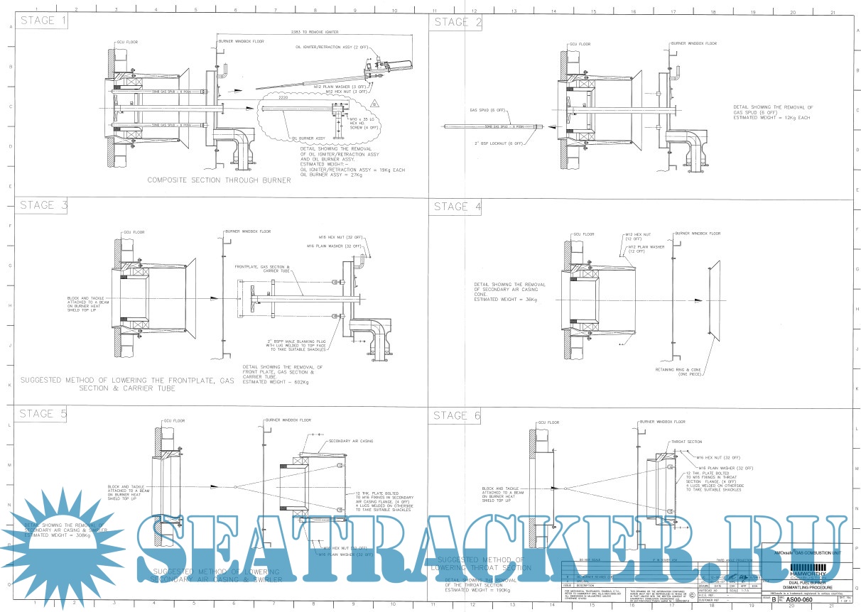

6.1 AS00-060 DUAL FUEL DF925 BURNER DISMANTLING PROCEDURE

AS00-060 Dual Fuel DF925 Burner Dismantling Procedure

MA950020-502 GCU Cause & Effect Diagram
MA950020-503 Analogue Control Scheme
MA950020-504 Sequence Control Overview Flow Diagram
