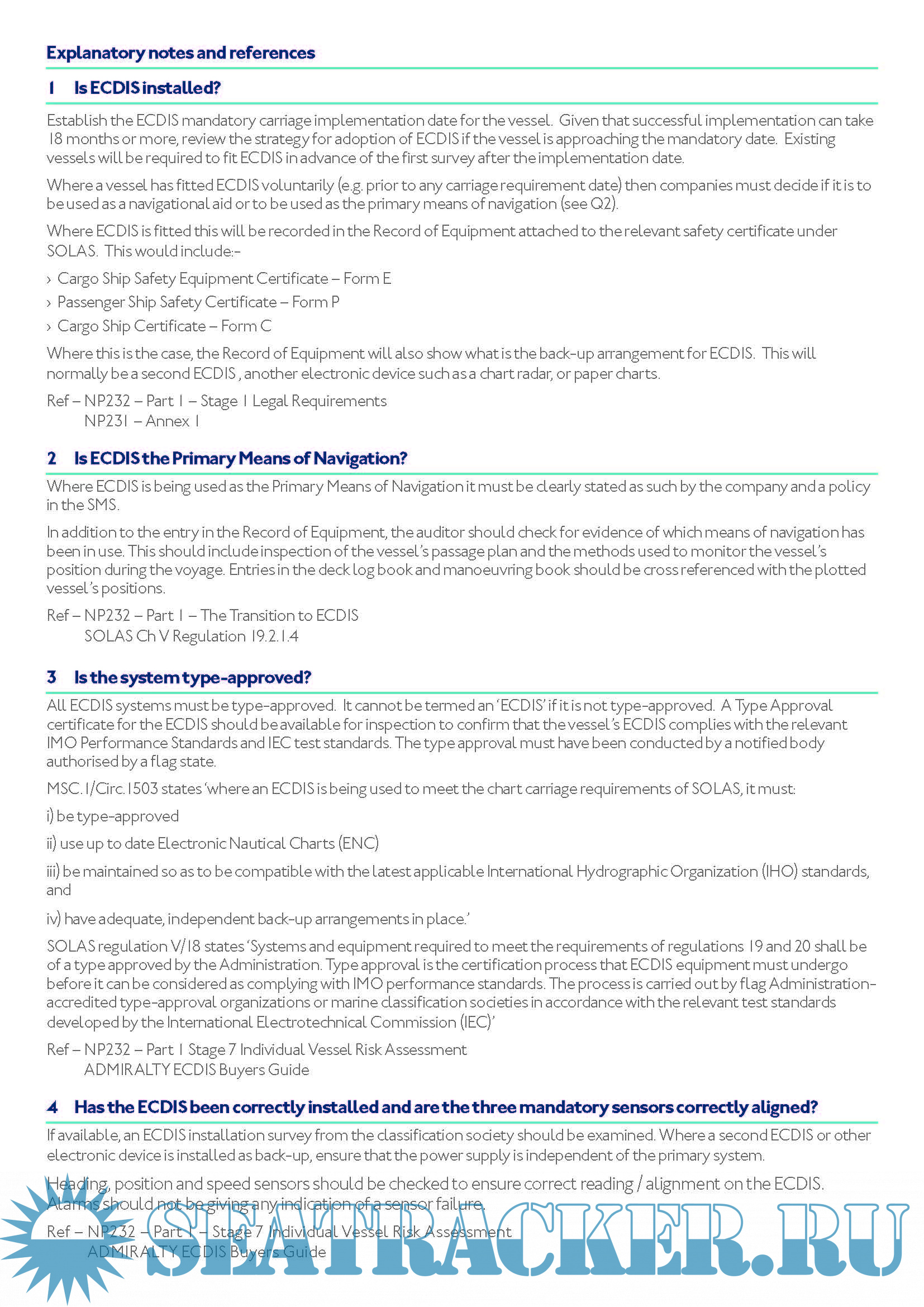

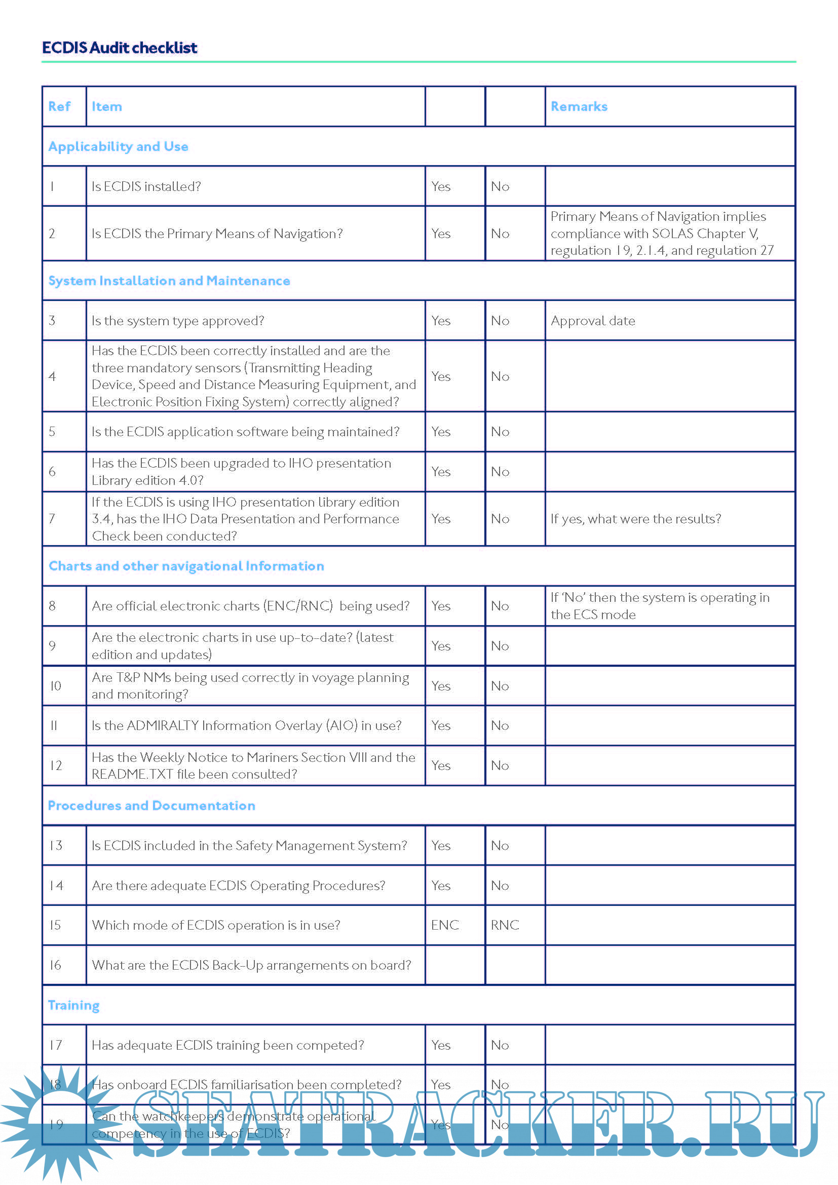

Description: The guide provides concise information in the form of a checklist supplemented by short explanatory notes which
identify key issues which can be expected to be examined during any third party inspection or audit of the on-board
ECDIS. The content of the checklist is based on the IMO ECDIS carriage requirement and Performance Standards,
known inspection criteria and hydrographic office knowledge.
The explanatory notes also provide references to other ADMIRALTY publications and some IMO documents
which give further details.
