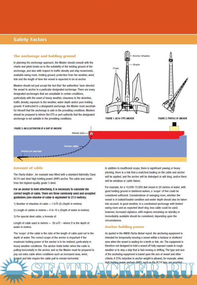

- ANCHORAGE AND HOLDING GROUND
- AMOUNT OF CABLE
- ANCHOR HOLDING POWER
