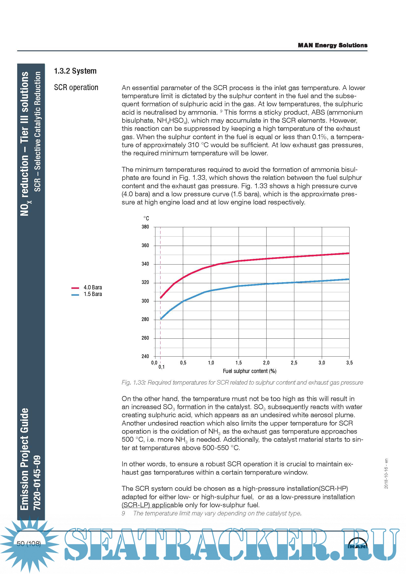

Description: The intention of the Emission Project Guide is to give sufficient information to decide
and design solutions for emission reductions at the initial stage of a project
involving MAN B&W two-stroke marine engines.

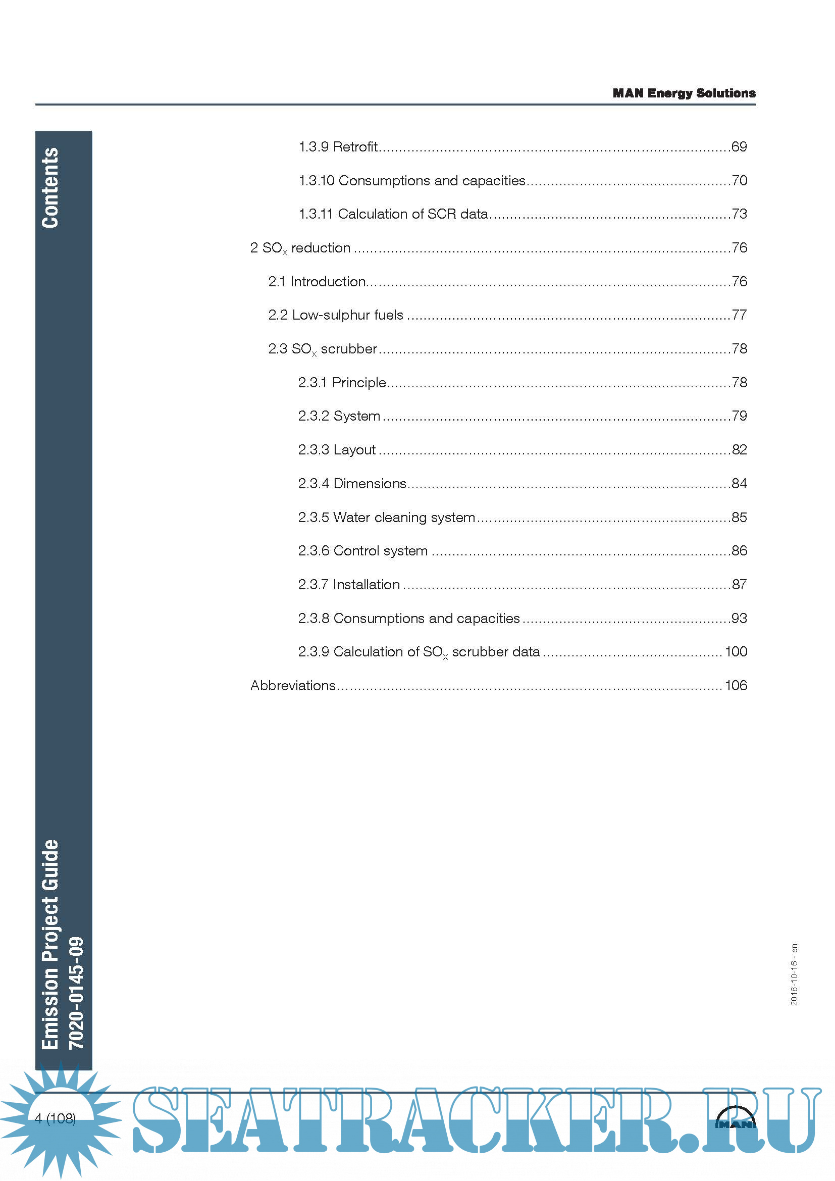

The Emission Project Guide is divided in two parts:
Part 1 NOX reduction – IMO Tier III solutions

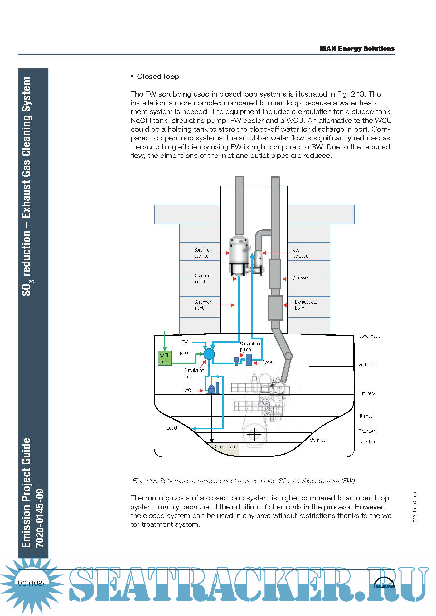

Part 2 SOX reduction – exhaust gas cleaning system
The information provides technical data needed for the preliminary design, including
data for performance, layout, consumables, control and installation of the
equipment. The information is to be considered as preliminary. It is intended for the
project stage only and subject to modification in the interest of technical progress.
