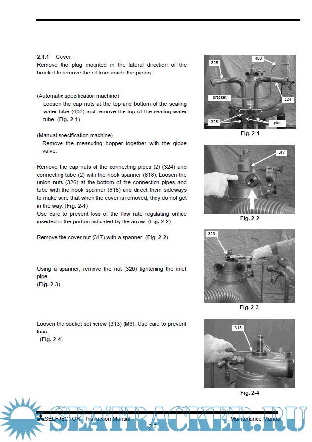

2.1.1 Cover ......................................... 2-3

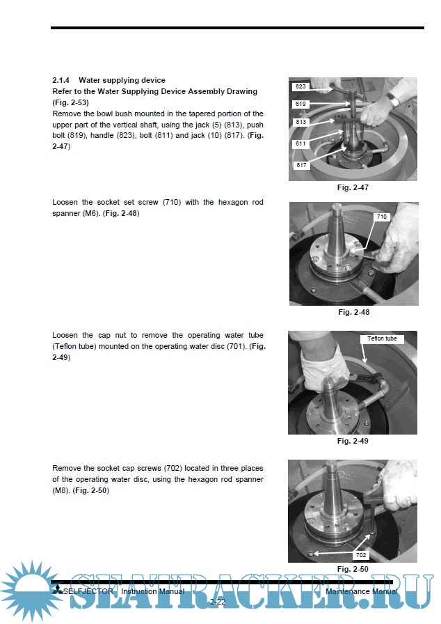

2.1.4 Water supplying device .............. 2-22

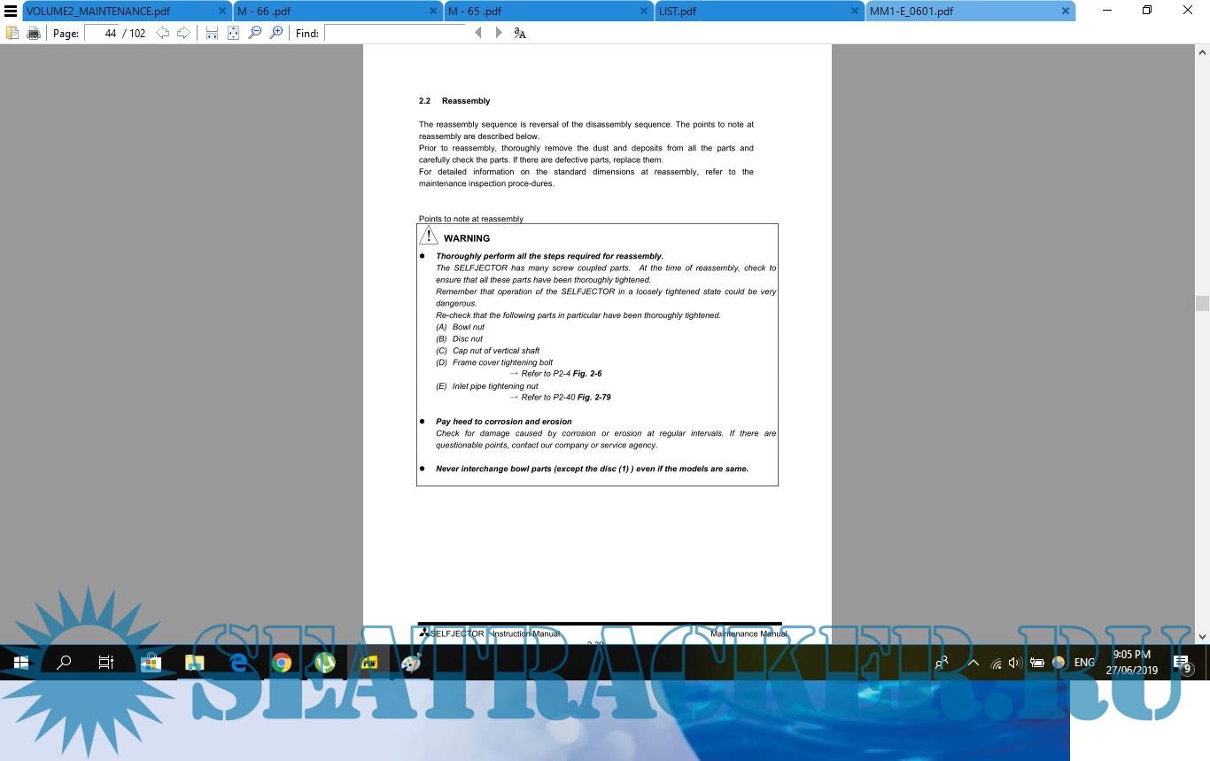

2.2 REASSEMBLY....................................... 2-32
