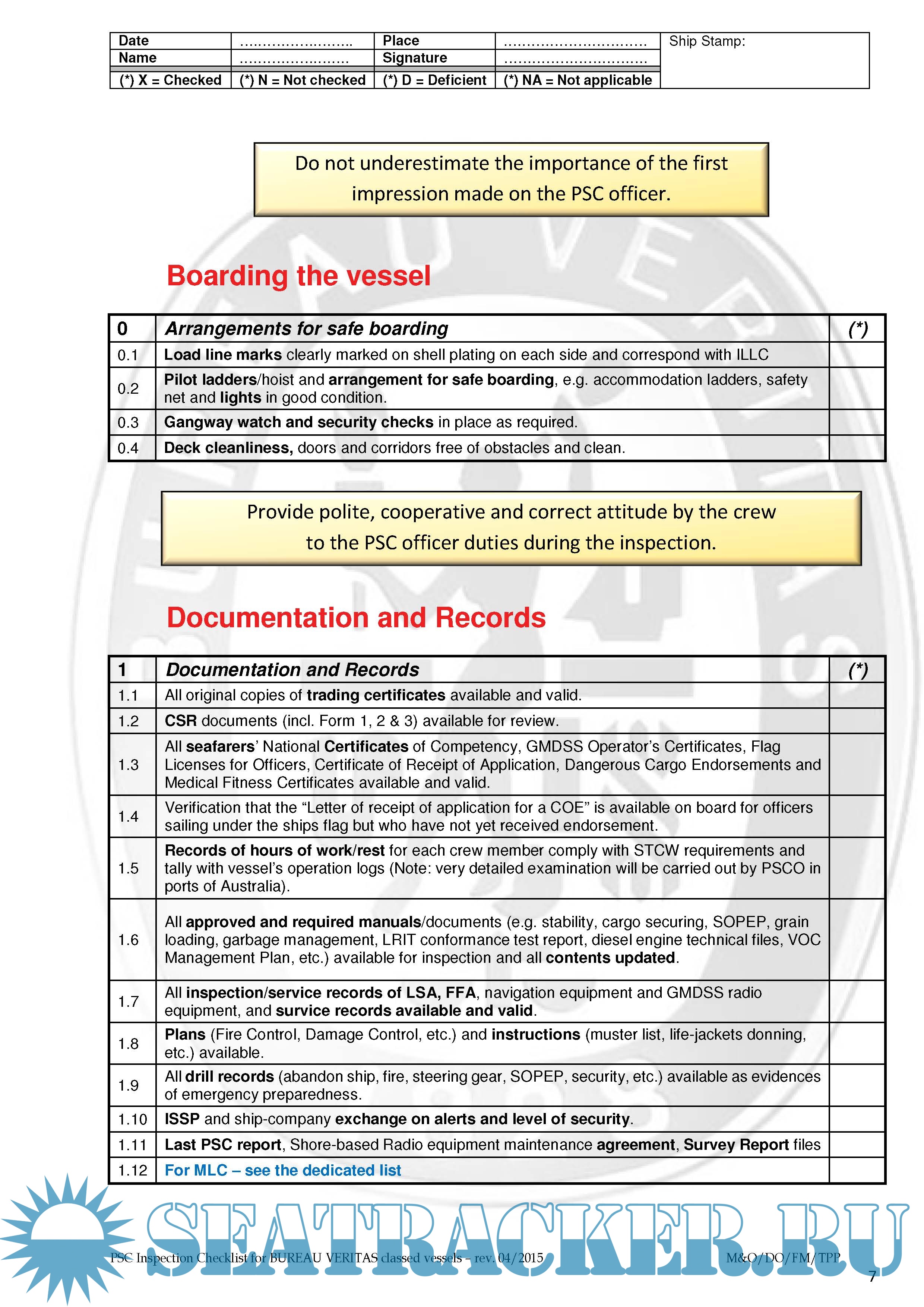

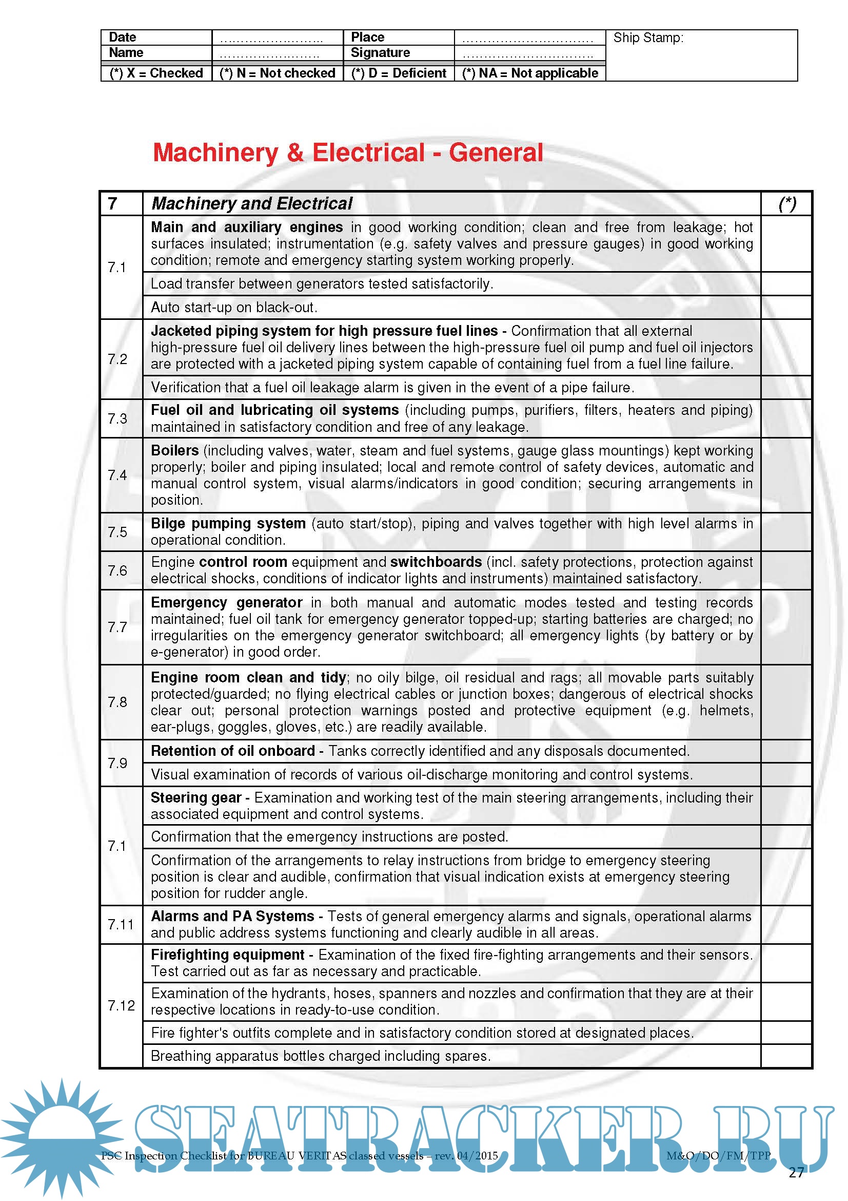

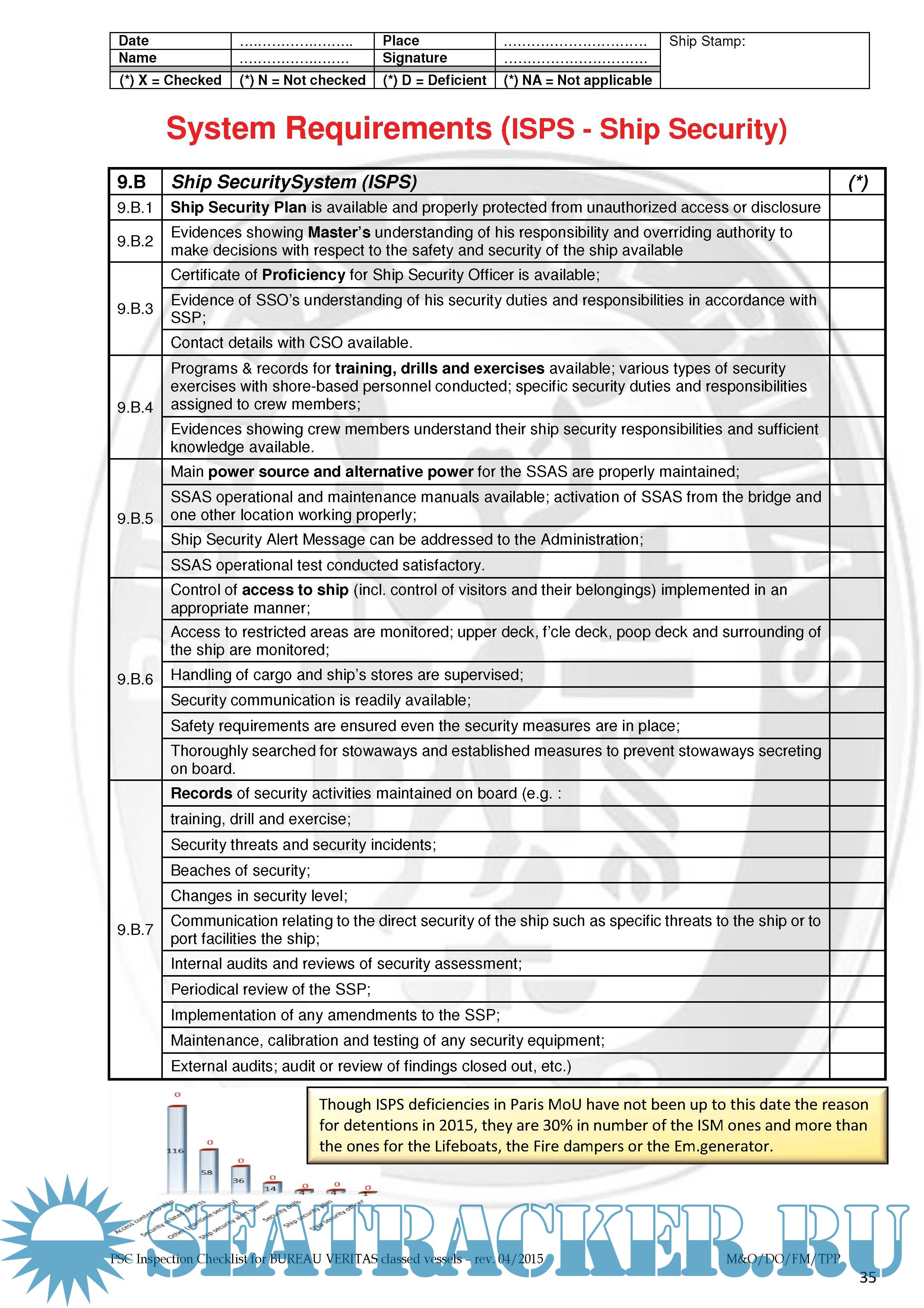

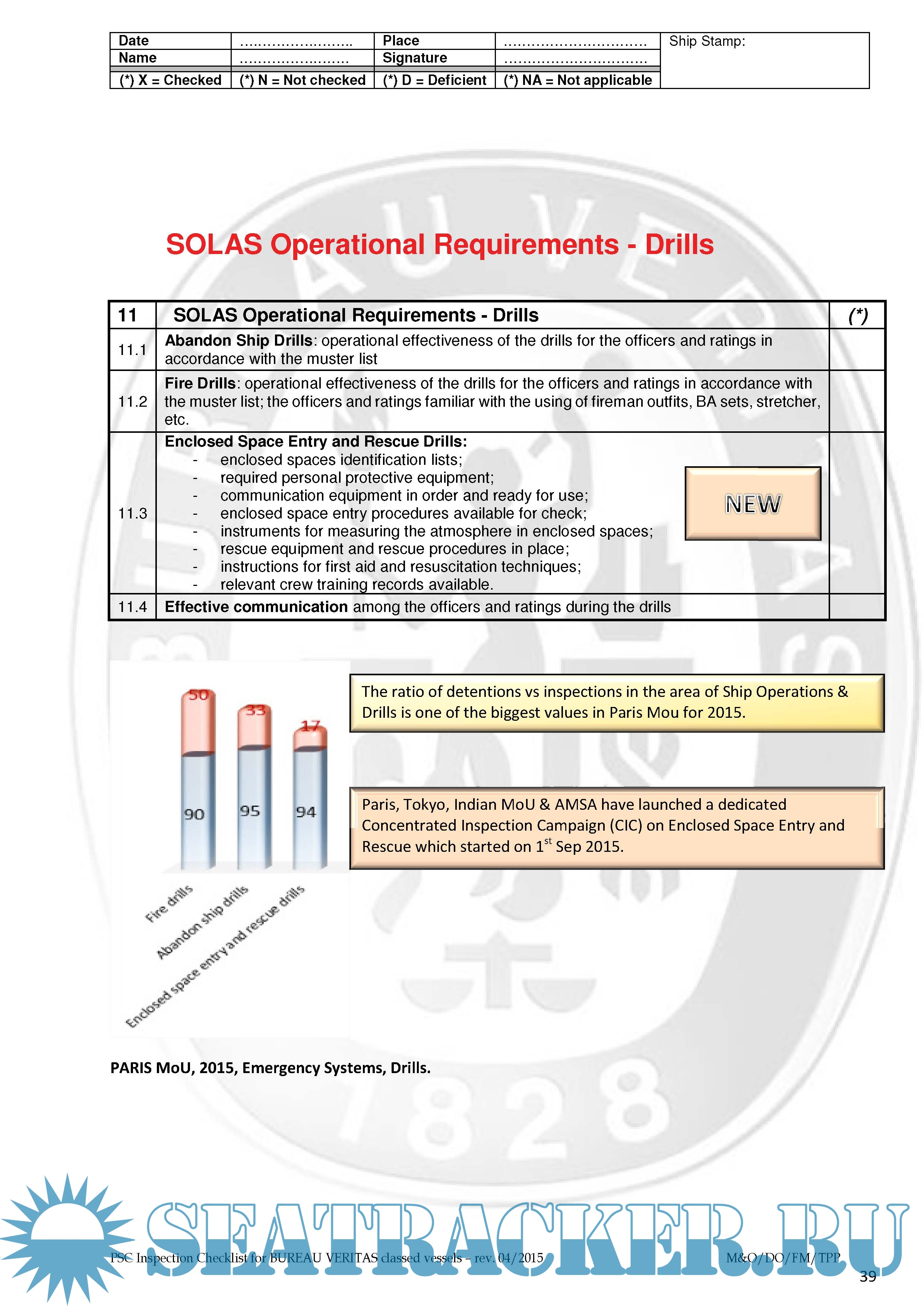

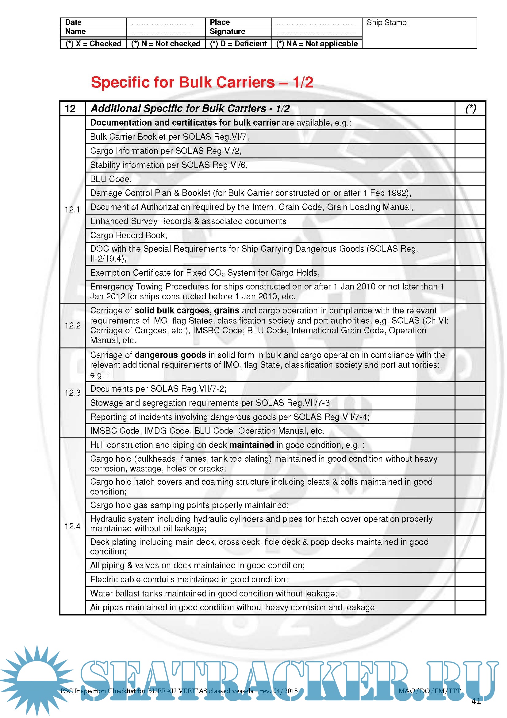

Description: This Check list is issued to assist surveyors and help the responsible crew on board to check
preventively the apparent condition of maintenance of the ship prior to the potential, expected
or consecutive Port State Control inspection.
It does not in any way replace or cover the scope of class and/or statutory surveys carried out
by Bureau Veritas, the Flag state or by Bureau Veritas on behalf of the Flag state.
It is not exhaustive and contains items which are recorded as of elevated attention by the PSC
in different areas. The questionnaire is based also on similar checklists created and distributed
recently by Flag Administrations, marine consultants and organizations. It is reflecting as well
the recent data from statistics available apparently to Bureau Veritas from its own classed fleet
and various external sources.
See Screenshots
