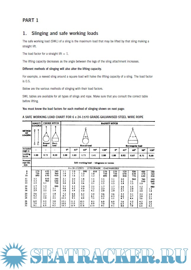

Description: A qualified dogman must know how to:
• use the various types of ropes, slings, chains and accessories
• calculate the safe working load (SWL) of any rope, slings, or chain to be used for lifting
• assess the weight of loads to be lifted
• safely sling loads of different weights and sizes
• direct a crane or hoist operator in the movement of a load when the load is out of the operator’s
view
• give the hand signals and whistle signals used for directing loads.
