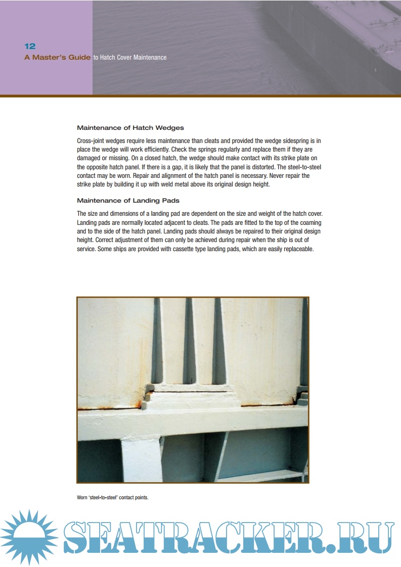

For example, 4mm wear on the steel-to-steel contact is sufficient to damage rubber sealing
gaskets beyond repair; 5mm sag along the cross-joint can cause a large gap between the
compression bar and gasket.

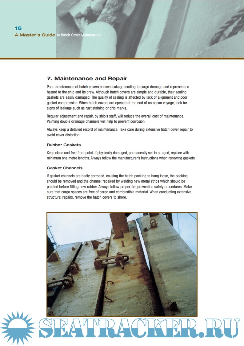

It is the aim of this guide to explain the key issues of hatch cover security and to steer mariners
towards active maintenance. It is less expensive to keep hatch covers weathertight by regular
maintenance and attention to detail, than to pay claims for wet-damaged cargo. It is crucial for safety
at sea and protection of the environment to maintain hatch cover weathertightness and strength.
This guide concerns steel hatch covers fitted with cleats, compression bars and gaskets.
