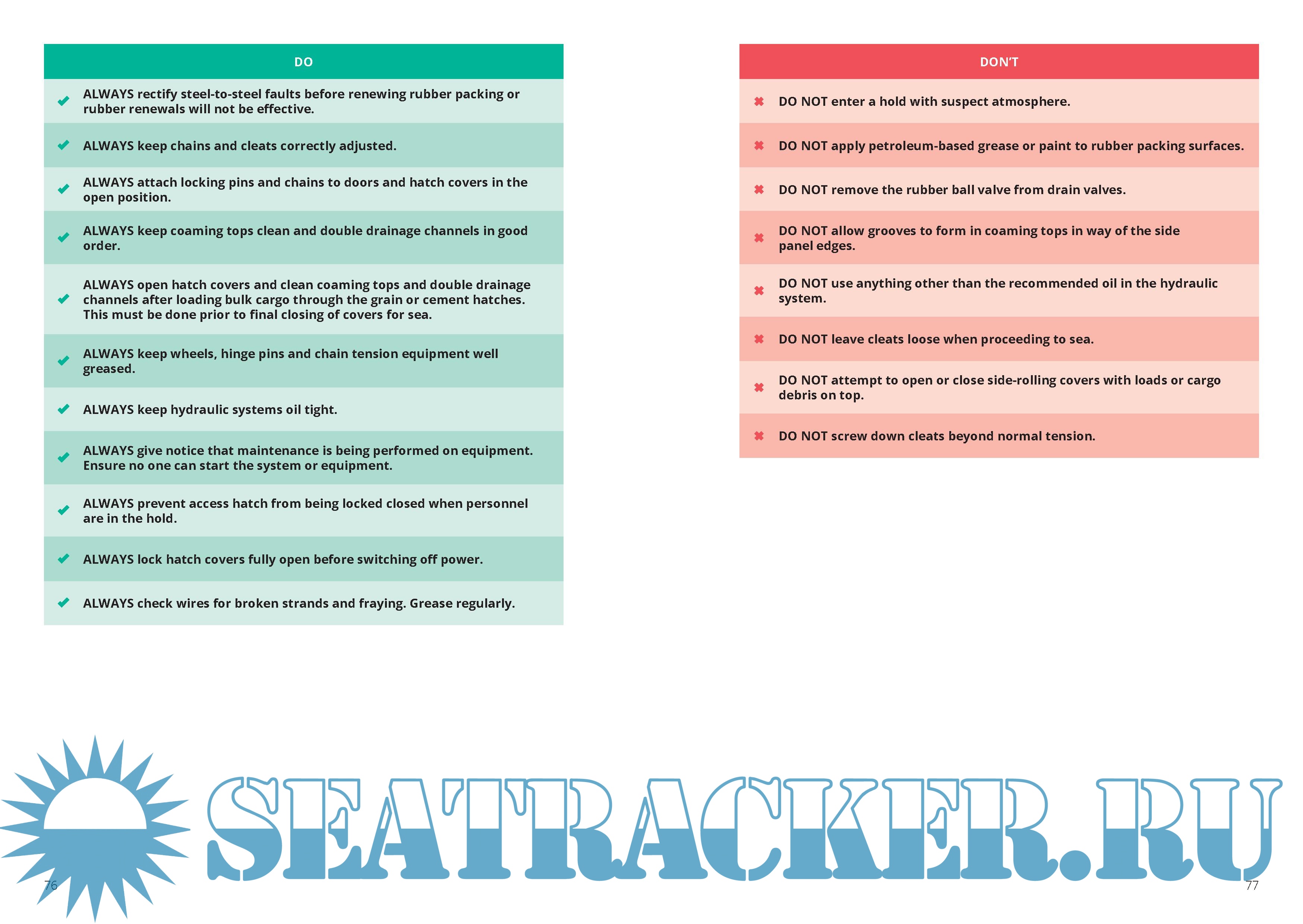

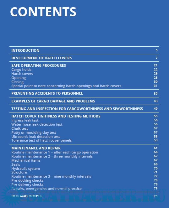

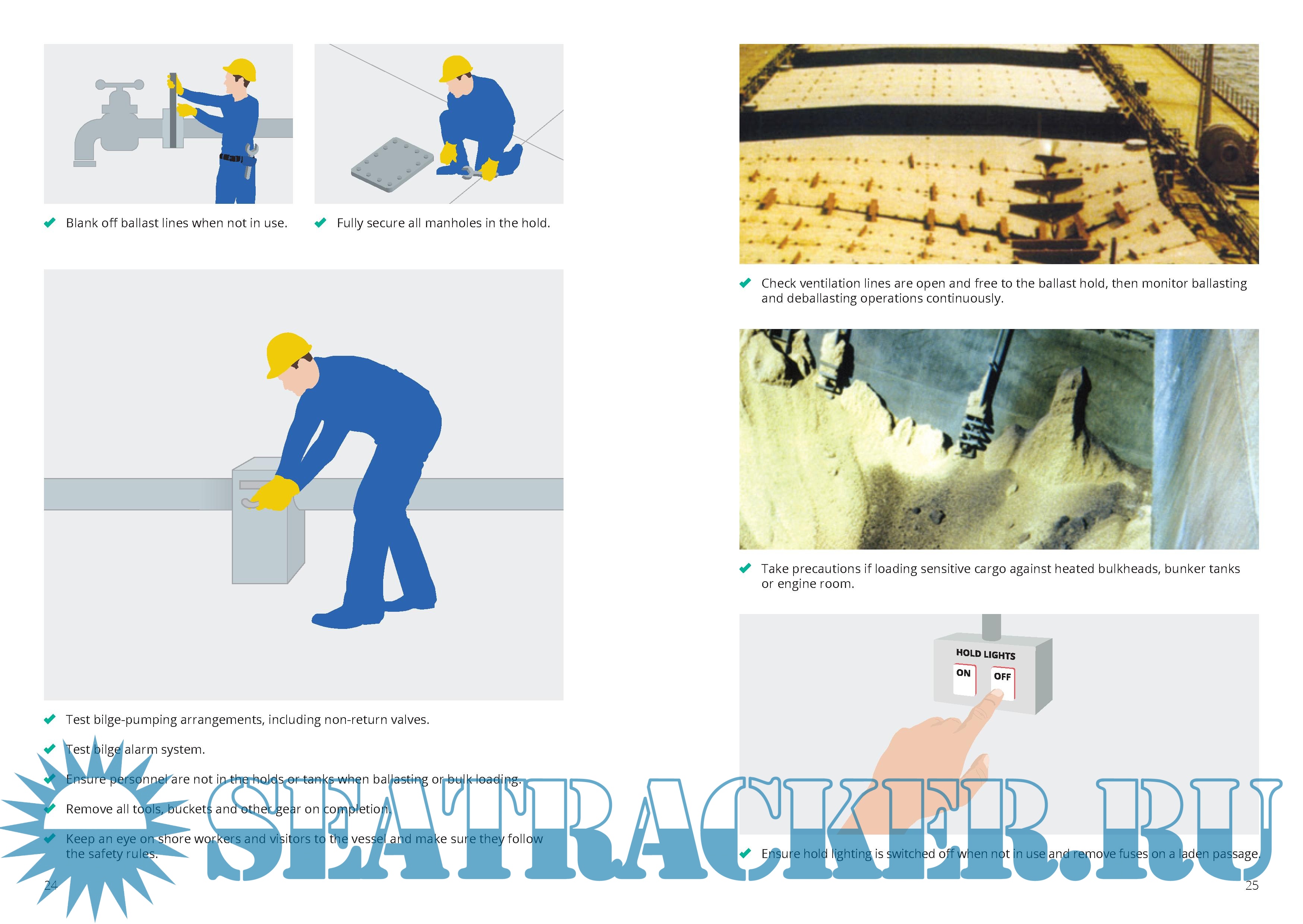

Holds and Hatch Covers - Club’s Guide
Updated The Club’s Guide on the safe operation and maintenance of ship holds and hatch covers. The Guide also covers important safety issues, highlighting right and wrong ways of working, as well as correct practices and potential dangers.
This guide aims to provide simple pointers for the safe operation and maintenance of the holds and hatch covers of ships carrying dry cargoes.
Safety of personnel and care of cargo are the prime considerations addressed, but efficiency, economy and reputation are all taken into account.
The Guide is designed to assist shipboard staff in identifying the right and wrong ways of working by highlighting correct practices and pointing out potential dangers.
The generous use of photographs, sketches and simplified wording is intended to encourage use of the book by those with a limited knowledge of English.
