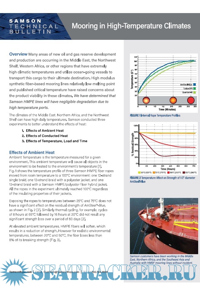

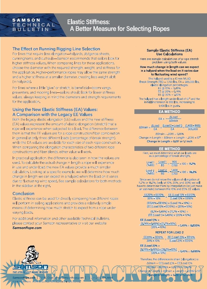

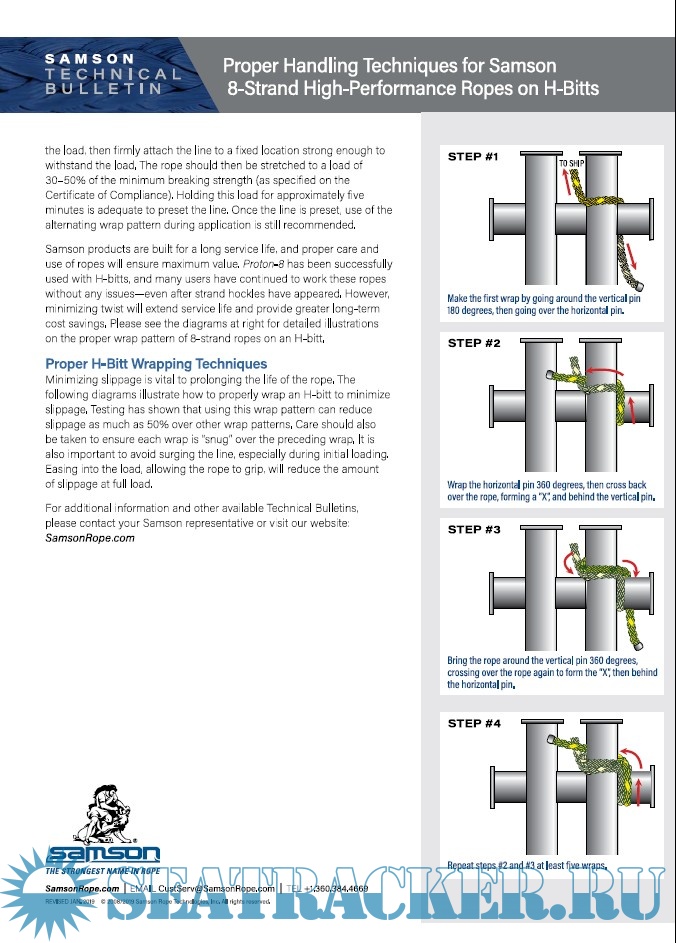

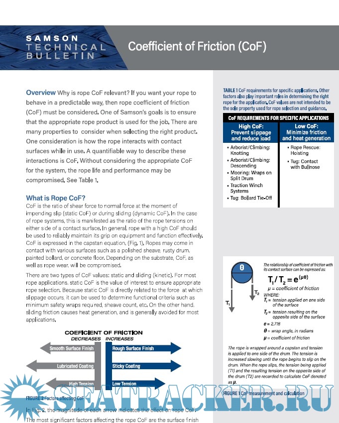

Description: The use of rope involves different levels and modes of tension, bending, friction, and mechanical damage, as well as a wide range of environmental variables such as temperature and chemical exposure. Regardless of application, rope is exposed to service conditions and degradation. Maximizing rope performance and safety involves selecting the correct rope, using optimal handling during its use, and retiring it from service at some point.
A considerable amount of professional data sheets, divided by type of work (mooring, tug, recreational...), about rope handling, installation method, care, maintenance and end-for-ending procedures. Plus a use manual and a focus on HMPE mooring lines (slides)

tb_coeffecient_of_friction.pdf
tb_handling-techniques-for-8strand-on-hbitts.pdf
