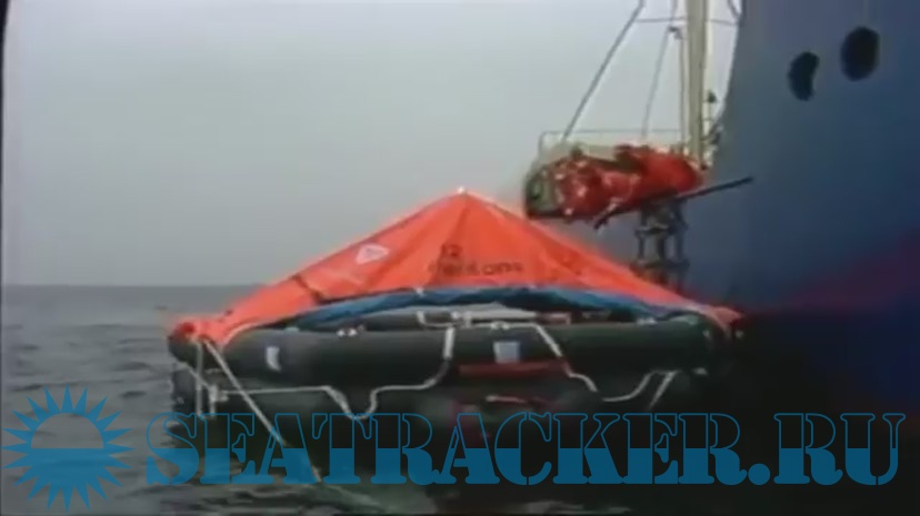

Description: Life rafts are provided as a life-saving appliance on every seagoing merchant or passenger ship, in addition to the lifeboats.
Life rafts are much easier to launch as compared to lifeboats and in case of emergency situations, evacuation from the ship can be done without manually launching any of them as the life rafts are designed with an auto-inflatable system.
Liferaft Launching Procedure.

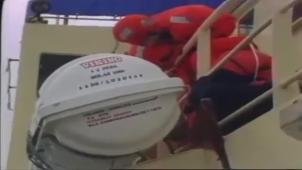

• Check that one end of the painter of the raft is well secured to a strong point on ship’s deck or structure.
• Remove the lashing from the container of the raft and open the way to portable rail if available.
• Check the ship side where the raft to be launched is clear.
• Two people should lift the container from both sides horizontally and throw the container.
• Make sure the painter is still fixed at a strong point so that the raft should not be waved away by waters.
• Pull the painter with a hard jerk to fire the gas bottle to inflate the raft.
• The life raft will take 20-30 sec to inflate.

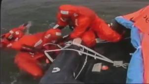

• Board the life raft one by one using ladder or rope.
• Avoid sharp objects like knives, shoes and other sharp objects etc which may damage the raft surface.
• When everybody is aboard, after a headcount, cut the painter with a sharp knife.
