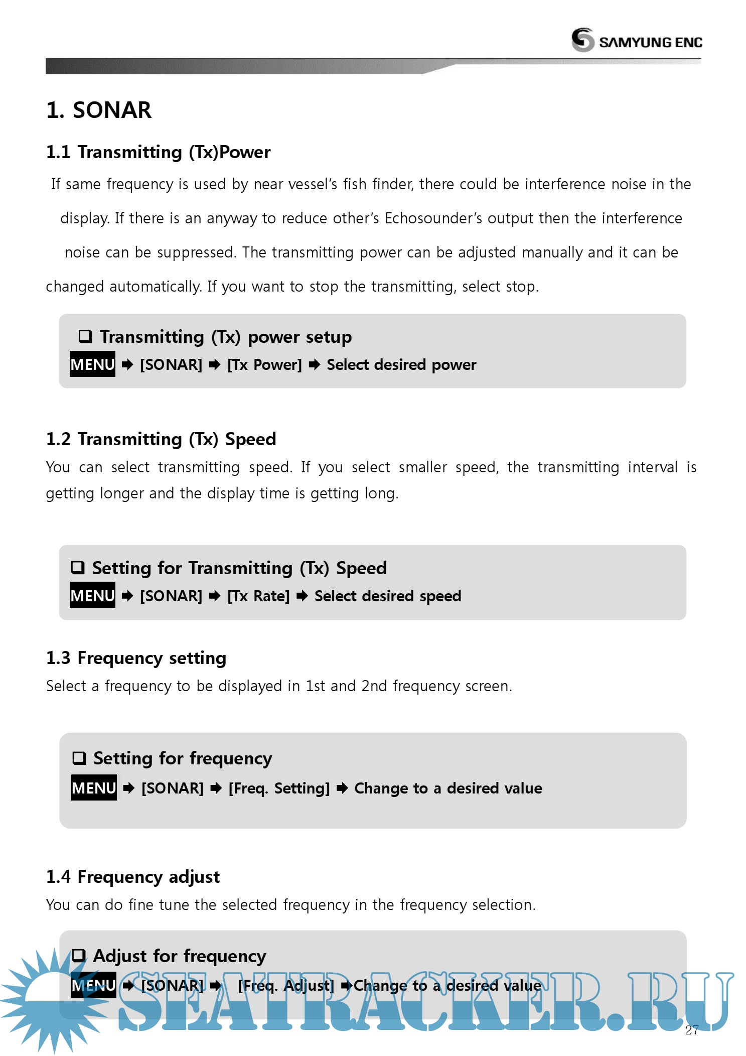

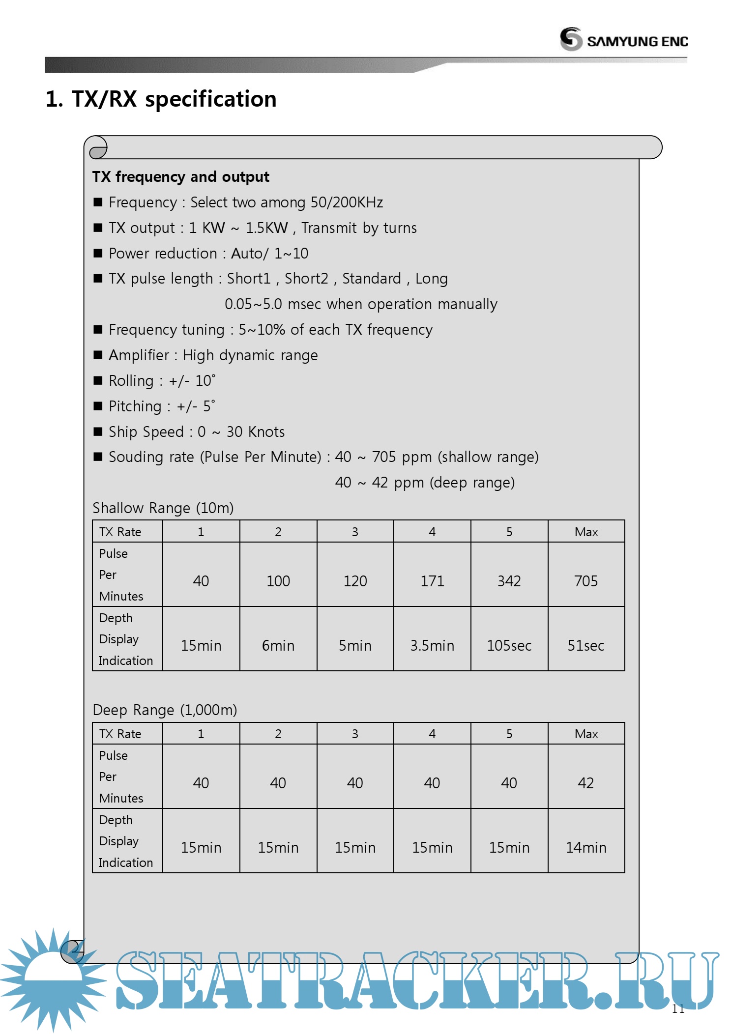

Description: TX frequency and output
 Frequency : Select two among 50/200KHz
 TX output : 1 KW ~ 1.5KW , Transmit by turns
 Power reduction : Auto/ 1~10
 TX pulse length : Short1 , Short2 , Standard , Long
0.05~5.0 msec when operation manually
 Frequency tuning : 5~10% of each TX frequency
 Amplifier : High dynamic range
 Rolling : +/- 10˚
 Pitching : +/- 5˚
 Ship Speed : 0 ~ 30 Knots
 Souding rate (Pulse Per Minute) : 40 ~ 705 ppm (shallow range)
40 ~ 42 ppm (deep range)
