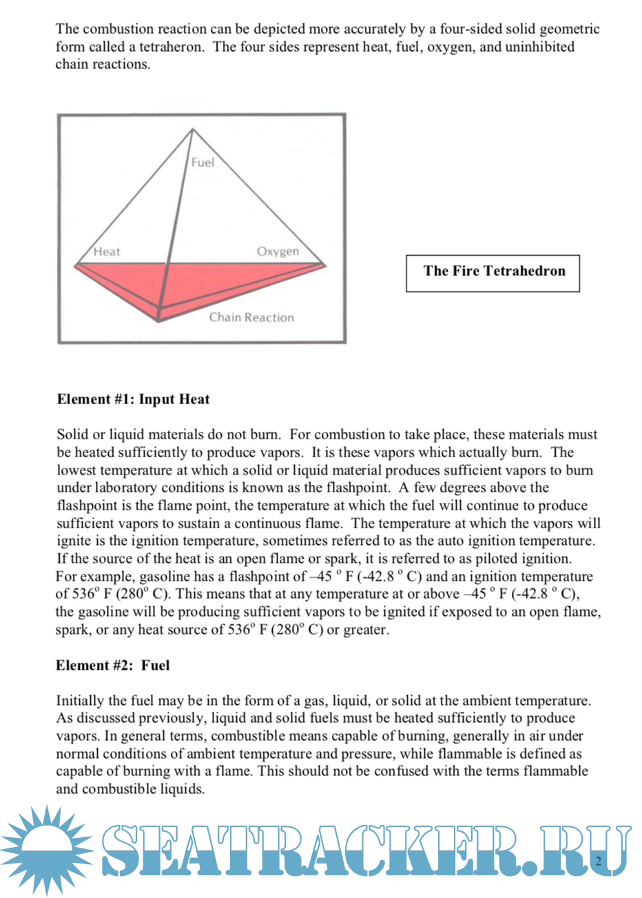

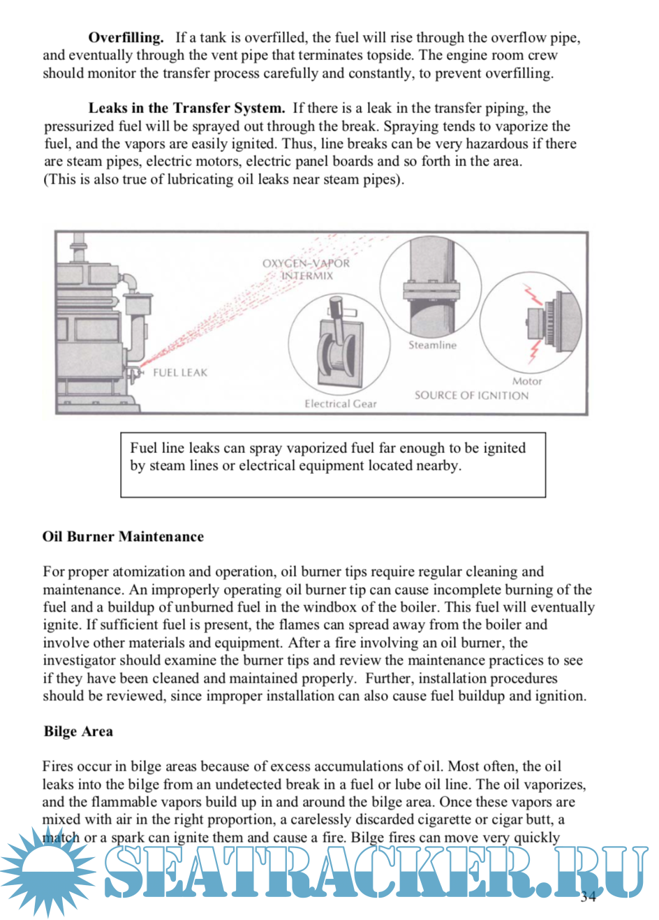

Description: s. Investigators may have to expend considerable time and effort before the cause can be identified. The destructive power of the fire itself compromises evidence from the outset. The larger a fire becomes and the longer it burns, the less evidence of causation will remain. In some fires, sufficient data to establish the origin and cause (i.e., evidence) do not survive, no matter how diligent the search or well prepared the searcher. Destruction of evidence may also be a result of the normal and necessary duties of fire personnel carrying out rescue, suppression, overhaul, and salvage tasks.
