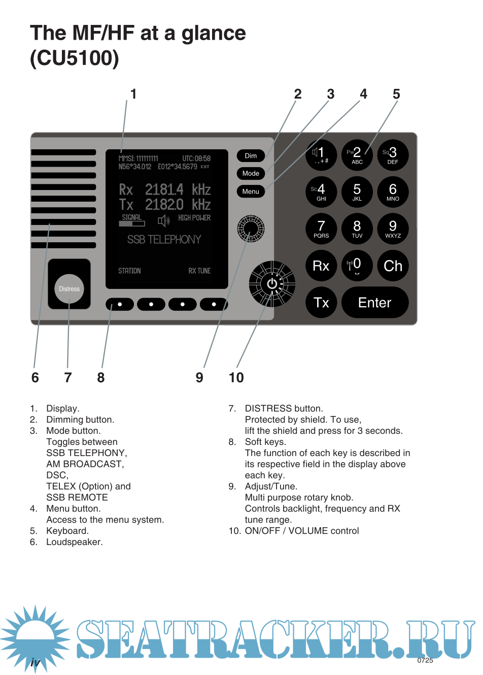

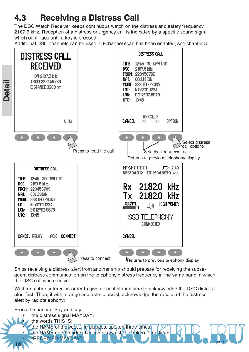

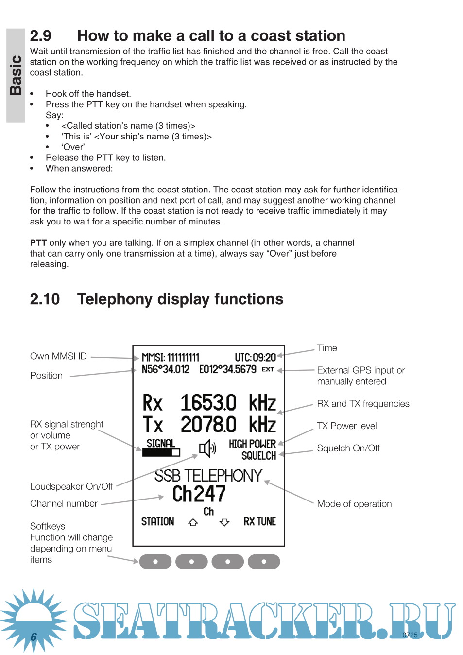

Description: Congratulations on your new SAM CU5100 MF/HF maritime radio telephone with built-in DSC (Digital Selective Calling) system, fulfilling the highest international standards for marine MF/HF communication and safety procedures. The transceiver is born with a 2187,5kHz DSC watch receiver forming an ideal system for MF GMDSS installations. The transceiver can easily be upgraded for 6 channel scanning DSC watch receiver and Telex operation to comply with MF/HF requiements in sea area A3. If connected to a GPS or other maritime navigation system it can automatically include the true UTC time and your position in its DSC distress messages. For an explanation of DSC, see page 2.
The equipment is specially designed for the extremely rugged conditions on board a ship, based on more than 50 years of experience with all kinds of vessels, from small pleasure crafts, over fishing vessels working under all climatic conditions, to the biggest ships.
About this manual
This manual is for the daily user of the system. Additionally, it includes a section on the installation procedures, and - on page ii - standard distress procedures. We highly recommend you to read the manual before you start using the equipment.
Notice: There may be some minor differences in the graphic layout of the product in the manual compared to the actual physical unit.
