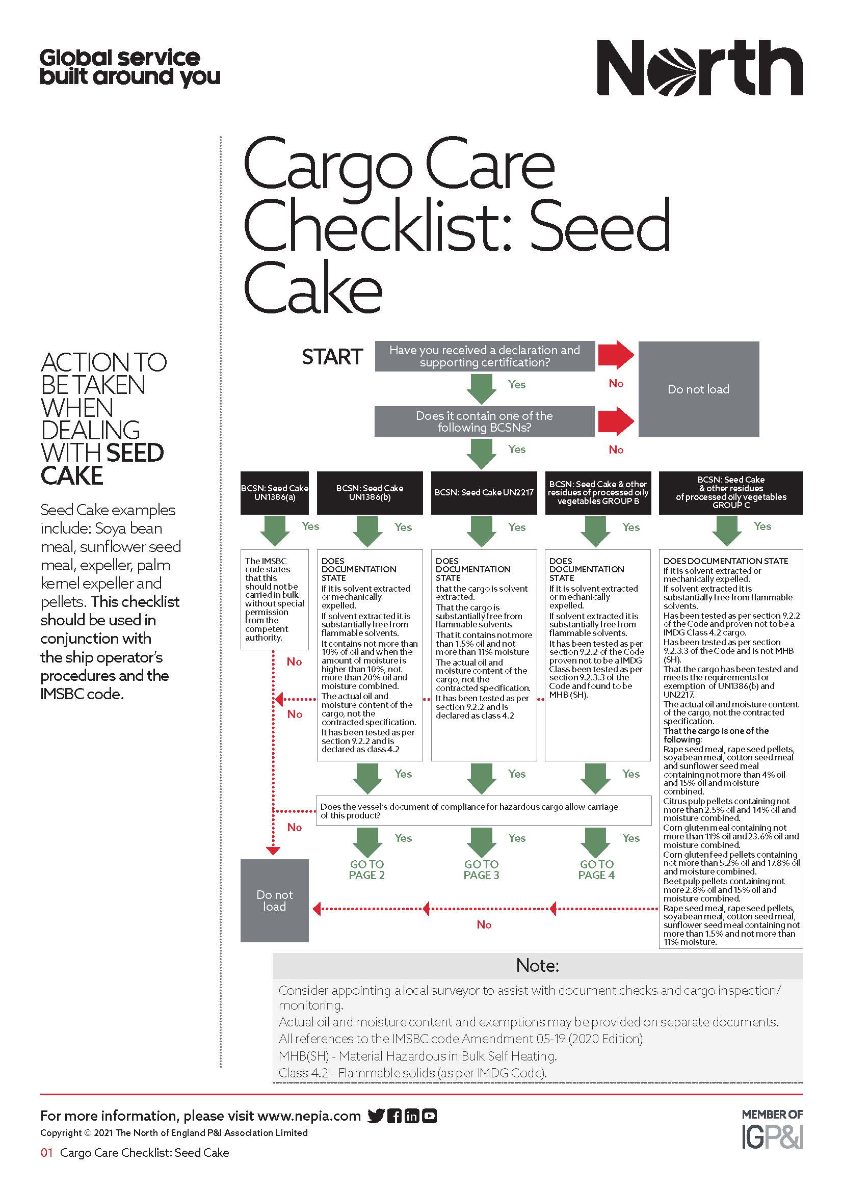

Preparation of a cargo hold is not just a question of sweeping, cleaning or washing down the hold. There are a number of matters to
consider, and failing to adhere to good practice can result in substantial claims. A lack of knowledge, often originating in chartering
or commercial departments, can also be the underlying cause of major claims.
The North has produced new checklists that provide simple and sensible guidance for crew to care for cargo.
From preloading preparations through to discharge, the Cargo Care Checklist series covers a range of cargoes.
These checklists can be used as a useful reminder for ships' crews, regardless of experience.
Designed to supplement carriage instructions and statutory requirements, the checklists encompass best practice and target the areas
which often result in claims. It also assists the crew in ensuring that they gather the required evidence at all stages of the operations and
voyage in case of future disputes.
