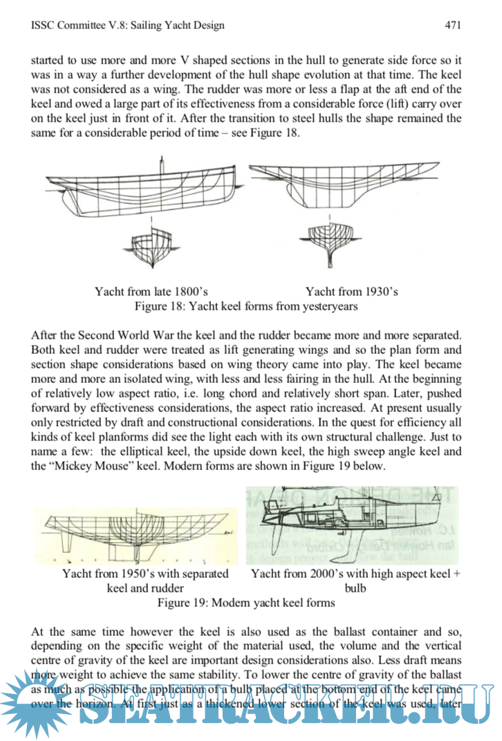

Originally “jachts” were built in wood and in construction quite similar to what was customary in the normal shipbuilding of that time. The hull was single (massive) planking connected to closely spaced wooden frames. The frames were connected to wooden floors and those to the bottom planking. In the early days many yachts still had flat or slightly curved bottoms. At the upper side the frames were connected to the deck beams on which the deck planking was laid. Longitudinal stringers were mostly absent.
Later when yachts got keels the construction changed. The sections became rather more V shaped asking for different construction techniques. The stem beam, the keel beam and the stern beam were introduced, which functioned also as longitudinal stiffeners, to which the frames were connected, which in turn were connected by the floors. The difficulties and weaknesses in the available connecting techniques of that time however posed a serious limit on the achievable overall strength and in more in particular the overall rigidity of the yacht hull structure. All wooden construction was only to return in yacht building after the 1970’s, when new and serious bonding techniques became available, such as the epoxy resins, together with new wood laminating techniques.
