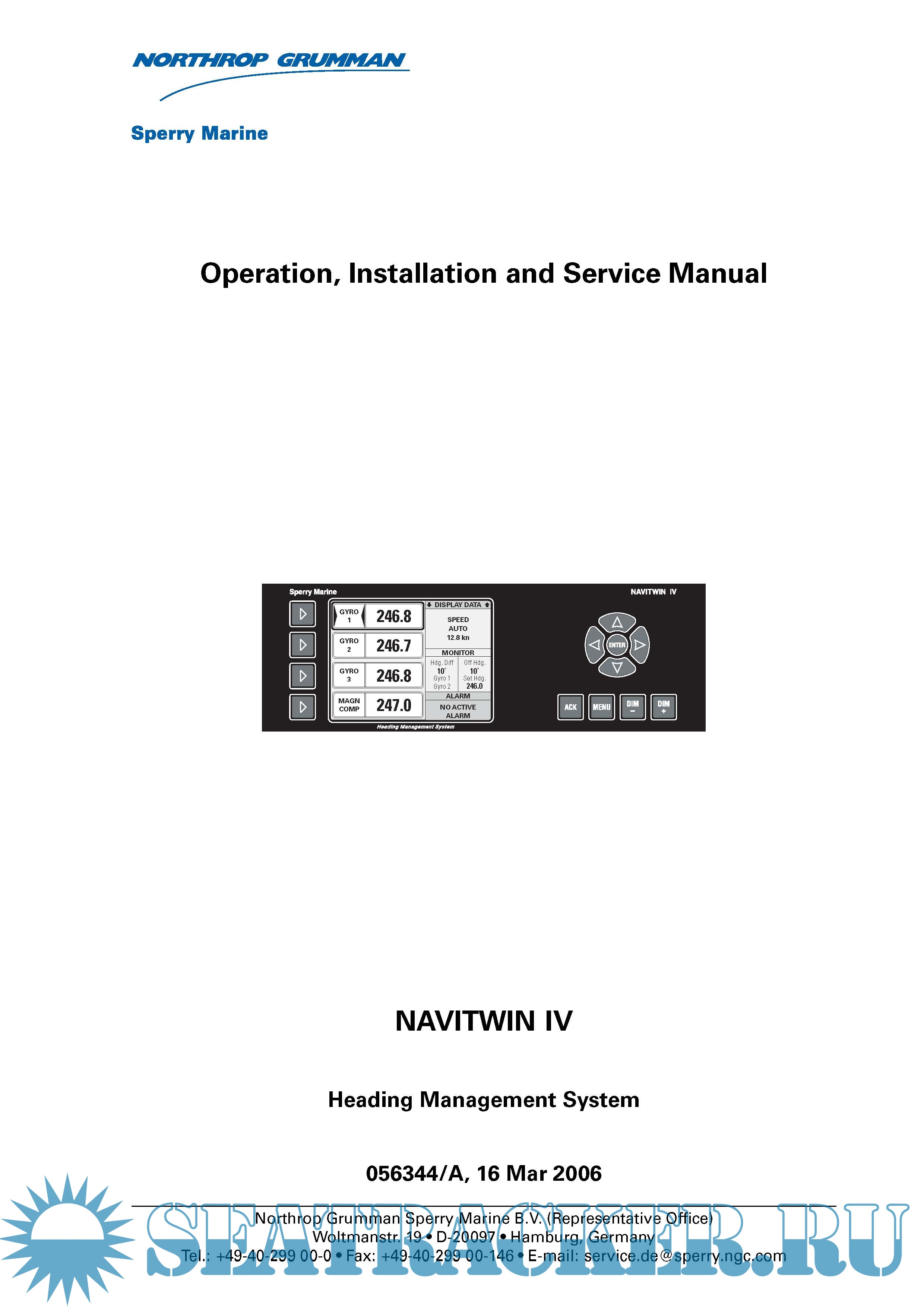

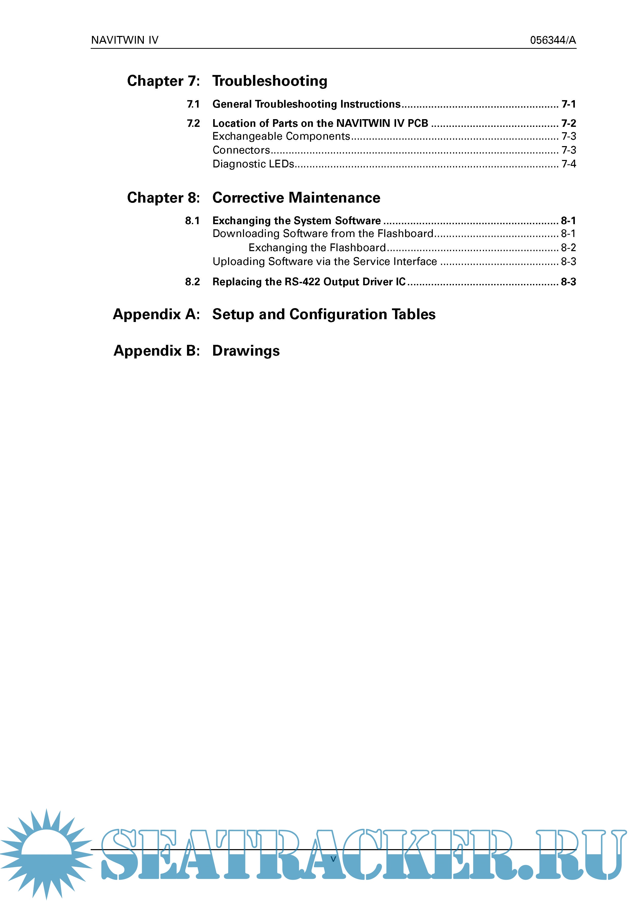

Sperry Marine NAVITWIN IV Heading Management System Operation, Installation and Service Manual
Year: 2006
Author: Northrop Grumman Sperry Marine B.V.
Publisher: Northrop Grumman Sperry Marine B.V.
Pages count: 102

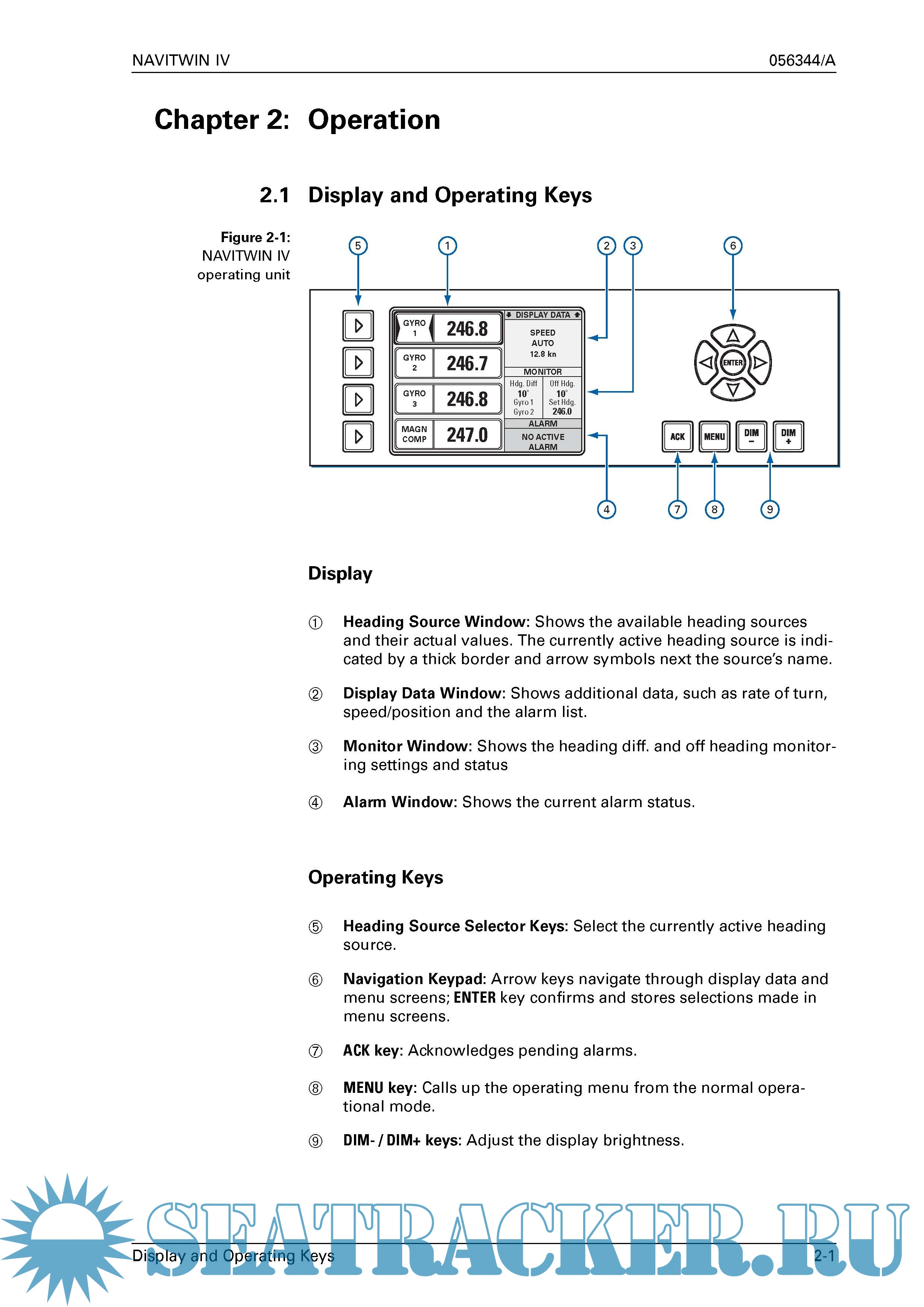

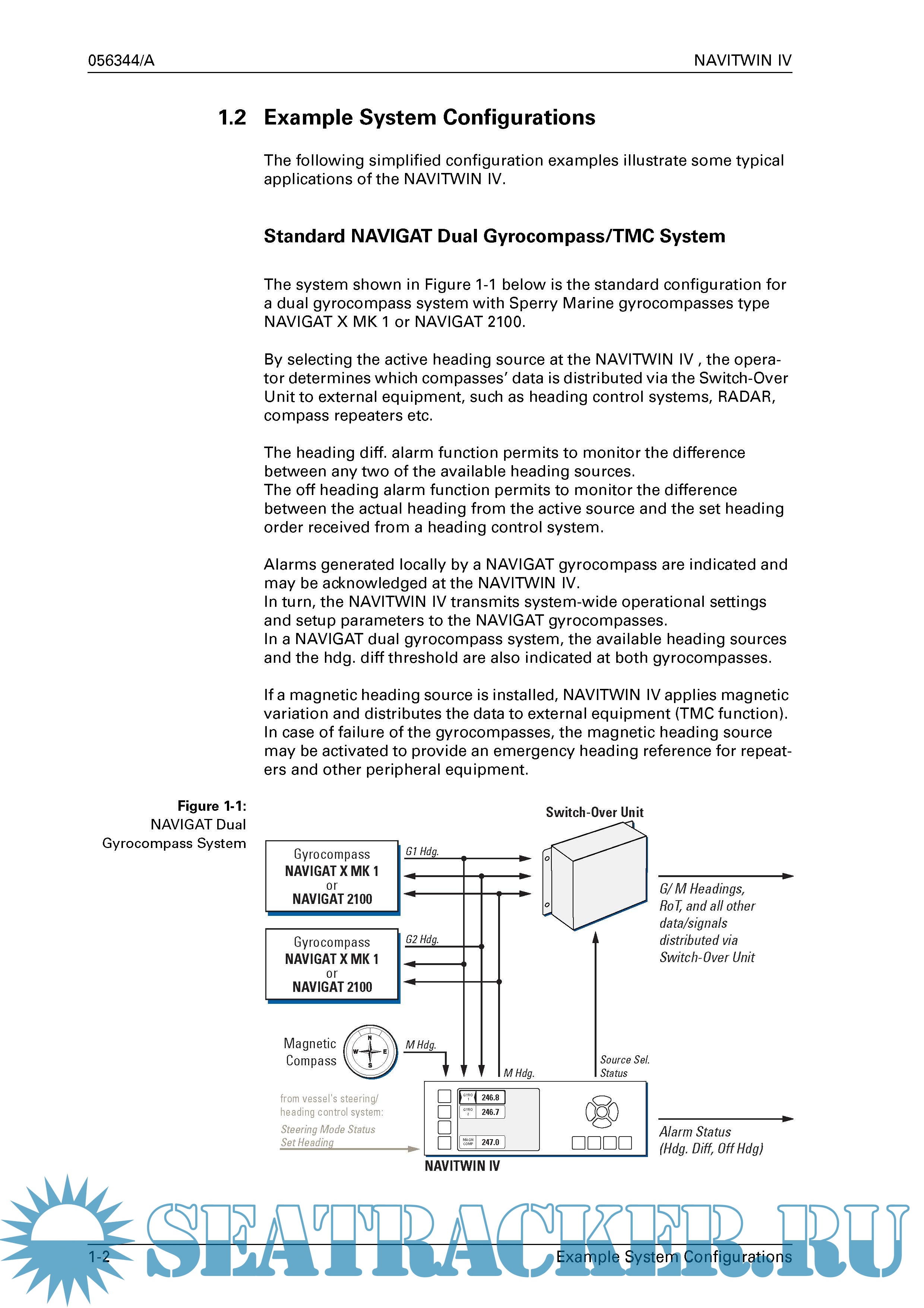

Description: The Heading Management System NAVITWIN IV performs a number of control and monitoring functions within a multicompass system:
• It displays the actual heading from the available heading sources and lets the operator select the active source for distribution to other equipment, e.g. heading control systems, RADAR, compass repeaters etc.
NAVITWIN IV can display up to three true heading and one magnetic compass heading source.
• It monitors the difference between any two of the available heading sources.

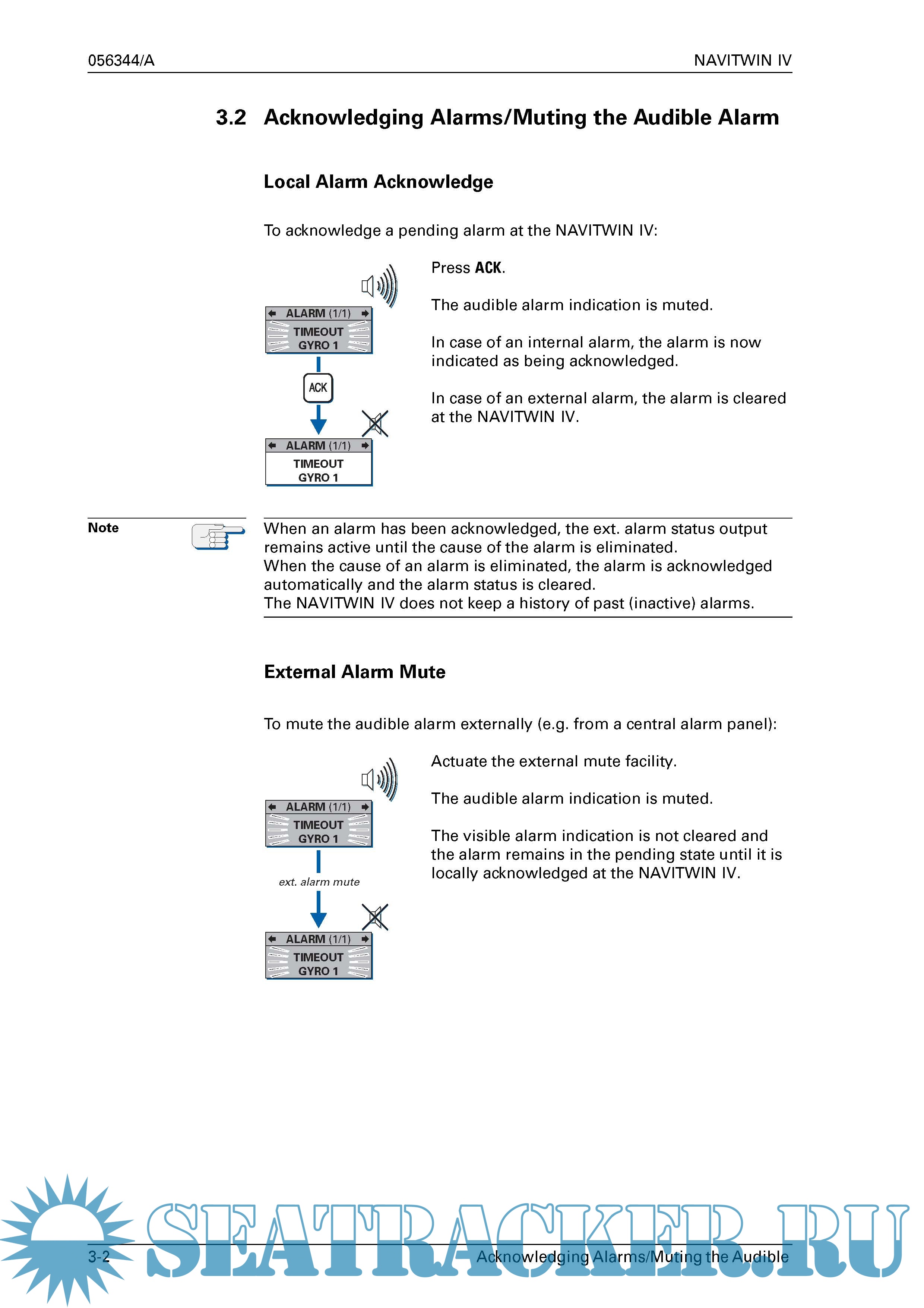

Should the difference exceed a user-defined threshold, a "Heading Difference Alarm" is given.
Sperry Marine NAVITWIN IV Heading Management System Operation, Installation and Service Manual.pdf
