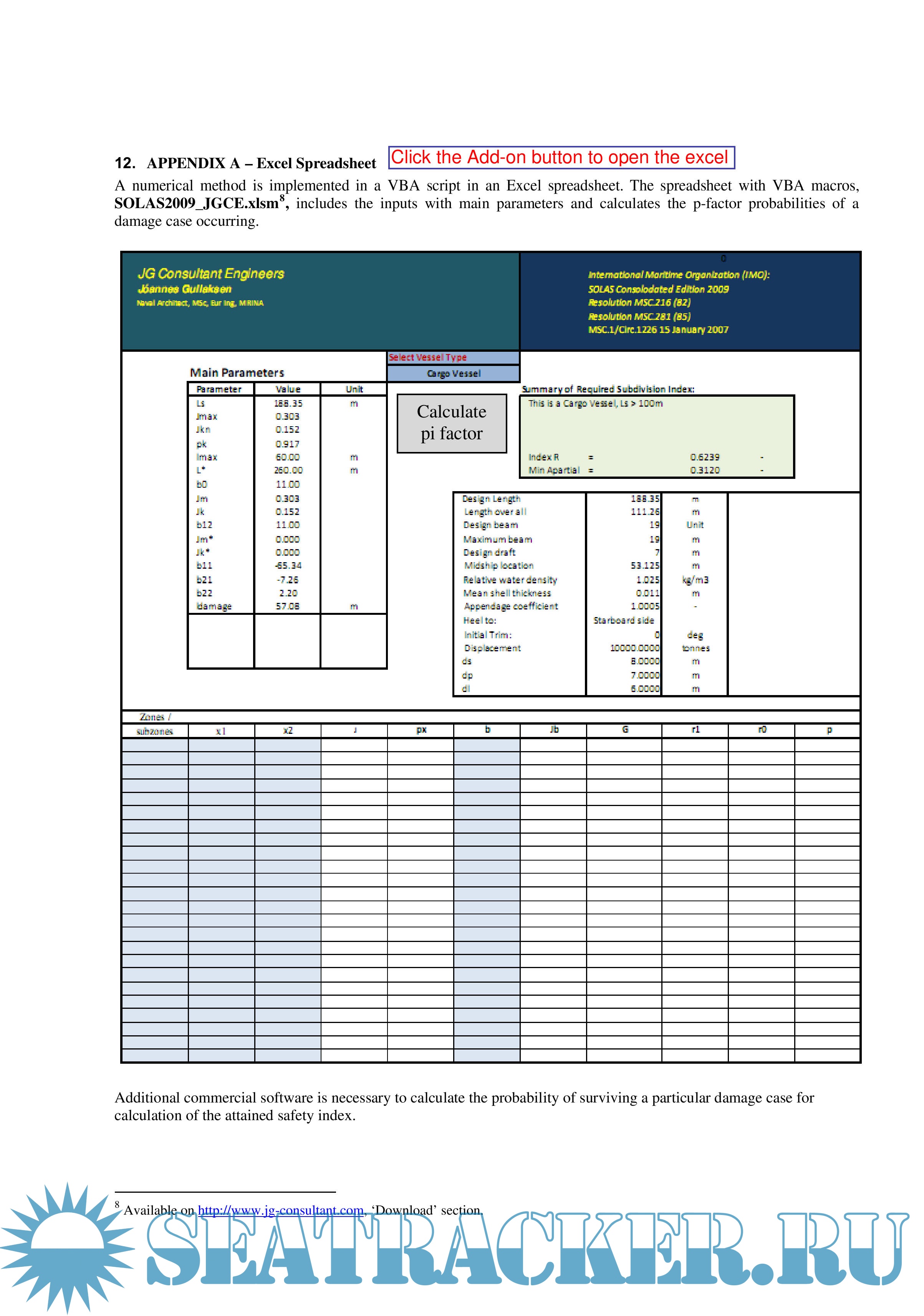

Included APPENDIX A_ Excel Spreadsheet:
A numerical method is implemented in a VBA script in an Excel spreadsheet. The spreadsheet with VBA macros, SOLAS2009_JGCE.xlsm8, includes the inputs with main parameters and calculates the p-factor probabilities of a damage case occurring.
