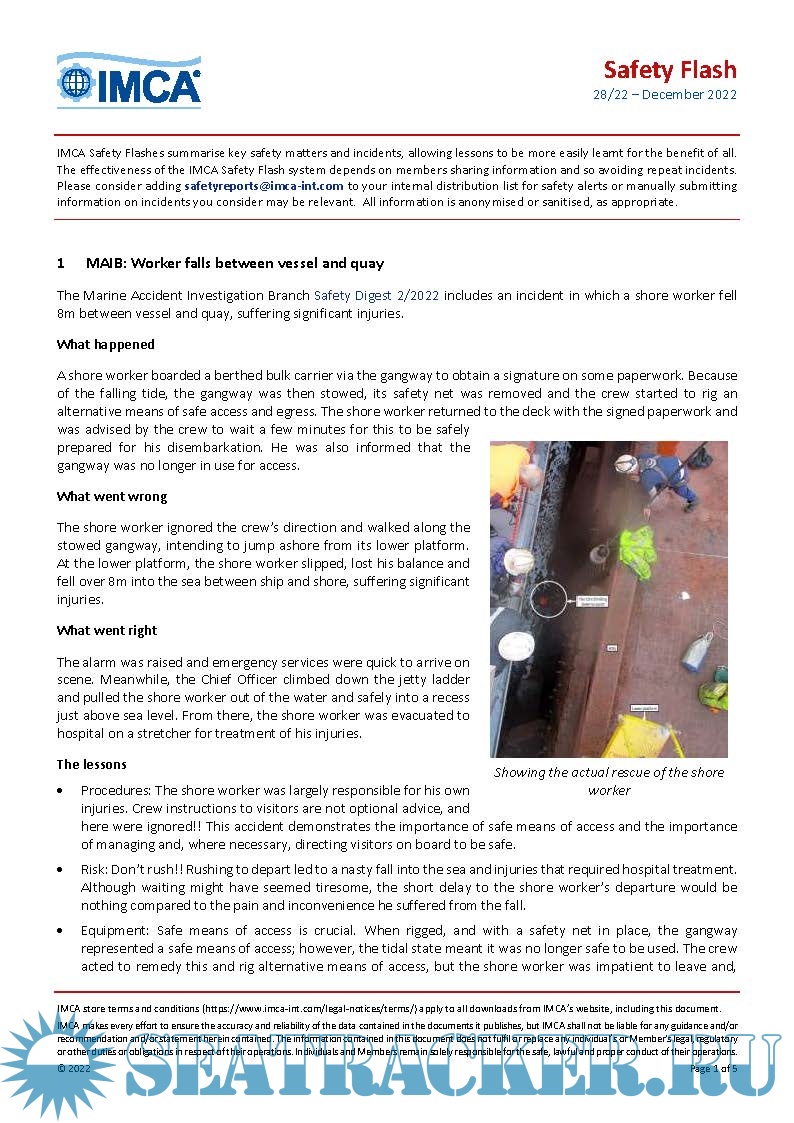

Description: The International Marine Contractors Association ( IMCA ) Safety Flashes disseminate importantinformation on incidents and potential hazards and the lessons learnt from them that can help prevent incidentsoccurring elsewhere in the industry.IMCA Safety Flashes and systems for incident reporting and analysis are an important tool for sharing vital information.By publishing them, IMCA helps its members around the world identify potential hazards, share lessons learned and avoid repetition.Safety Flashes should be succinct, specific, factually correct and written in clear language.The Secretariat will assist with this through formatting and checking of the material submitted.
Issue no. 28/22 December, 2022
IMCA SF 28/22
• MAIB: Worker falls between vessel and quay
• Accidental swallowing of paint thinners

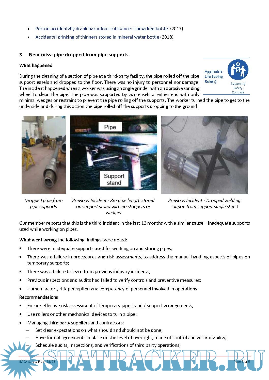

• Near miss: pipe dropped from pipe supports
• Oil tank sight glass push buttons wired open
• BSEE: Unsafe chemical use and disposal
