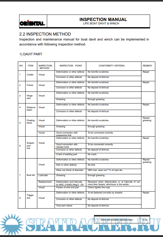

Lifeboat Davit and Winch Instruction Manual
Year: 2012
Author: Hyundai Samhao Heavy Industries Co., Ltd and Oriental Co.,Ltd
Pages count: 132
Description: This instruction manual is prepared in accordance with the MSC/Circ.1206 Guidelines for periodic Servicing and Maintenance of boat davit & winch. Annual check, servicing and repair should be performed by the ship’s crew in the presence of the manufacture’s repair tentative or a person appropriately trained and certified of the manufacturer for the work to be done. Please refer to the instruction and maintenance manual for boat davit & winch manufactured after the Reg. of SOLAS.
