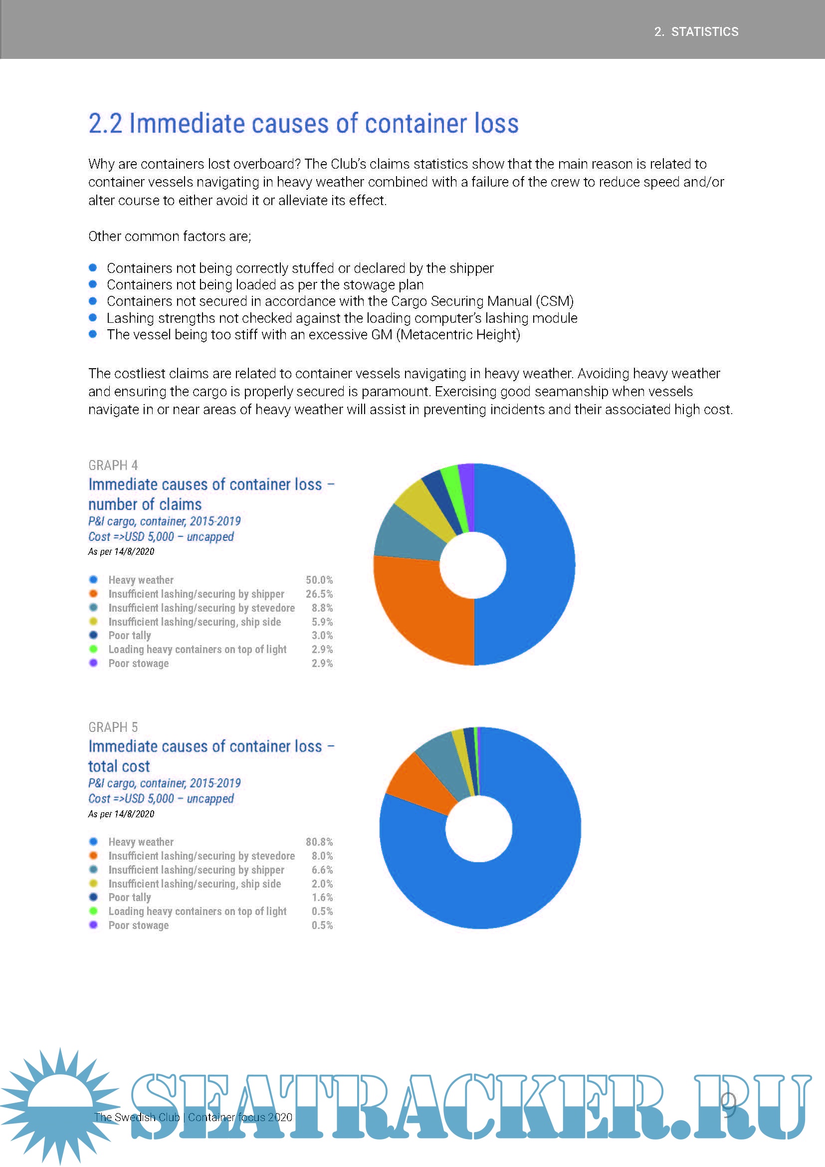

Description: • Sailing through heavy weather is the most common immediate cause for containers being lost overboard. Using weather routeing will improve the situation. Reducing speed and altering course will also help.

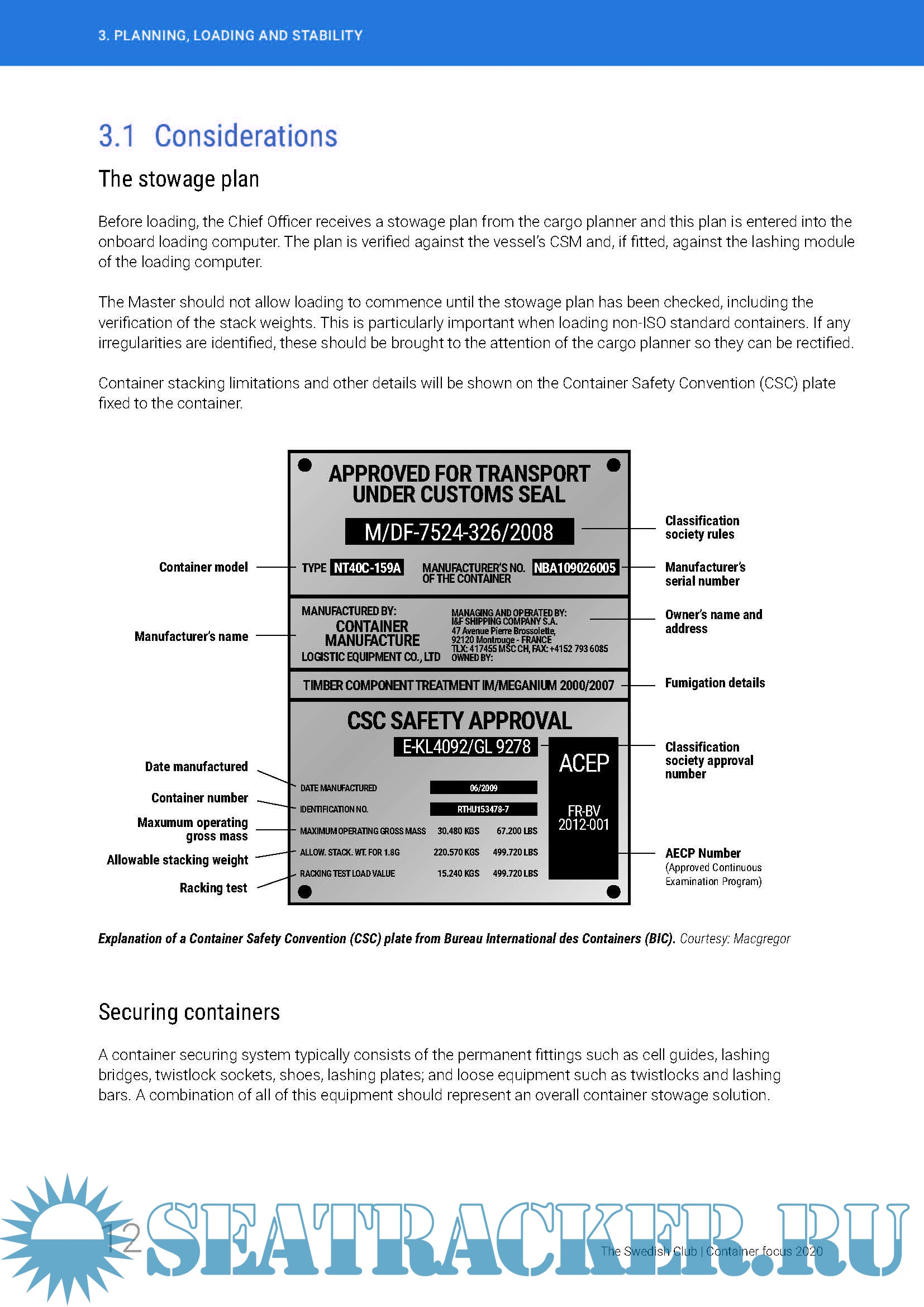

• When preparing a vessel for sea it is essential that the cargo is loaded as per the Cargo Securing Manual, which provides guidance on the stowage and securing of containers and nonstandardised cargo.
• In many of the cases that The Swedish Club has dealt with, an excessive GM has been one of the contributing factors. Particular attention must be paid to the vessel’s GM when sailing through heavy weather.
• There are also recurring issues with inadequate training.
• Misdeclared cargo is a common cause of lost containers and can lead to major losses
