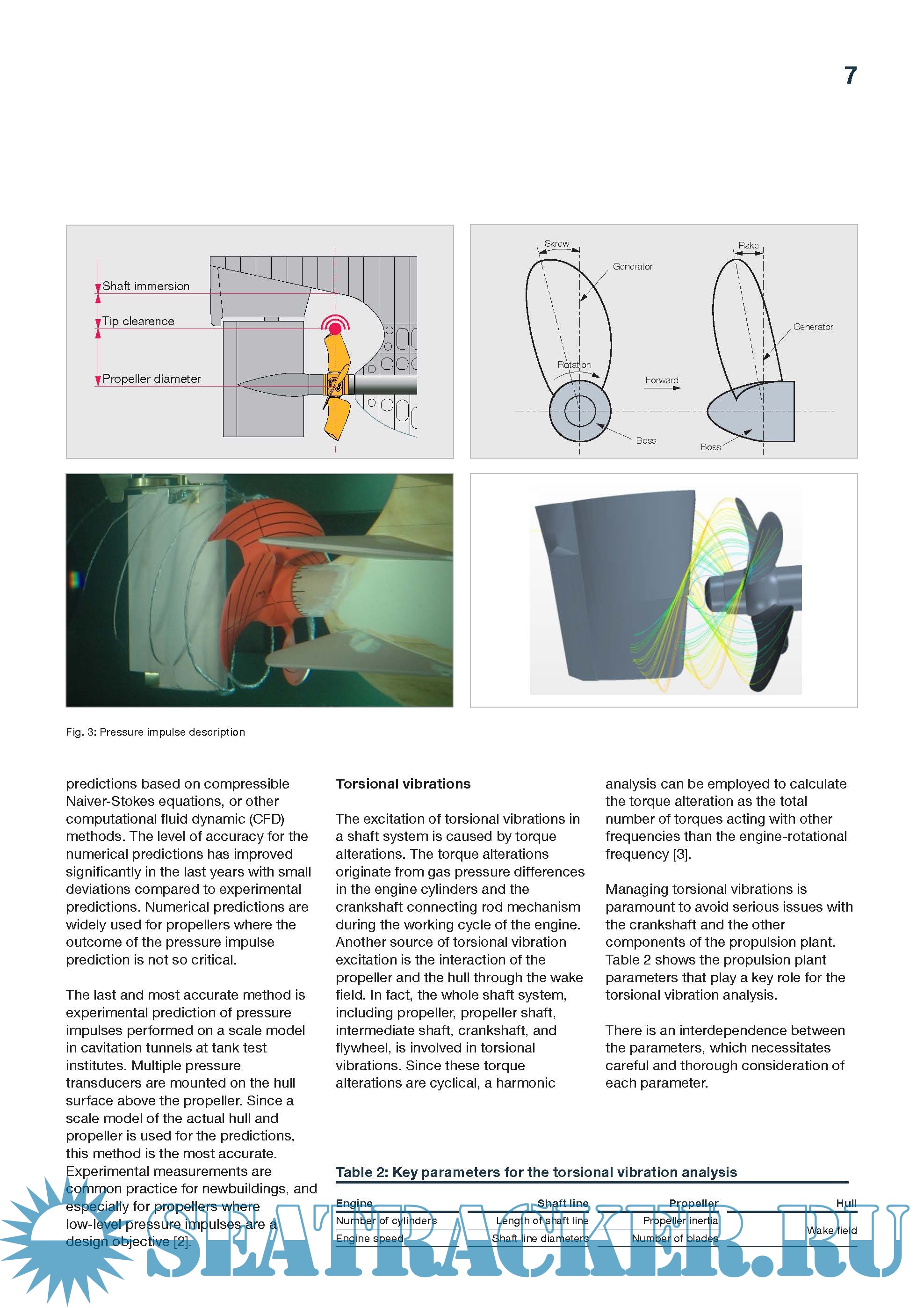

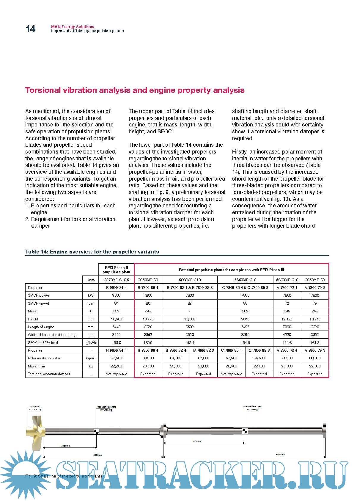

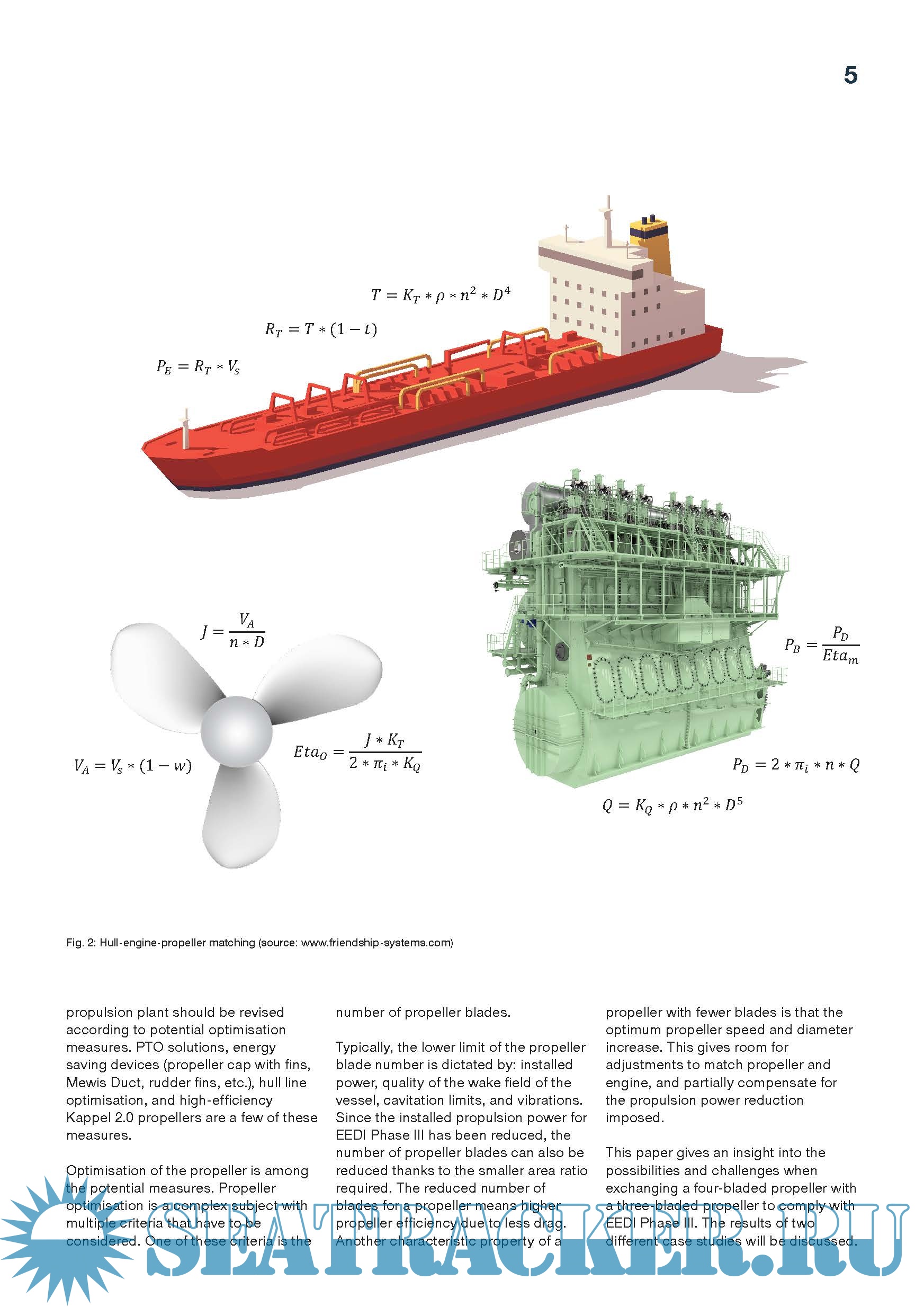

Description: The matching of hull, engine, and propeller has been challenged since the introduction of the EEDI phases, which calls for a propulsion power reduction. This paper explains how improved efficiency and reduced emissions can be achieved with three-bladed propellers, so that propulsion plants may comply with upcoming EEDI phases. The results of an investigation of torsional vibrations and surface hull pressure pulses are presented to provide a better overview of the interaction between hull and propeller. Two case studies, which include propeller optimisation studies, and analyses of torsional vibration and hull surface pressure pulses, are discussed to illustrate.
