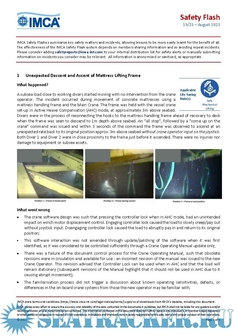

IMCA SF 19/23
- Unexpected Descent and Ascent of Mattress Lifting Frame

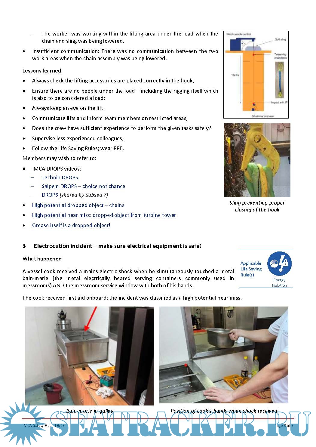

- High potential: dropped chain assembly
- Near miss with high pressure gas due to incorrect procedures
- Electrocution incident – make sure electrical equipment is safe!
