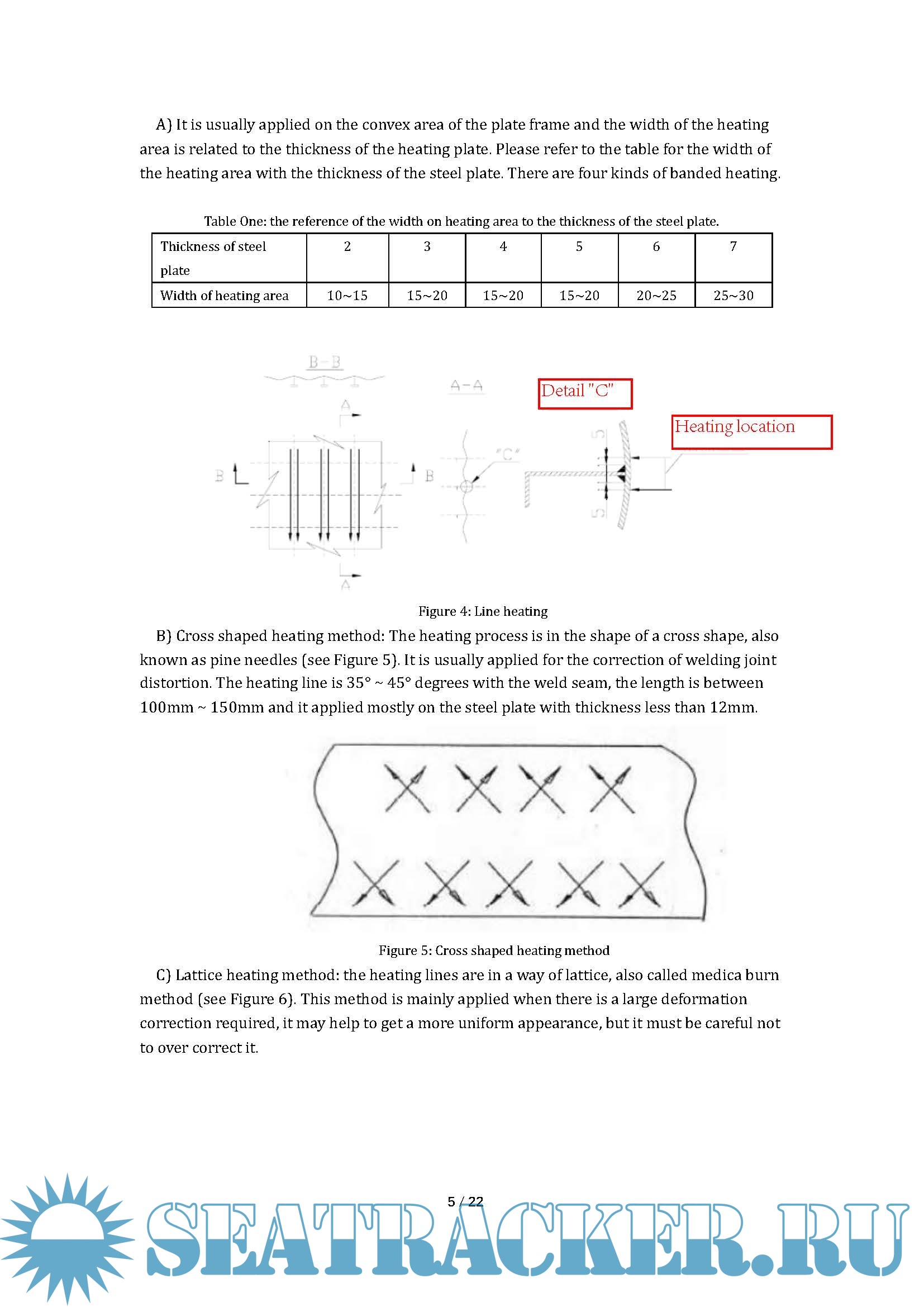

Description: This technique stipulates the principle and basic method of flaming correction of hull, heating/cooling methods for deformation rectification. Deformation correction on the stage of small and medium group members; large and general group; block erection, and the considerations of deformation correction by flame. This process is suitable for the deformation of the ship structure in the process of flame cutting and welding.
Deformation correction by flame is a way of eliminating the original deformation by heating on the local area of a metal and cause it to produce plastic deformation which is limited by the surrounded cold metal. The original deformation is therefore eliminated through the shrinkage deformation resulted in the cooling process of the steel.
