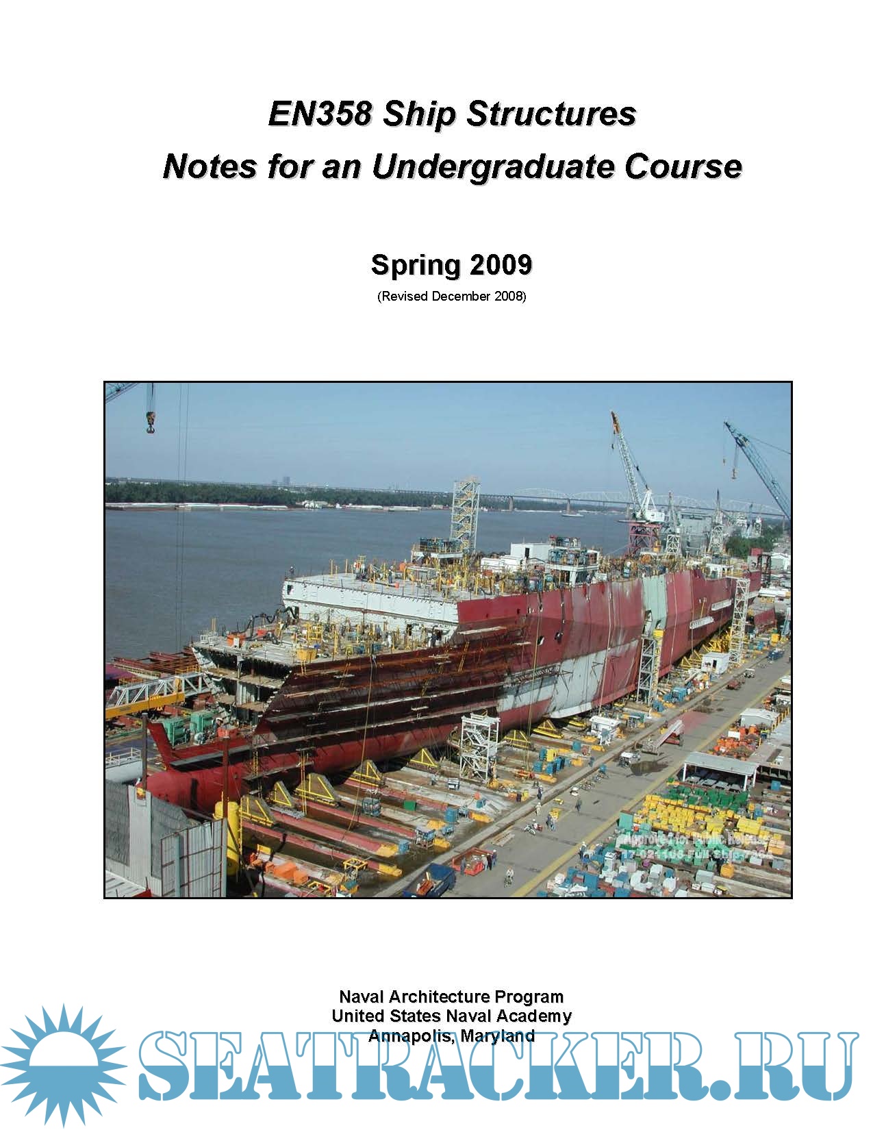

EN358 Ship Structures Notes for an Undergraduate Course
Year: 2008
Author: P.H. Miller & J.W. Stettler
Genre: Handbook
Pages count: 137

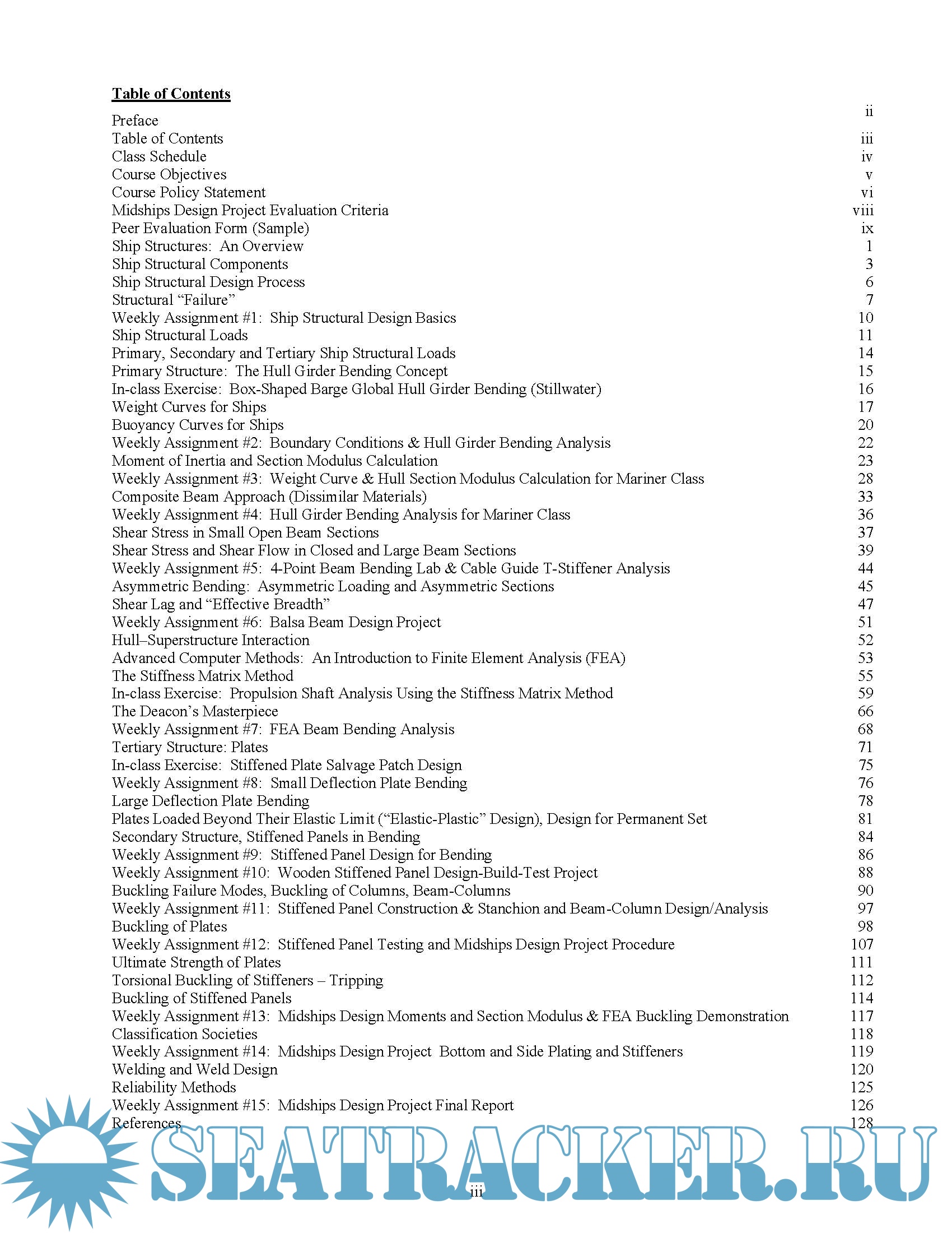

EN358 uses material previously learned in statics, dynamics, material science, strength of materials, stability and
buoyancy, and principles of naval architecture. Hopefully the student kept their texts and notes! These course notes are
designed to supplement material presented on the board and in Chapter 4 of the book, “Principles of Naval Architecture,
Vol. 1” (PNA). Included are administrative materials, the assignments, and basic notes. You should bring these notes to
every class and lab! The notes also have some questions, blank spaces for equations, and sample exercises which the
student should complete as a study aid. You should print these notes and put them in a 3-ring binder. Add in your work
and additional notes in the appropriate spots during the semester, and you will have a complete reference for ship
structural design!
