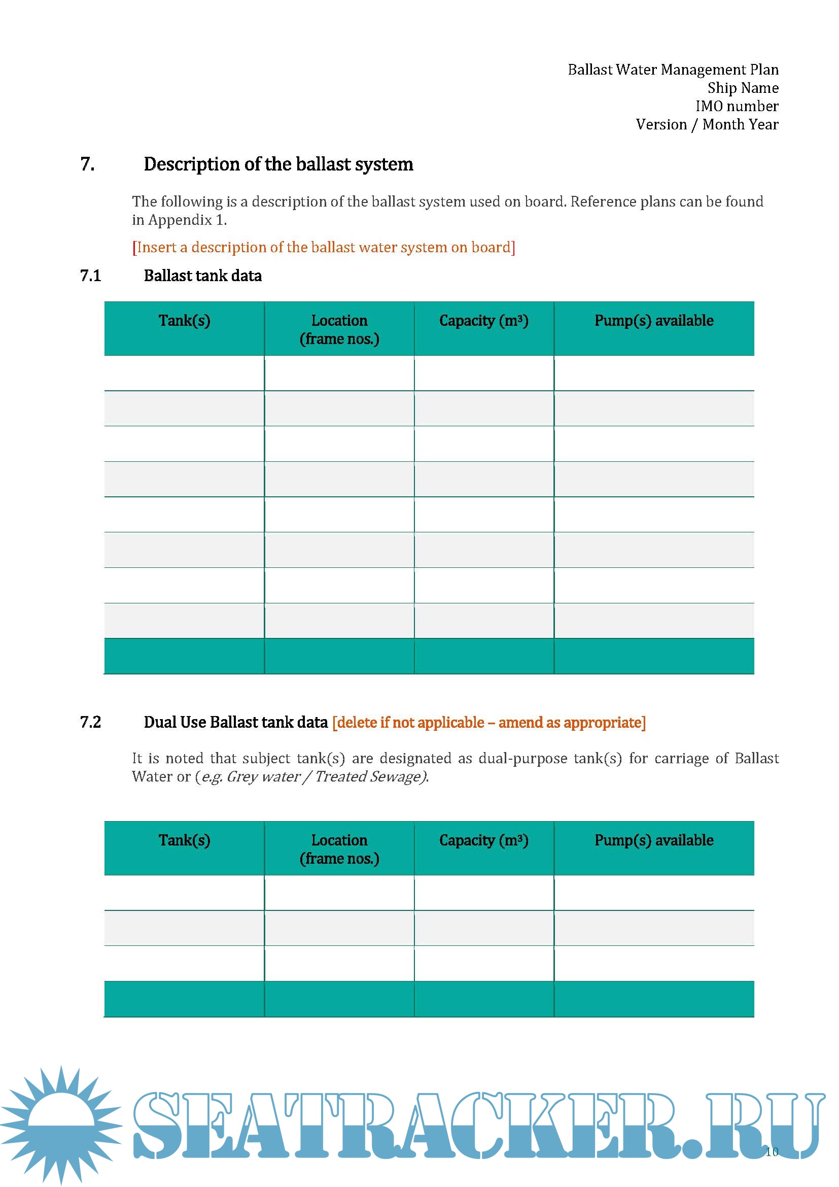

Description: Having an approved ballast water management plan (BWMP) onboard is a requirement of the BWM Convention (reg. B-1). LR can assist with approval of ballast water management plans (BWMP). Model BWMPs can be found in the resources section below, which can be used by operators as a template to create their ship-specific plan.
