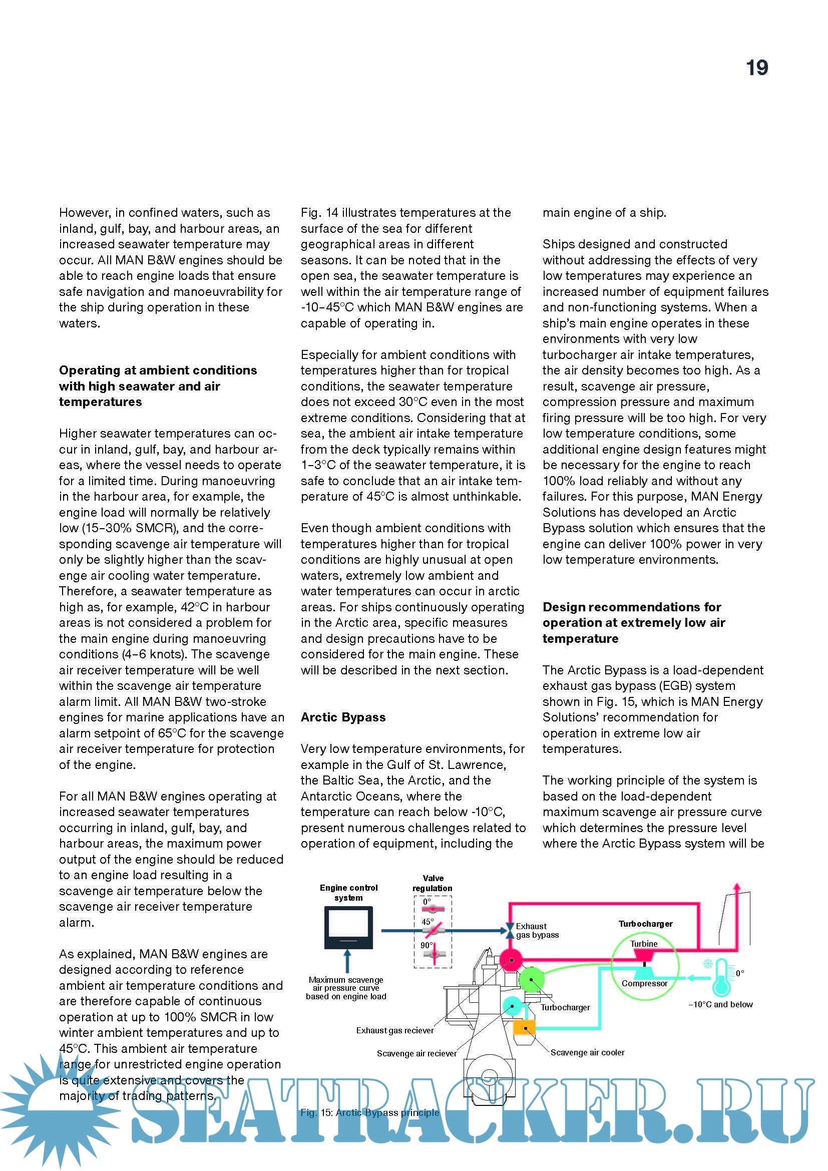

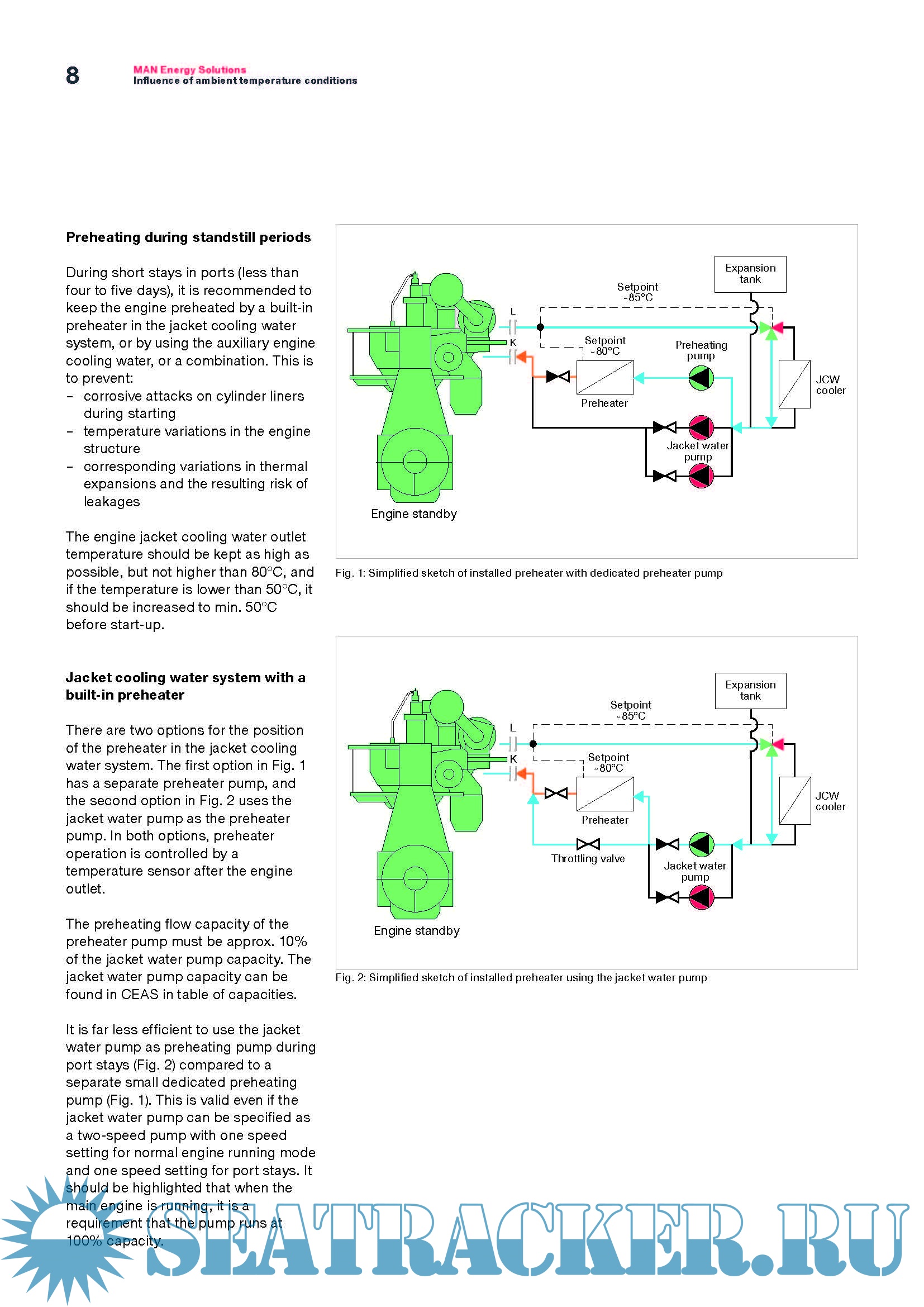

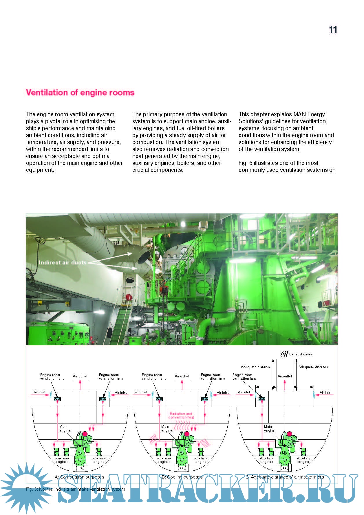

Description: This paper provides crucial guidance for marine two-stroke engine operation in varying climates. It covers engine start-up procedures, engine room ventilation, and operation in different conditions. It focuses on reference conditions set by the International Standard Organization (ISO) and the capabilities of MAN B&W engines to operate efficiently across a wide range of temperatures.
The study highlights the importance of cooling water temperature, scavenge air cooling, and the use of an Arctic Bypass system in extreme cold environments.
The paper also introduces the Economiser energy control (EEC) feature for increased service steam production in colder temperatures, demonstrating the adaptability of these engines to diverse climates. By following these recommendations, operators can ensure efficient and reliable engine performance, mitigating issues and extending the engine longevity.
