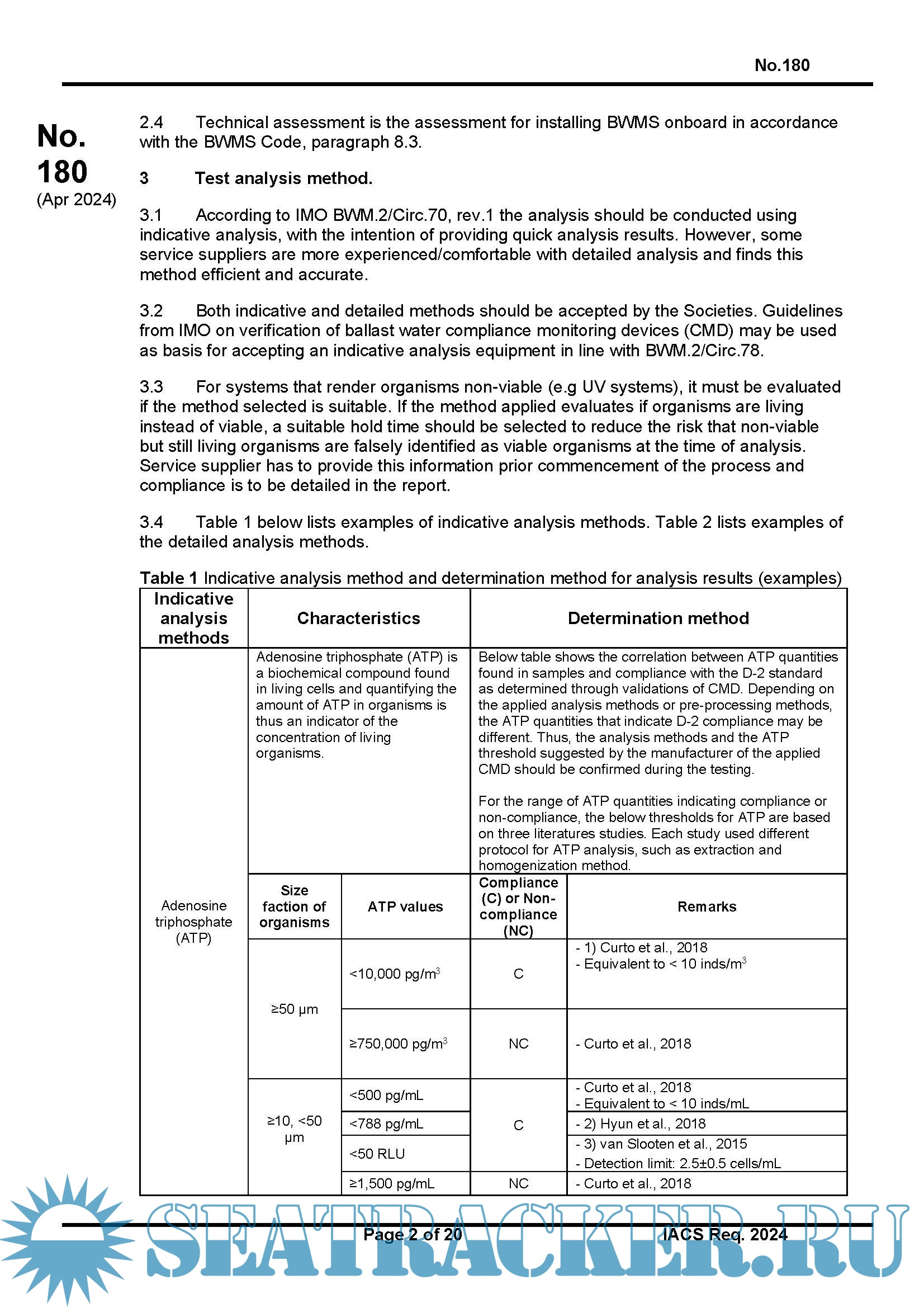

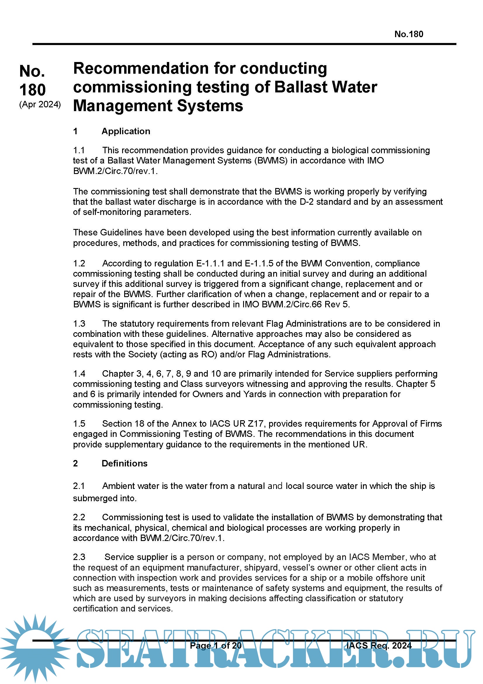

Description: Rec 180 – Recommendation for conducting commissioning testing of Ballast Water Management Systems – New April 2024. Resolutions.
This recommendation provides guidance for conducting a biological commissioning test of a Ballast Water Management Systems (BWMS) in accordance with IMO BWM.2/Circ.70/rev.1.
The commissioning test shall demonstrate that the BWMS is working properly by verifying that the ballast water discharge is in accordance with the D-2 standard and by an assessment of self-monitoring parameters. These Guidelines have been developed using the best information currently available on procedures, methods, and practices for commissioning testing of BWMS.
