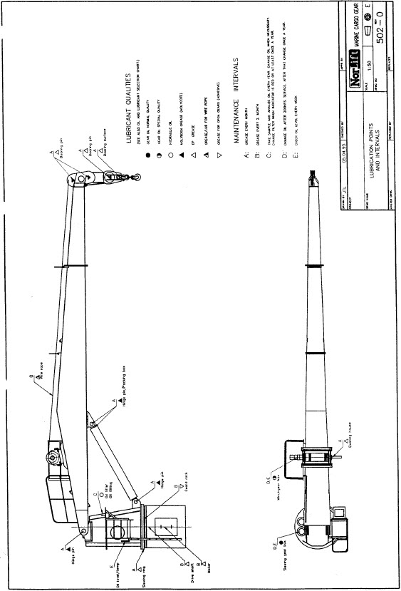

Marine Cargo Crane GPS 250-0818
Year: 2007
Author: Norlift
Genre: GENERAL PURPOSE CARGO CRANE TECHNICAL SPECIFICATIONS
Publisher: Norlift
Quality: OCR with errors
Number of pages: 41
Description: The crane is controlled remotely from a portable control box permanently hooked up to the crane slewing column.

CRANE TECHNICAL SPECIFICATIONS CONTENTS
ELECTRO HYDRAULIC
DRIVE SYSTEM
DESIGN RULES
DESIGN TEMP
MAIN DATA
