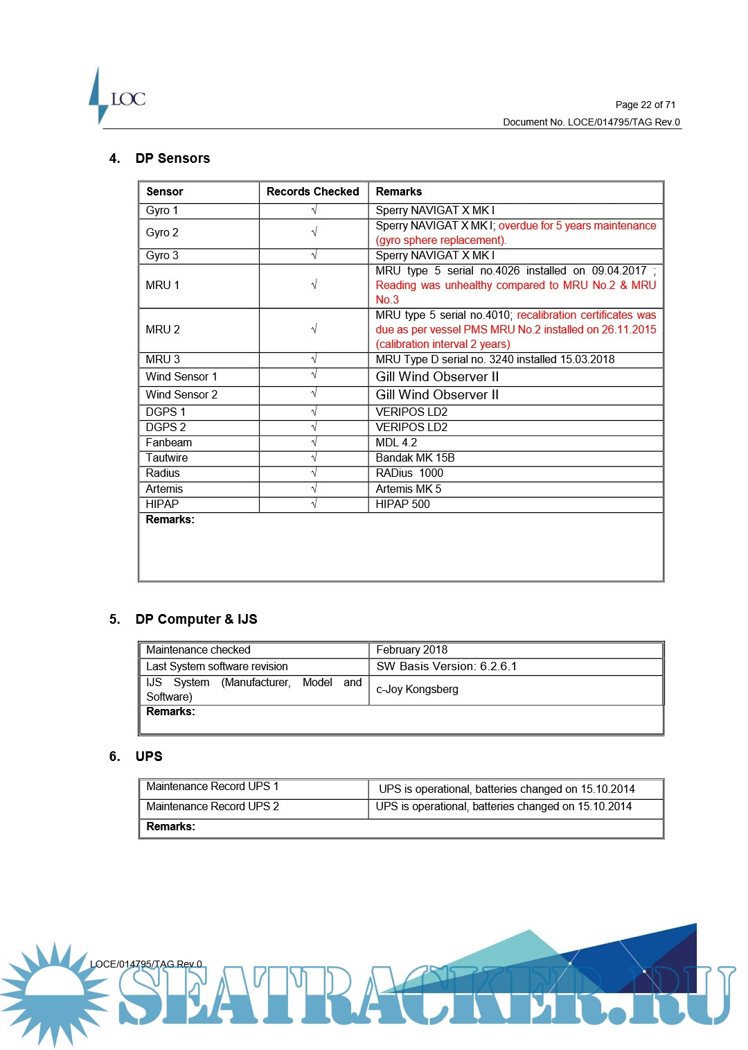

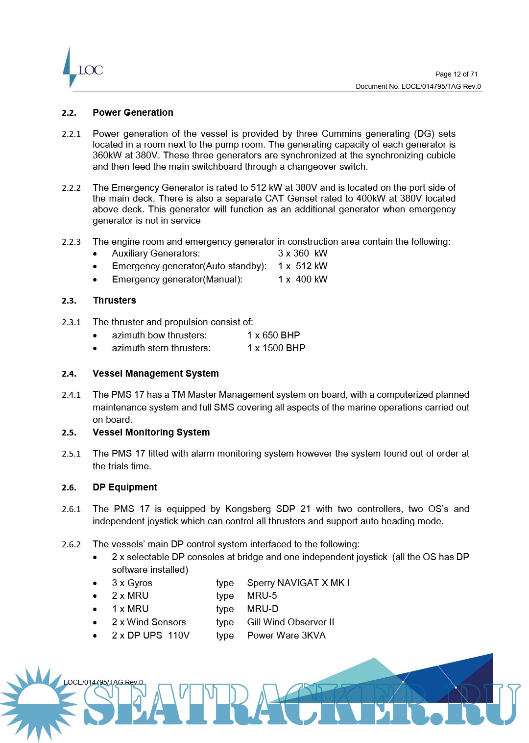

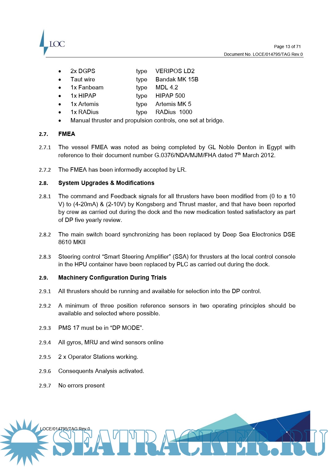

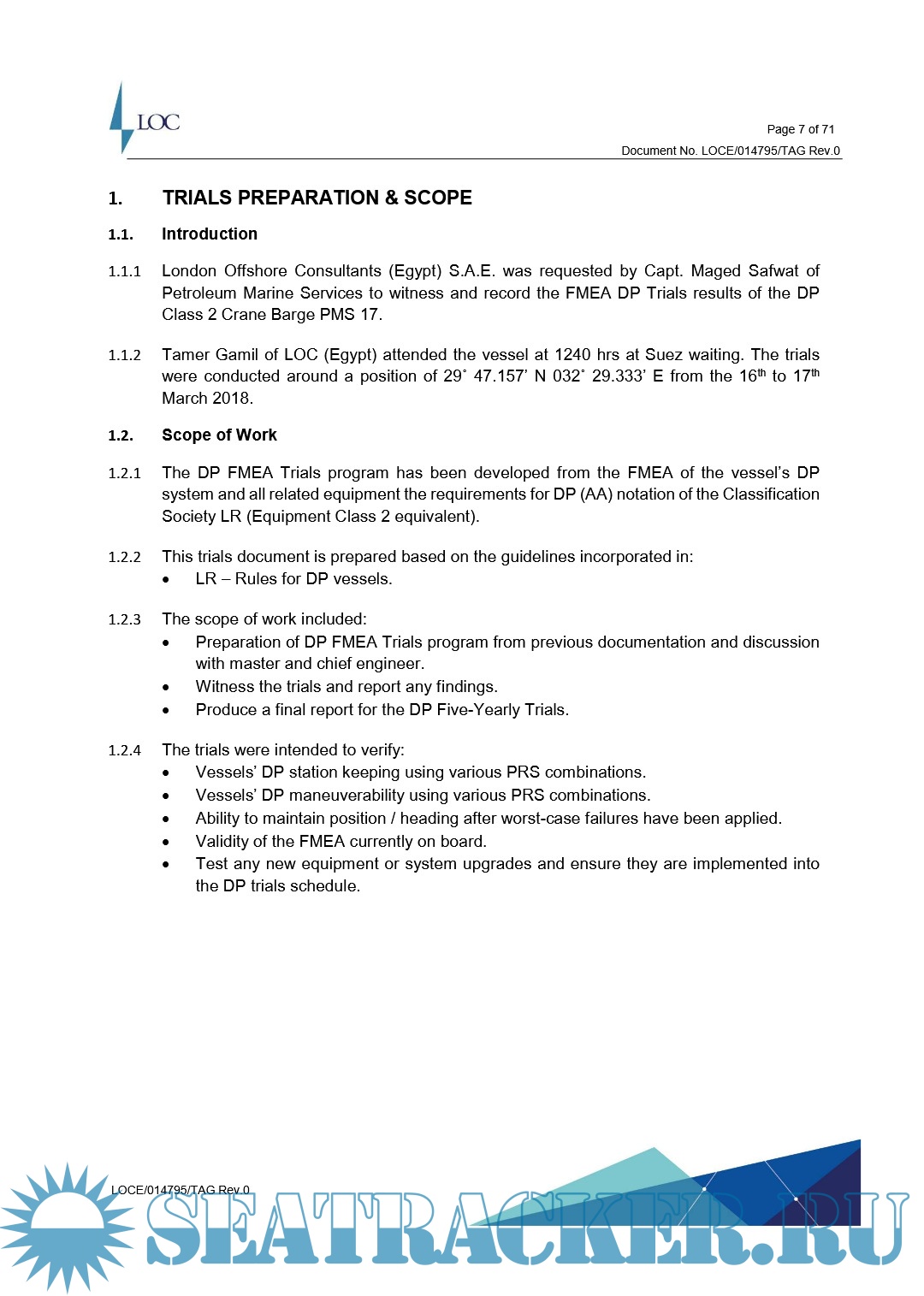

Description: London Offshore Consultants (Egypt) S.A.E. was requested by Capt. Maged Safwat of Petroleum Marine Services to witness and record the FMEA DP Trials results of the DP Class 2 Crane barge PMS 17.
Tamer Gamil of LOC (Egypt) attended the vessel at 1240 hrs at Suez waiting area. The trials were conducted around a position of 29˚ 47.157’ N 032˚ 29.333’ E from the 16th to 17th March 2018 in accordance with the FMEA trials document.
All trials were coordinated by the Captain and witnessed by Tamer Gamil of LOC (Egypt).
On the basis of the trials results, the vessel is considered fit to carry out operations equivalent to IMO DP Equipment Class 2 and DP(AA) as assigned by LR within its defined operating limits when the DP system is configured as tested during trials and noted in section 2.9 of this report.

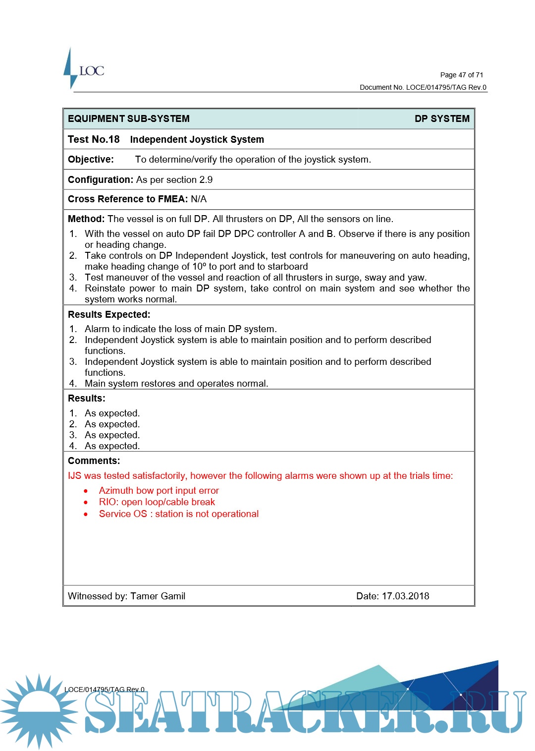

Test no.17 DP controller and os’s failures ........................... 46
Test no.18 Independent joystick system ............................... 47
