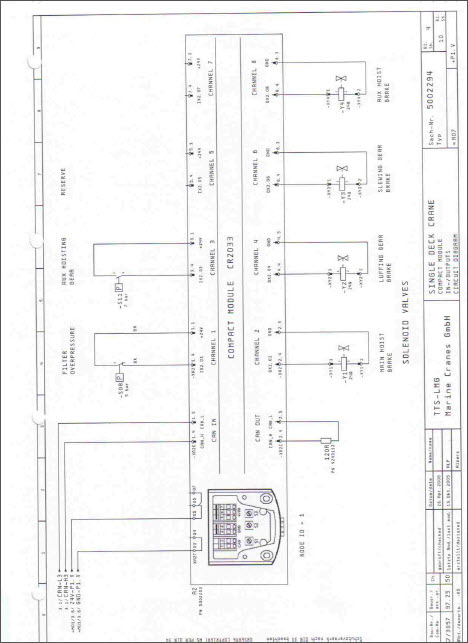

The main status of the PLC-system is indicated by LED's on the main controller and on the input and output Compact Modules.
When the system is running in good order the green LED is blinking with a 2 Hz signal.
Detailed information about the status indication is given in the hardware description of the PLC components.
The signal status of each input and output on the Compact Modules is also indicated by a LED.
5.7.1.3 ADDITIONAL INDICATIONS
Detailed information about the input- output-status or value will be displayed, if the corresponding indication sheet is selected, e.g.:
DRIVE VALUES potentiometer value, setup value, nominal / actual speed value
SENSOR VALUES digital inputs and outputs (TRUE / FALSE)
analogue inputs (current or voltage) current outputs (PWM value in mA)
COUNTER VALUES position of the drive and drive speed
By calls of this information you are able to check a lot of relevant system data, e.g. it is possible to check the status of an input or a sensor value (output current) will be read into the PLC.
Procedure:
• Set MAIN MENU
• Select INDICATIONS
Choose the required information

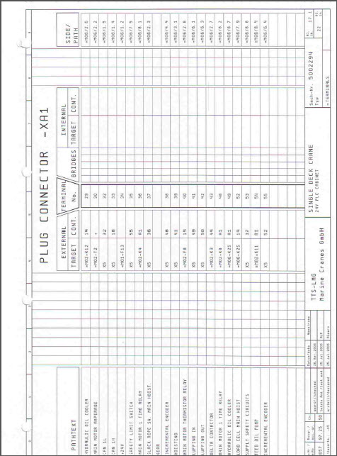

The PLC inputs that have some bearing on safety are polled to ensure that their status is correct when the crane control system is switched on. If this message occurs, it means that an extraneous voltage is reaching one of the inputs (possibly due to contact between wires or a creep voltage caused by moisture) or that the corresponding PLC input itself is defective.
The actual input status can be displayed:
. Set MAIN MENU
• Select INPUT / OUTPUT VALUES
• Select DIGITAL INPUTS (select the corresponding input according to the circuit diagram)
The status of the inputs is displayed with <TRUE> or <FALSE>.
TRUE = DC 24V, FALSE = no voltage signal
Remedial action:
- Check the contact of the displayed circuit line, e.g. F0015 indicates voltage at input 1X4.01, although the contact of the pressure switch =M07-S10 must be open.
- Eliminate the extraneous voltage, if present.
- Exchange the PLC or the corresponding Compact Module.

1010 HOISTING PRESSURE <7bar
The pressures in the hoisting gear hydraulic circuits are monitored by switches =M07-S10 / -S11. Fault signal appears on the display if the pressure drops below 7 bar.
• Set MAIN MENU
Remedial action:
- Check the hydraulic pressure by measuring it with a pressure gauge. (Cf. specification of the hydraulic system.)
- Measure the characteristics of the switch and replace as necessary.
- Check the wiring.
- (Status must be <TRUE> when the pump drive is running.)
1020
HOISTING PRESSURE <>15bar
This fault message appears if pressure sensor =M07-B10 / -B11 (hoisting gears) malfunctions.
If the booster pump drive is not active, the sensor must read a pressure value <15 bar.
If the booster pump drive is activated, the sensor must read a pressure value >15 bar.
The output current from the pressure sensor must be about 4.8 mA while the pump is running (cf. specification of the pressure sensor.
The actual sensor output value can be displayed:
• Set MAIN MENU
• Select ANALOGUE INPUTS
The value of the sensor is displayed in iiA and bar.
Remedial action:
- Check pressure sensor =M07-B10 / -B11.
- e.g. interchange the hoisting pressure sensor against the luffing pressure sensor, if the failure is now displayed in the luffing circuit, then the pressure sensor itself or the connector cable is defective.

F 1080 HOISTING PWM-OUTPUT FAILURE =M07-A3
F 1081 HOISTING PWM-OUTPUT FAILURE =M07-A7
The control current for the proportional solenoid vales of the pump is generated in the Compact Module by Pulse Width Modulation. Fault message appears when no control current measurement (actual value) is taken although the corresponding PWM output is activated by the nominal value .
The drive condition can be displayed:
• Set MAIN MENU
. Select DRIVE VALUES
Remedial action:
- Check the wiring to the solenoid valve.
- Check the resistance of the solenoid coil, (approx. 24-30Q)
- Replace the PLC or the Cabinet Module.
