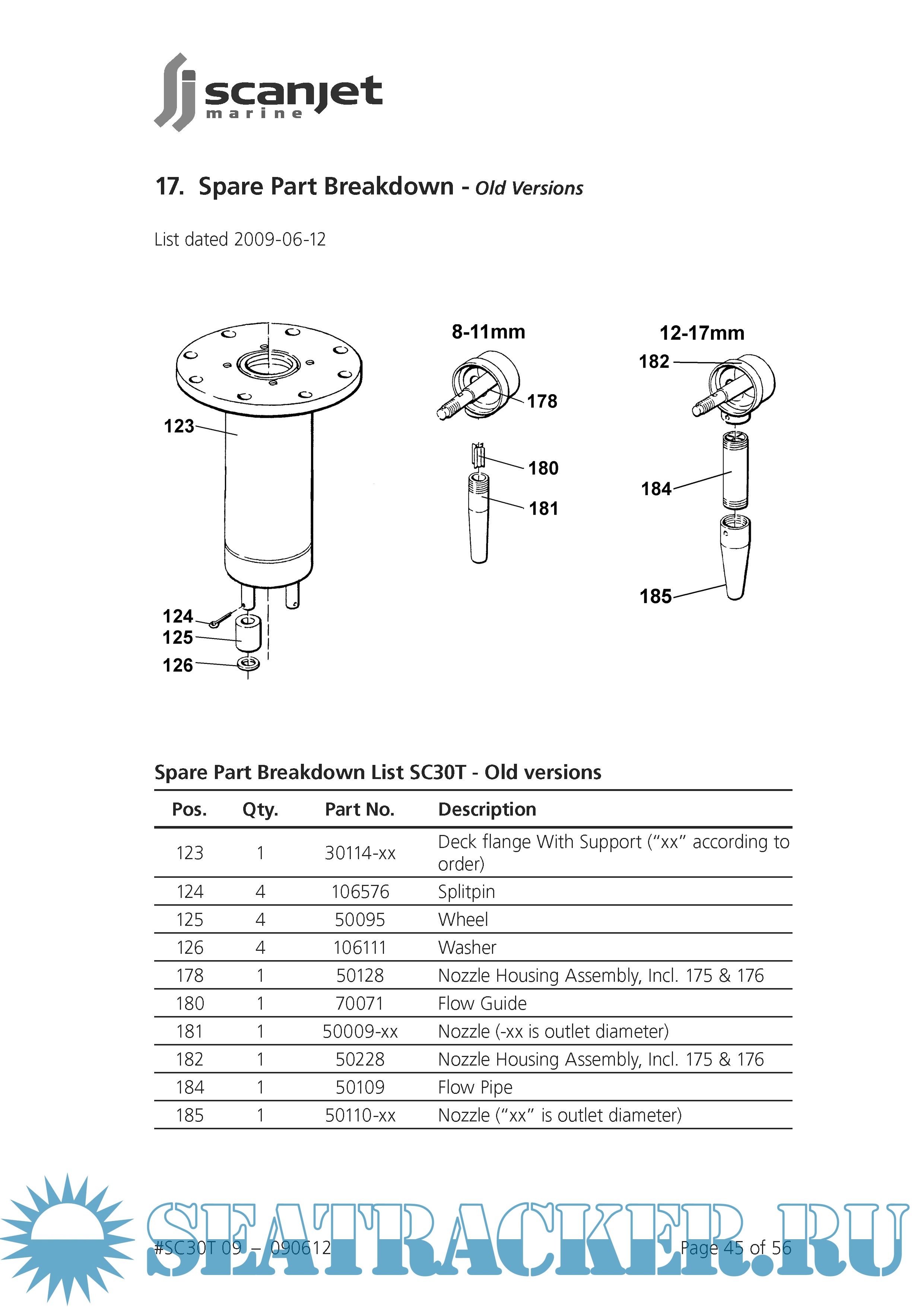

ScanJet SC 30T Instruction Manual
Year: 2009
Author: www.scanjet.se
Pages count: 56

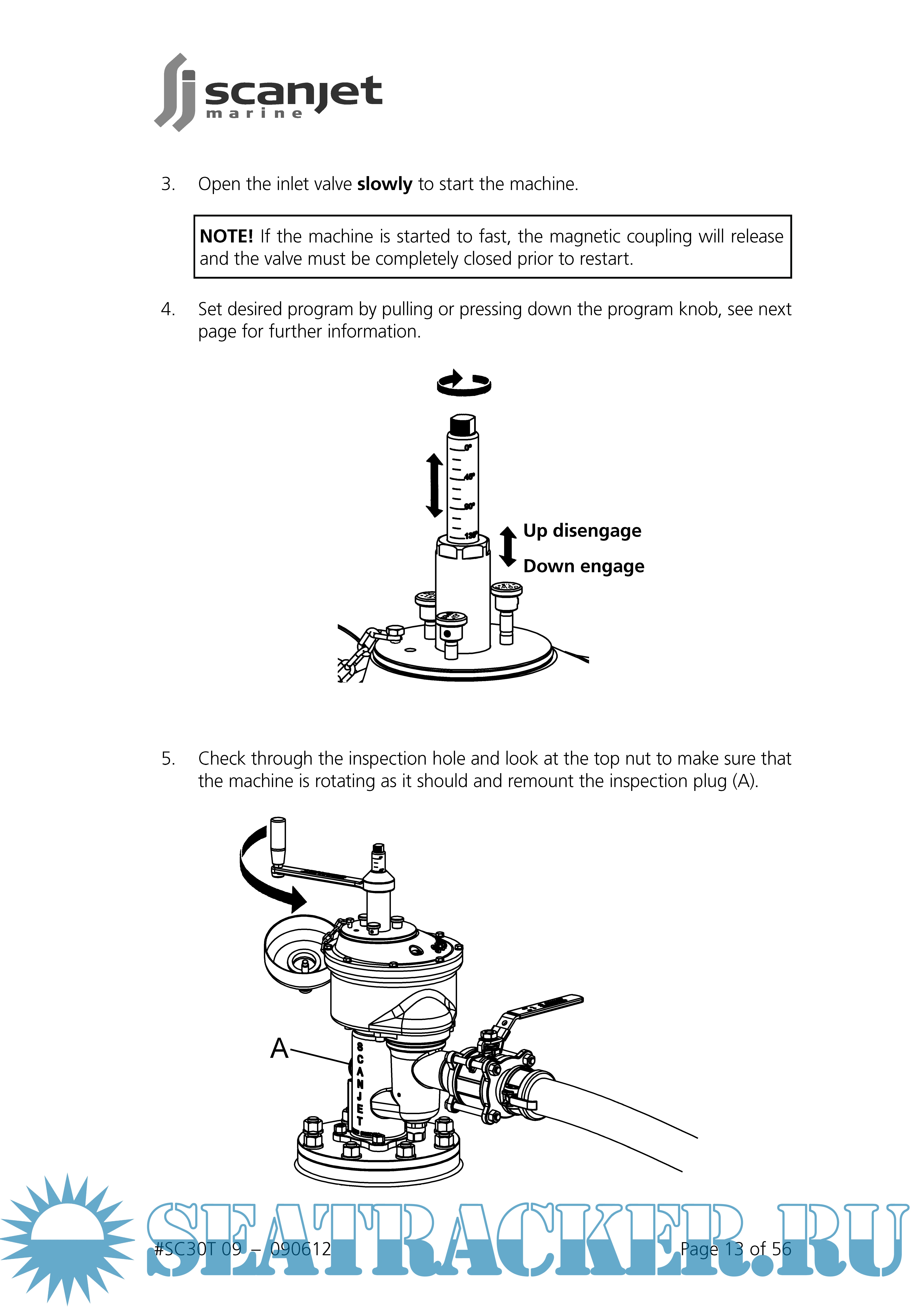

Description: SCANJET model SC30T is a tank cleaning machine specially developed for cleaning
of cargo and slop tanks on board chemical/product carriers. The size, construction
and cleaning requirements of these tanks are design criteria, which have been
evaluated prior to installation in your vessel.

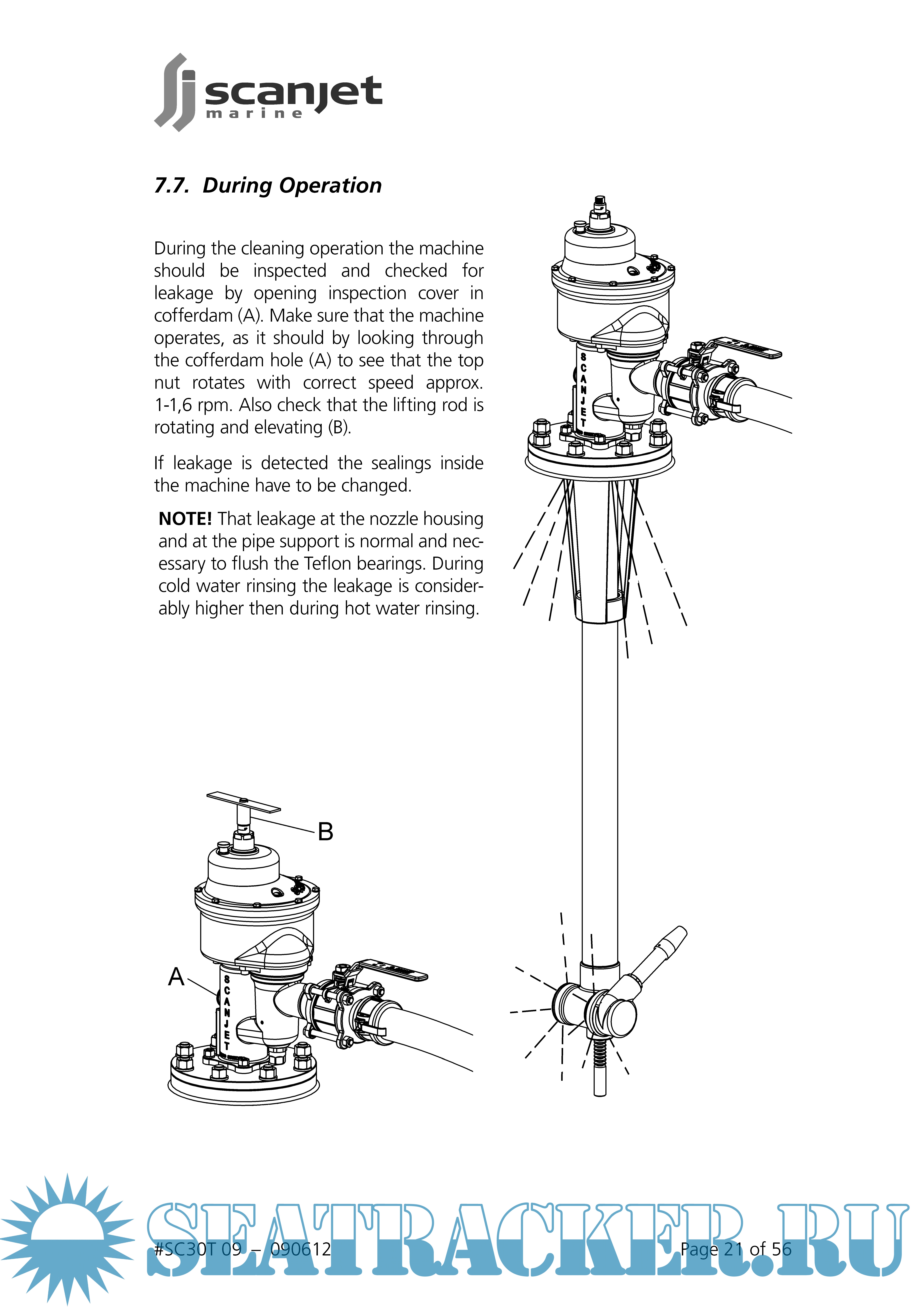

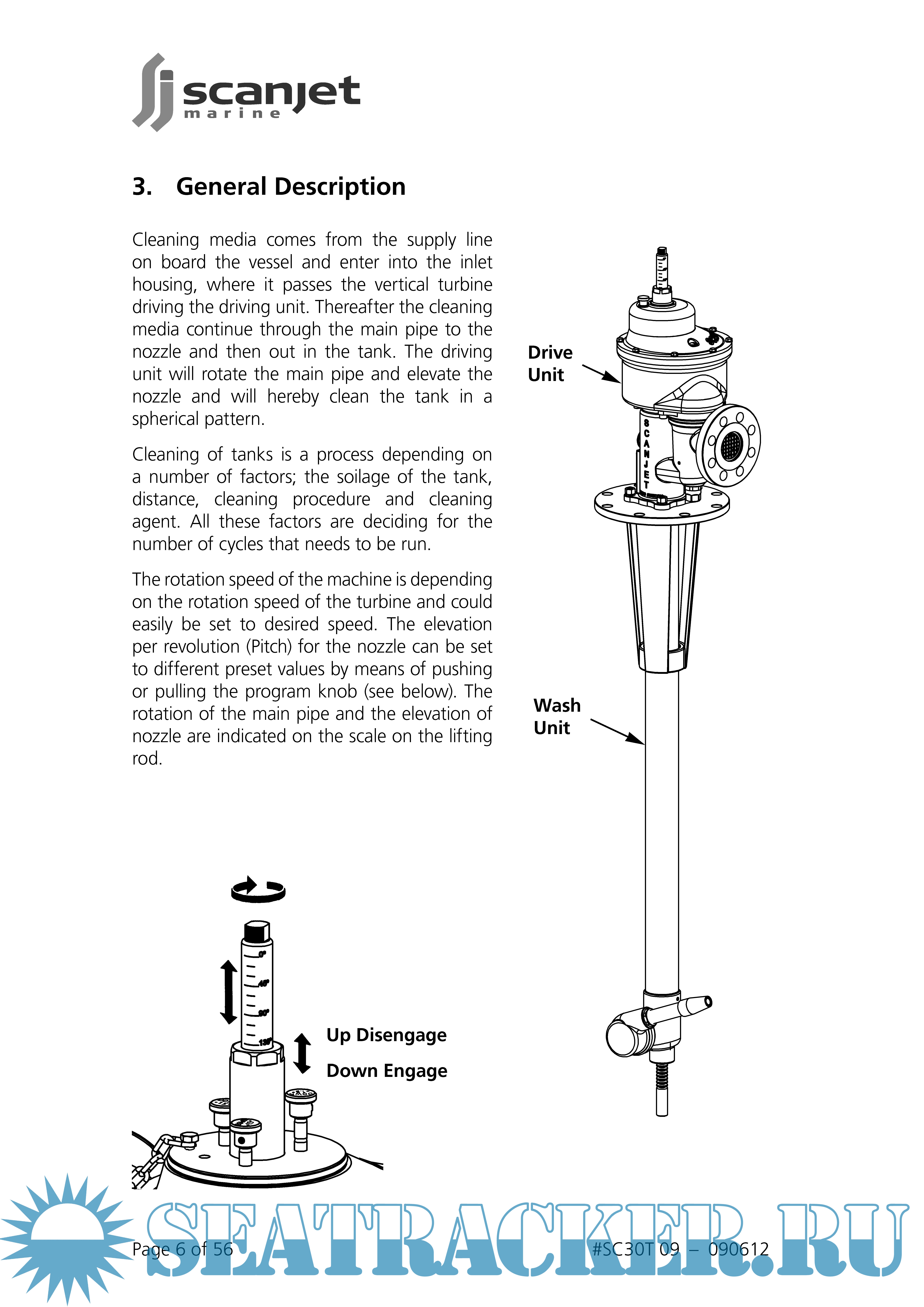

SC30T tank cleaning machine consists of two main parts; a washing unit that is
fixed installed in deck and a turbine driven drive unit. The cleaning procedure will
start by opening the valve for cleaning media. The drive unit will now turn the
main pipe and lift the nozzle creating a horizontal spiral-cleaning pattern. When the
cleaning procedure is finalized the valve is to be closed.
This manual has been prepared as a guide for the persons who will be operating
and maintaining your tank cleaning machine. The key for long life for your tank
cleaning machine will always be a system of carefully planned maintenance. Your
tank cleaning machine is actually doing a rough and dirty job for you. Keep up the
maintenance and the Scanjet SC30T will keep servicing you for many years.
