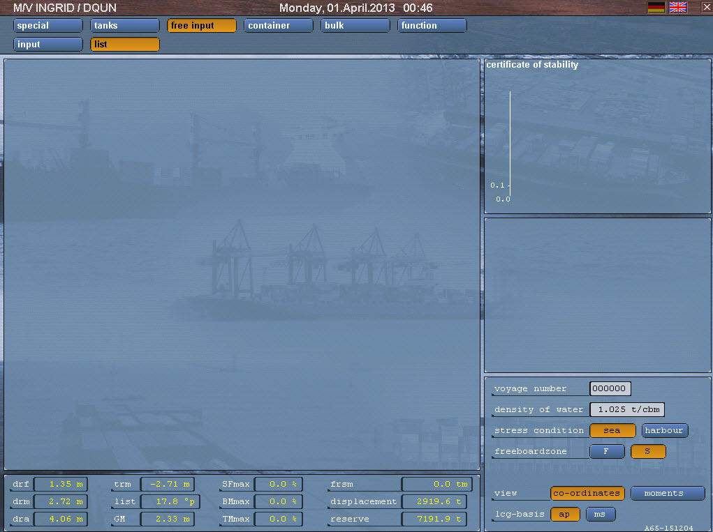

After starting the program by clicking on the COLOS start button on the PC’s desktop the main window appears on the screen.
This window is showing the head line, indicating the ship’s name, call sign, current name of load case, the date and time, the buttons to switch between the English and German language and to end the program.
Below the head line the eight (8) main menu buttons (“special”, “tanks”, “free input”, “container”, “bulk/grain”, “special cargo”, “timber”, “function”) are visible.
By clicking on one of the eight main menu buttons further sub menu buttons will appear on the screen.
On the right third of the main window three separate display fields are visible. The contents of the upper two fields can be changed by a click on the right mouse button in the appropriate field. The following display variations are available:
“certificate of stability”, “position afloat”, “tank graphic”, “shear forces & bending moments”, cross & torsion moments”, “blanc” or “grain stability”.
The lower right field is self explaining. The version number of the program is indicated in this field in the right lower corner (B74150704 - important if problems occur and service is required).
The big and blanc main field displays the different program functions when clicking on one of the main or sub menu buttons.
The field below is also self explaining. All described fields are permanent visible nevertheless witch program functions dependent on the choice of menu item are shown in the big field.

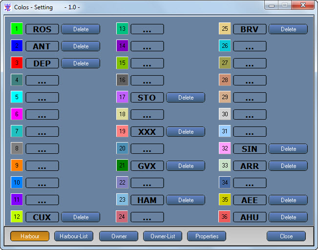

By clicking on this button it is possible to load container either by the spin buttons (up/down) or directly by keyboard as described in chapter 4.
Procedure:
1. Click on the desired bay displayed in the longitudinal profile of the vessel - the reference bay will appear green.
2. Choose the container size by activating the appropriate button by mouse click (compulsory to transfer all info of each single container to the layer plan = “bird view”, tier wise).
3. Activate the desired info button concerning weight etc. by mouse click and make your entries.
4. Click in the desired container stowage place to load the container.
It is possible to load the whole hold and on deck tier by tier by clicking on the shown button .
The default setting for “(vertical) centre of gravity” is 0,50m). It can be changed by the spin buttons (up/down) in 0,05 m steps. Be aware that all stability calculations are based on this setting! Be careful if you want to adjust values less than 0,45m !!
The colour of the letter codes for loading/discharging port and owner can be changed/added/deleted by starting the program setting by clicking on the appropriate symbol in the folder “C:\colos_win”.

7.6.2 list
If you press this button the main window will change to the below shown display.
By this function you can print out (see chapter 5.) a summary of all cargo pieces (colli) concerning weight, co-ordinates respective moments etc..
By clicking on the button “co-ordinates” the centre of gravity of each collo in x-, y- and z- direction will be displayed on the screen and printed.
By clicking on the button “moments” the product out of weight and x-, y- or z- co-ordinate of each collo will be displayed!
