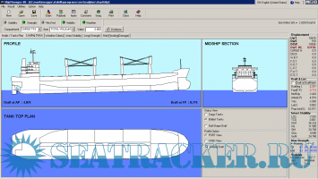

Description: Leading the trend of shipboard calculation, data processing, ship shore communication and vessel automation, Techmarine Co., Ltd., provides you with modern microprocessor-based loading computer, "SHIP MANAGER", which carries extremely powerful loading calculation and other software on standard general purpose computer.
The whole system was designed to be used by non-computer oriented user such as ship's officers and/or shore based cargo planners, and no specific knowledge about computer is required to run the system.
Additional info: Copy SM directory on your computer and run Shipmana.exe or sequence.exe (Loading/Unloading Sequence program above to see the sequence of cargo loading and discharging step by step.)

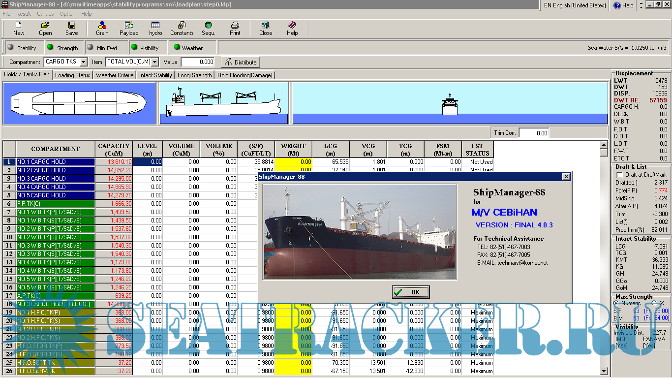

This material explain the full aspects of "SHIP MANAGER" loading programs, the major functions of which are as follows :

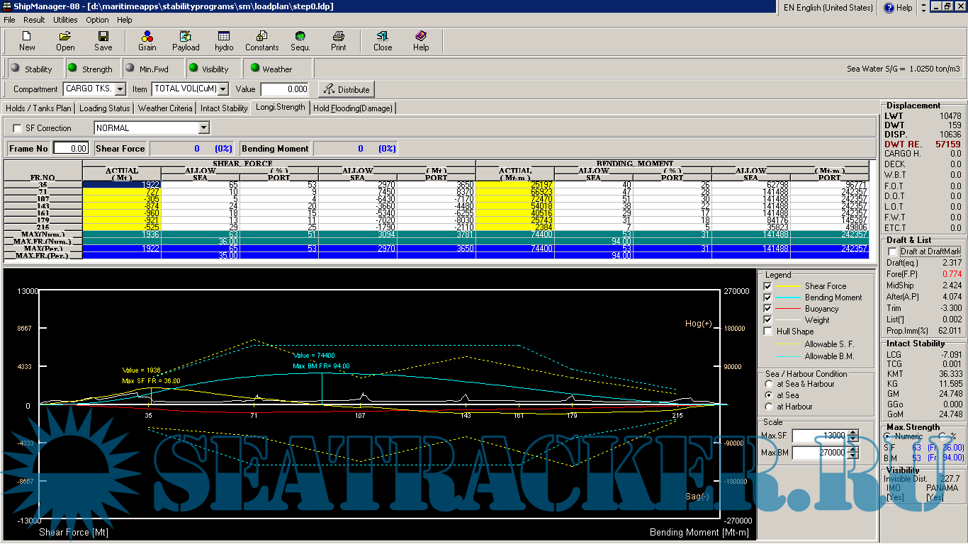

8. Shear force and bending moment at the prescribed frame points with visual.
9. Maximum values of bending moment and shear force with their actual position

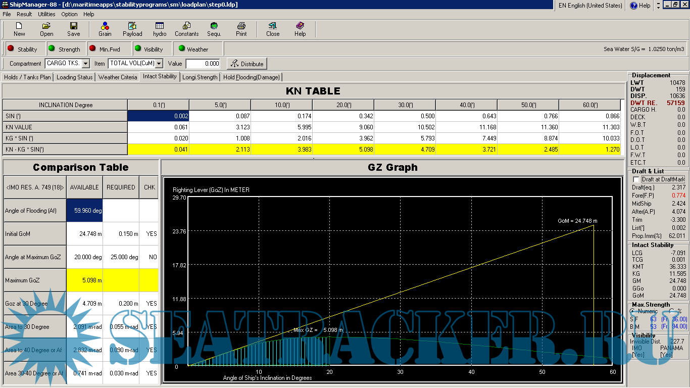

11. Static stability (KMT, KG, GGo, GoM) Calculation.

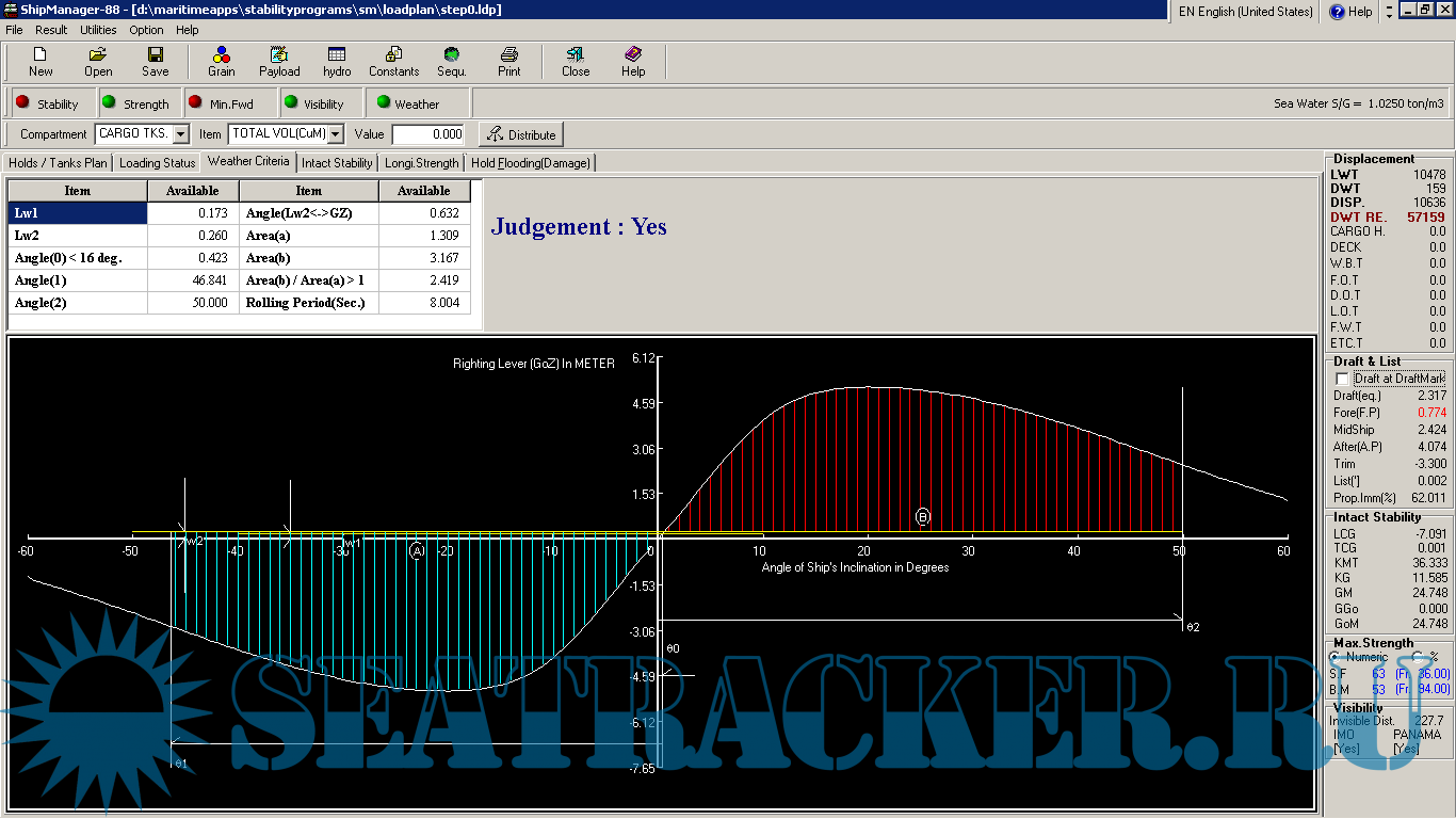

12. Intact stability calculation including GoM according to IMO A.749(18)

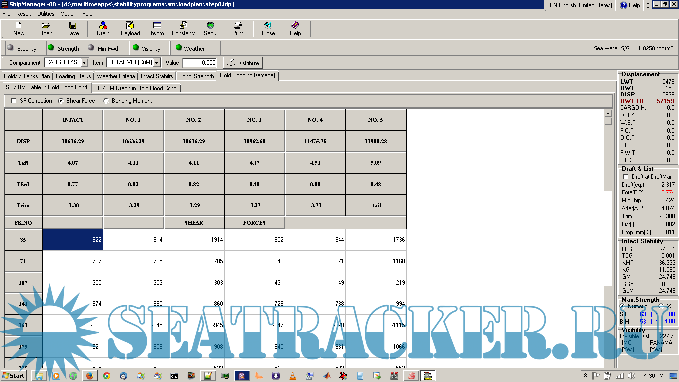

14. SWBM and SF in the hold flooded condition cargo hold acc. to IACS UR S17.

Initial stage setting

A few screenshots
