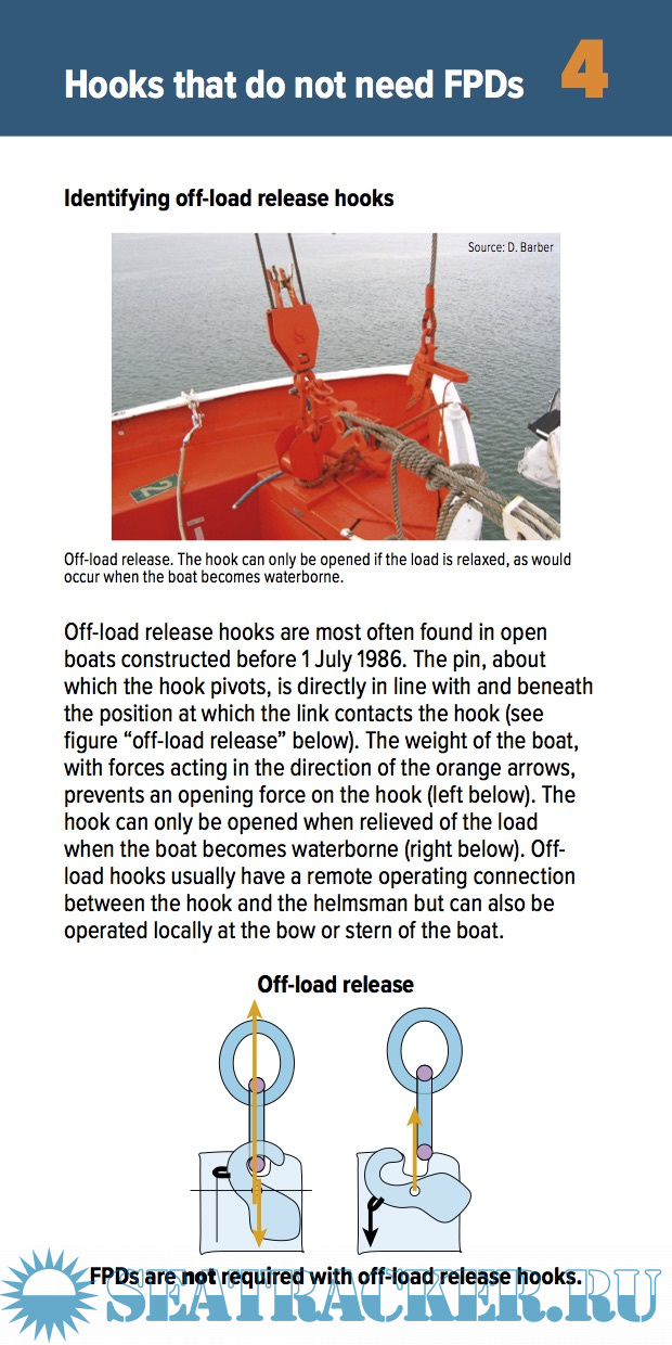

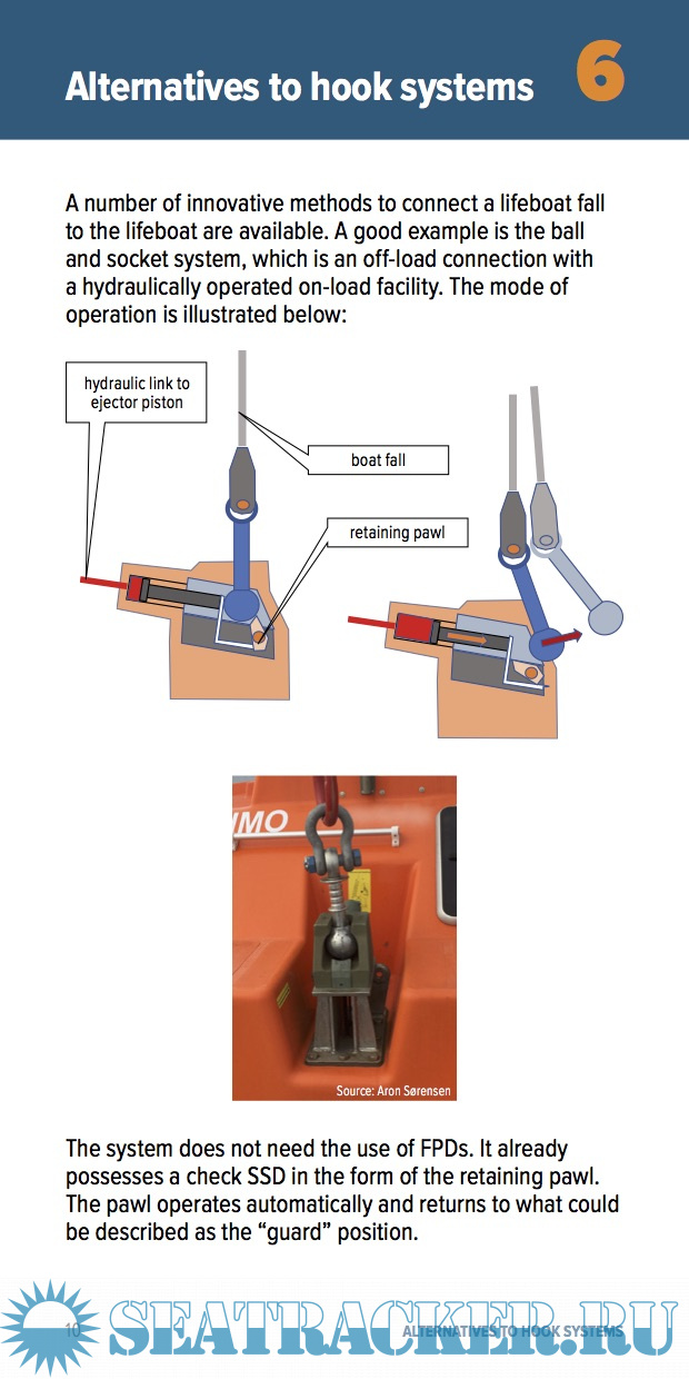

The ‘Avoid Lifeboat Accidents’ pamphlet gives clear guidance on how to prevent accidents with lifeboats and rescue boats equipped with on-load release systems. It advises whether additional precautions in the form of FPDs are appropriate, and if so, when and how to use them safely and effectively when launching and recovering the boat. Other failure devices, and new innovative hook systems are examined too.

Hooks that do not need FPDs..................................8

Alternatives to hook systems....................................10
