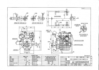

Description:This boat are designed, condtructed and equipped in accordance with "1983, 1996, 2000 and 2006 amendents to the international convention for safaty of life at sea, 1974", Lsa code "new Msc resolution 218(82), 226(82) and 272(85) to amend Msc.81(70)", "guidance for the approval and type approval of materials and equipment for marine use 1998" and also Med.
Boat type: Normal type free-fall life boat, model Jym-fn-6.65.

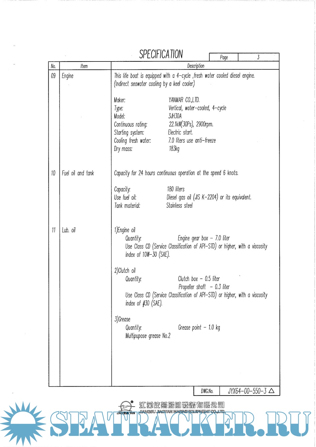

Specification.
General arrangement of free-fall life boat Jym-fn-6.65 (Normal type).
Equipment list for free-fall life boat.

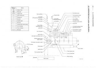

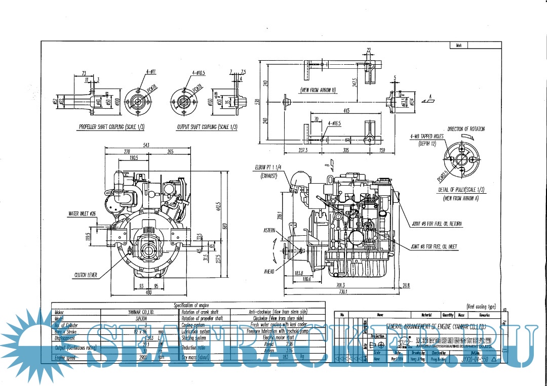

General arrangement of engine.
Spare parts for diesel engine.

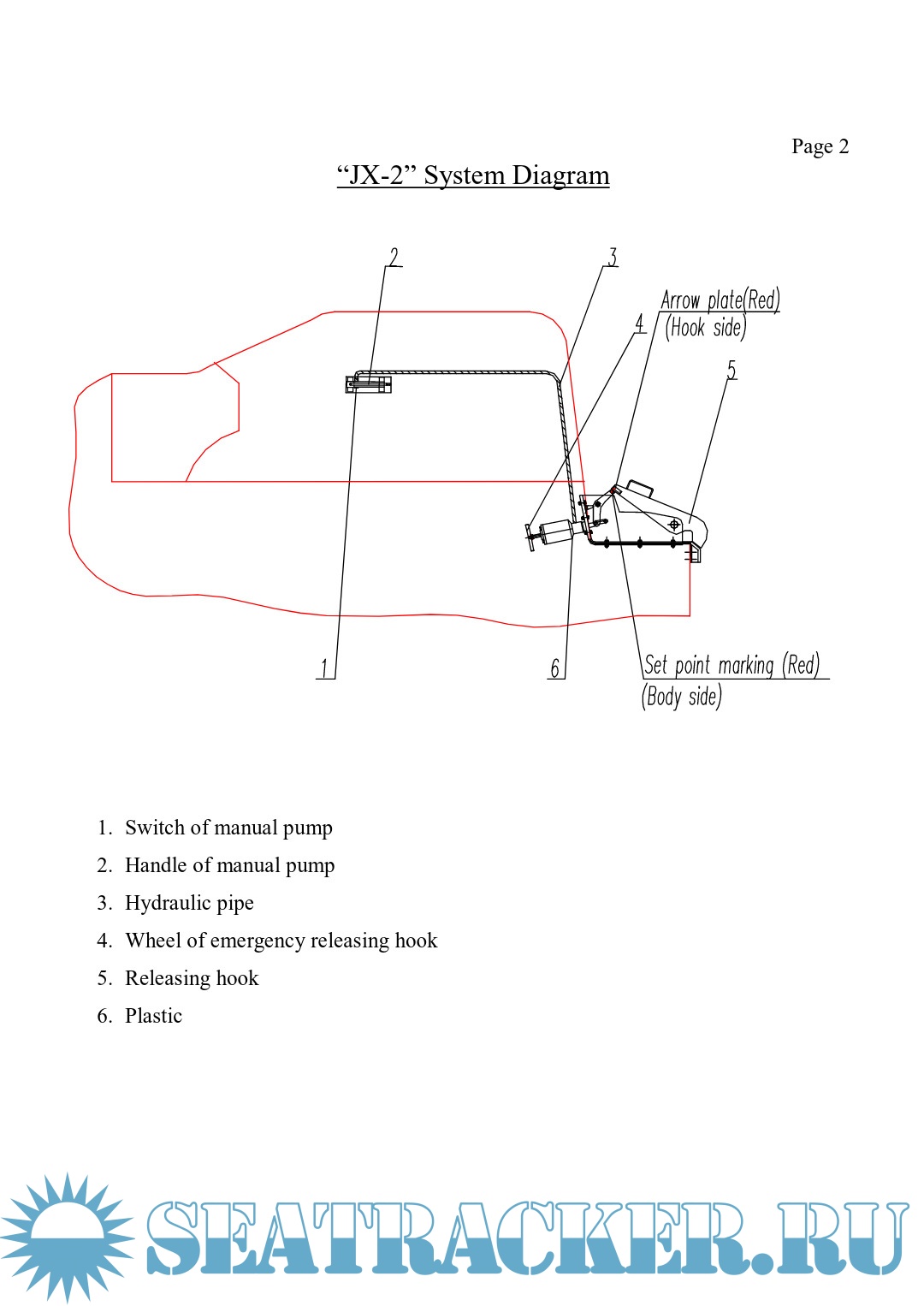

Detail of realise hook.
Arrangement of steering system.

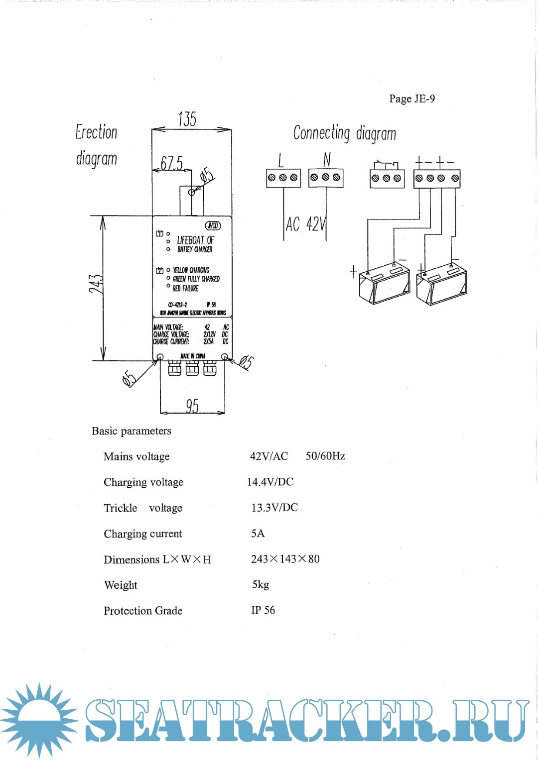

Arrangement of battery charging system.
Spare parts for electric parts.
Recommended lubrication oil, fuel and cooling water.
Freefall lifeboat operation & Maintenance manual.
Yanmar diesel engine operation manual.
Electric diagram.
Maintenance.
